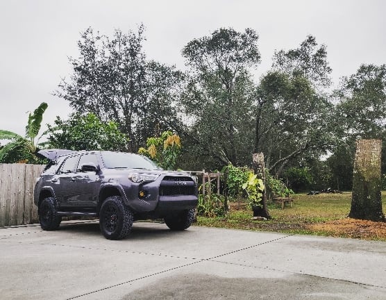

We need details, Ryan! Amount of lift, spring rate (650lb, 700lb?)? I see it's powder coated red. Mucho likey!
Those look to be the stock coils.. you can see the TRD writing.
I forgot to measure the before height for my Pro above, but it appears to be close to 1" if not slightly over. A friend used the same coils on his OffRoad and it was exactly 1".

Do the rears get rid of the driver's side lean? My 19 leaned 1/2", the 20 is 3/4". If not I'll wait for the adjustable rears, thanks

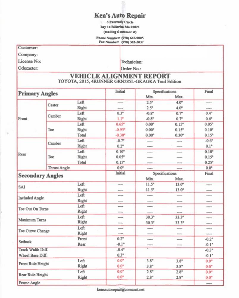

Got the spec sheet from the alignment. A little off on the camber but found out the LCA bushing on the passenger side is frozen. Go figure.
Side note: easier to replace/upgrade an entire LCA or replace just the bushing?
