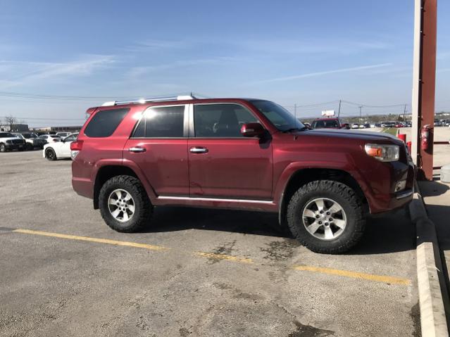

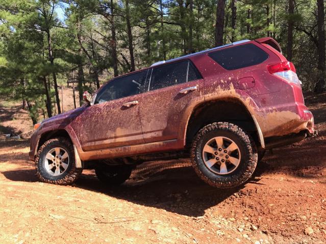

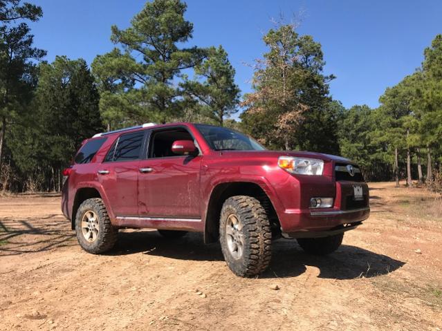

Took the Runner out to test this suspension out in Bastrop, Tx. Working great, running 285/70/17 Milestar Patagonia Mud terrains. had to do some slight trimming for rubbing in reverse.
Do you have Spidertrax? Also, can you take a picture showing the stance with the 285s? Trying to decide if I really need 285s with this setup and if the stance will look good.
No spacers at the moment. I have it in the shop getting new pads but ill shoot you a pic later tonight. I was thinking about going with 1" spacers, but it sits pretty flush with the fenders as is.
how are you liking those tires? whats the noise like and what were you using before?
Loving them so far. Handled mud like a champion, even had to rescue my buddy who was on Bfg KO2's. Only had them on since Friday, little noisy on the freeway, here in Texas that's like 70-80 mph. I was on stock 265 coopers so the ride is a bit noisier/rougher but nothing to turn me off from purchasing again.
I'm on 285's now and love it.
Thanks, I know as soon as the lift in installed I’m going to want bigger tires lol. Not really wanting to buy new wheels as I dig the TRD Pro ones, more concerned with flushness to the fender. Spidertrax do the trick for now on 265s.
