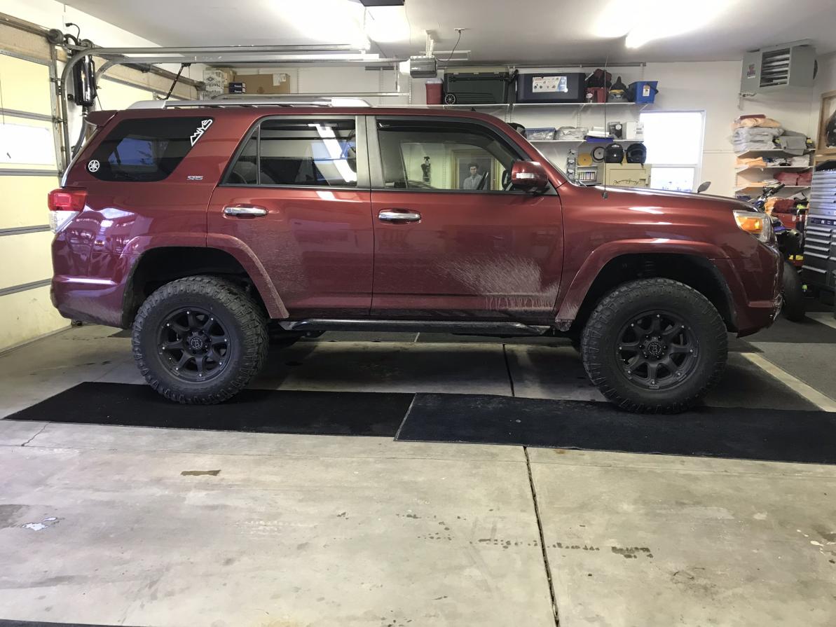

Here it is with the stock wheels, it was loaded with the new wheels in the back and at a slight incline so it looks like it was sitting lower in the back:
Here it is with new wheels:
More pictures uploaded here:

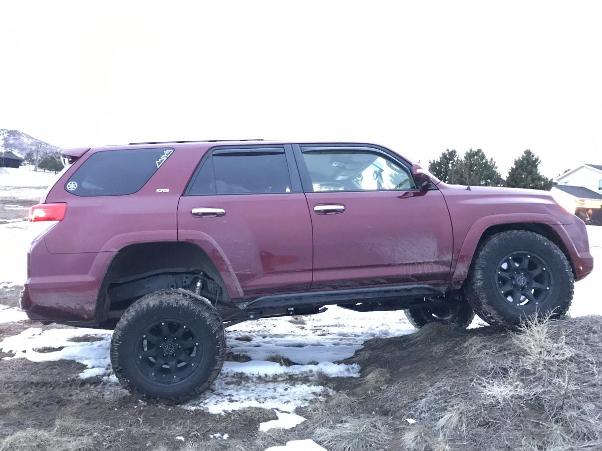

Eibach springs up front! I just installed my SPC's and got my alignment done at Toytec so I had about an hour drive there and back. I think that you would be happy with the ride bumping up a clip.. the lowest setting was still a little bit soft IMO. Lost a tiny bit of up travel but nothing major. I'll attach some pics.
Don't use the third clip up though lol. I tried it for grins and it definitely looks cool but its a rough ride and the CV's are pushed a little too far, again, IMO. If I remember correctly, it was about 24.25 inches from center hub to top fender
