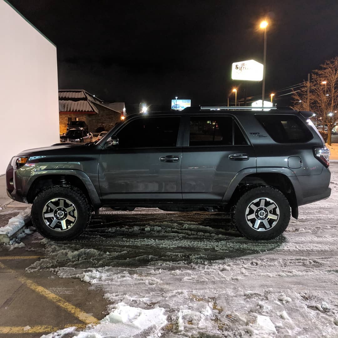

Finally installed my Eibach lift yesterday on my '18 ORP KDSS. I wanted to try to preserve a bit of rake so I modified the kit by using the Wheeler's T13 rear springs, which are made by Eibach anyway.
KDSS is definitely a pain to wrestle with, and I did end up disconnecting the system from the LCAs to get the longer coilovers in. Since I used the Eibach PT front springs (2.75") I set front perches at stock height.
I'm really happy with how it rides and looks, the nosedive is completely gone, and it totally eats uneven pavement and railroad tracks. I'm looking forward to getting it off road. Even without an alignment it tracks totally straight. We'll see if the alignment says I need UCAs but based on the ride I really doubt it...
Looks awesome!!! Did you use the rear shocks the kit came with?? I used the full pro kit and want more forward rake if possible. Waiting patiently on upcoming Eibach products or I might go similar route as yours.
Thanks! Yeah the rear shocks are the Eibach PT. I went with the T13 for that exact reason, to preserve a little bit of rake. If it ends up settling too much I'll probably add a 10mm spacer to the rear but for now I'm pleased with it.
That looks great! Really looking forward to getting this done, but I guess I worry a little about the shop doing it and working around the KDSS...
Thanks man. I'm pretty proud of getting through it myself, I'm not gonna lie. I decided to do the install myself because I live in an area that doesn't have a lot of Toyota experienced shops and I felt like I could get through it myself safely and learn something in the process. Also I saved at least $500, which is money I can put towards more mods.
Looks great Angelo. Looking to do the same thing. How did the alignment go?
Thanks, I'm really loving it. Frankly I'm not sure about the alignment yet, with the storm that just blew through here I haven't had a chance to get it done yet. As I mentioned earlier it's not pulling at all, it tracks totally straight, so I feel like I've been able to let it ride a few days longer than I might have otherwise. I will report back with results soon.
