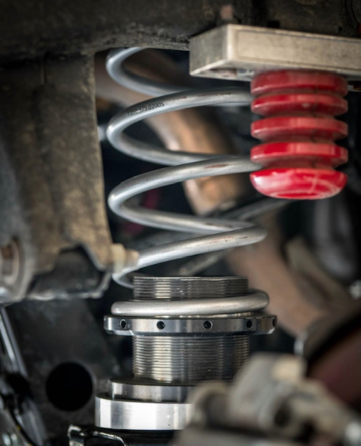

The shocks do not determine the height. The spring does. I think you are confusing the rear with a coillover, which it is not.
This pic demonstrates how the height is adjusted in the rear. You can set it at stock height up up to nearly 3". You can also carry hundreds of pounds and set the height wherever you wish.

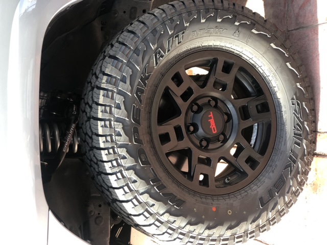

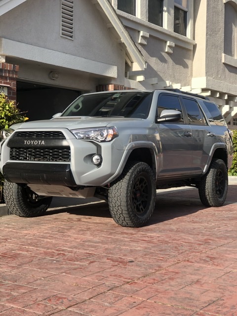

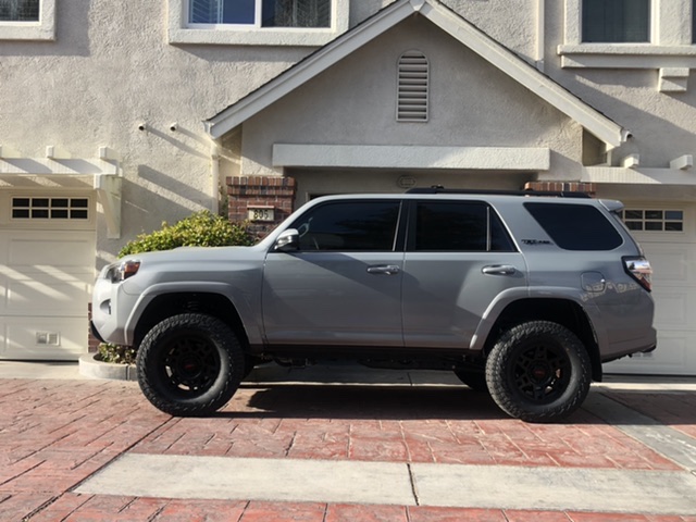

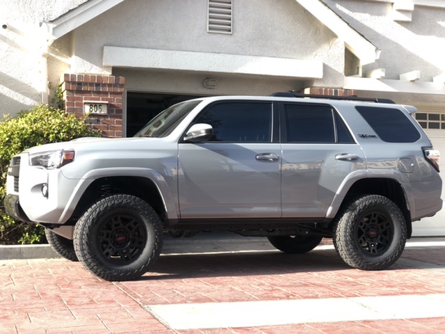

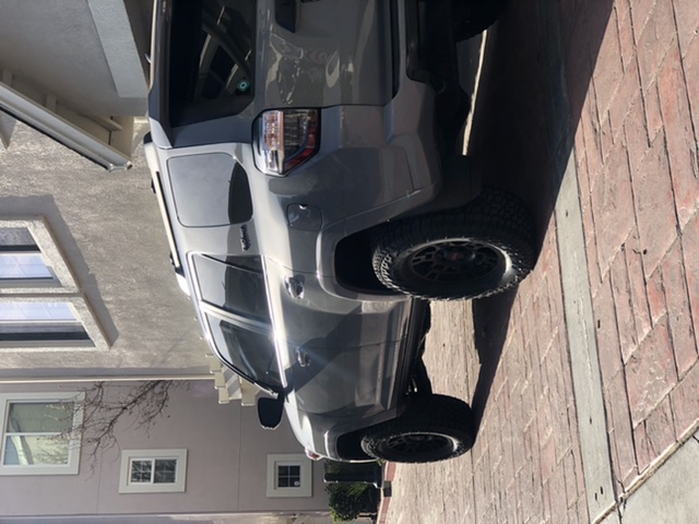

Eibach complete kit. Front set on 2nd clip and a small spacer on top of the rear providing and additional 3/4” of height. Sits exactly how I wanted in the rear. A very slight rear rake. Also running 1.25” spidertrax spacers and tires are 285/70/17 wildpeaks SL load. Also added camburg ball joint style UCA’s set at 3.5 degrees of camber. Drives like a dream. So far on the street with the wheel cranked L or R no rubbing on the body mount. Thanks Ryan for the great customer service. Sorry the pics suck

Eibach complete kit. Front set on 2nd clip and a small spacer on top of the rear providing and additional 3/4” of height. Sits exactly how I wanted in the rear. A very slight rear rake. Also running 1.25” spidertrax spacers and tires are 285/70/17 wildpeaks SL load. Also added camburg ball joint style UCA’s set at 3.5 degrees of camber. Drives like a dream. Thanks Ryan for the great customer service. Sorry the pics suck
Looks awesome! Why did you set the front to the 2nd clip?
Thank you. 2nd clip because I wanted the additional height. Albeit not much but 285’s and spacers I knew it would be tight. Plus I have 1.75” in the rear with the spacer vs. the standard 1” rear from just springs
Does it rub on the body mount? I have 1.25" spacers and 265's and it rubs like crazy. Just put in some JBA arms and it's even worse. Haven't had it aligned yet because I need to put another spacer on top of the driver's strut because with 1/4" spacer it's still 1/2" low on the drivers side. Drives awesome though. And it did rub when I had OME 883's on the front too. Not this bad though.
No rubbing. I was surprised, figured I would get some rub on the mount too. But at least on the street, wheel cranked to the max L or R she doesn't rub. Have 1/2" of clearance at full lock from tire to body mount. I'll snap some pics. Well see how she does on the trail flexed out. Not opposed to the BMC if need be. The front is just a hair under 3" of lift
