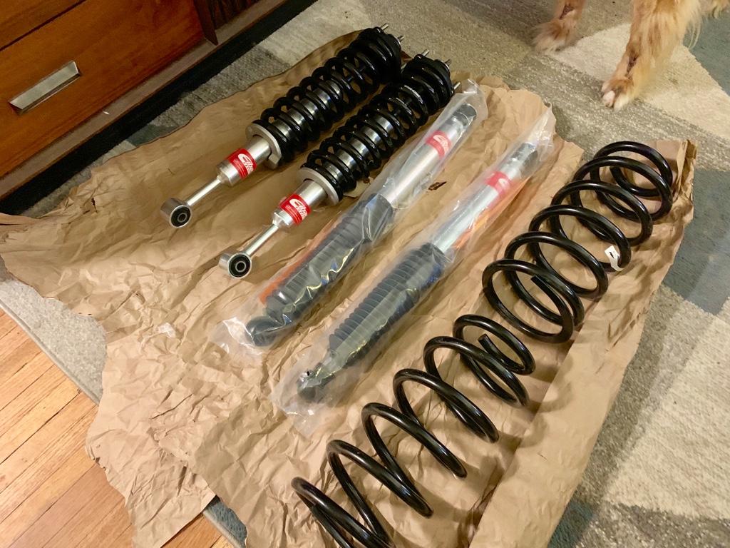

So not quite the pro kit, but mostly Eibach parts so thought I’d share! Finally pulled the trigger. Eibach Pro shocks all around, fronts assembled with Wheelers (Eibach) T1 springs, rear coils are OME 2985E. Should be good for 2.5” front and 2” rear. I tow a boat often in the summer, and was concerned with reverse rake, so I pieced together my own budget setup. I’ll follow up with pictures this weekend as some 285s are also going on.

That’s why I pieced together my kit. The OME springs should give about 2” of lift. This would leave a .5” less rake than factory with a 2.5” front lift. (I think factory rake is about 1.5”, at least on my limited). It’s not installed yet but I’ll take a picture when I’m done, I’ll also take a picture with my 3500lbs boat hitched up.
