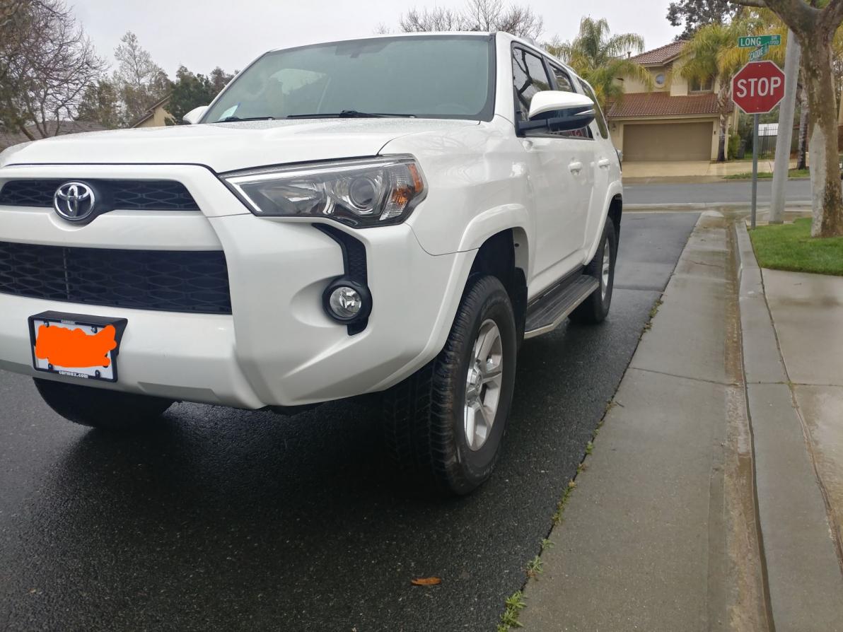

So I installed the Eibach Pro Shocks up front with factory springs set at 1.6. I installed the Eibach Pro Rear shocks AND the Eibach 1" rear springs. I went with this setup over the full Pro Lift Kit because, to me, the Pro Lift looks nose high, and also a little too high with stock size tires. This is my wifes DD and isn't going to see much offroad, but maybe 3 times a year when I take it out. The stance is perfect, with almost exactly .5" rake at the fenders! We also have the 3rd row, and the slightly increased spring rate of the Eibach's will help with that also. It rides perfect, like it should have from the factory in my opinion! Enjoy the pics!

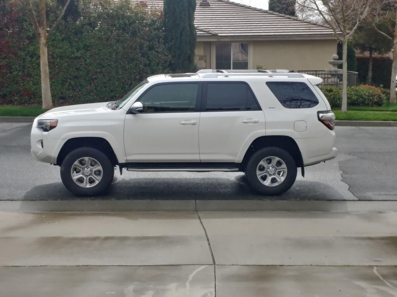

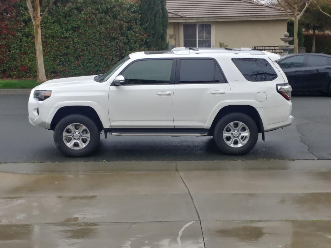

Stock pics before lift

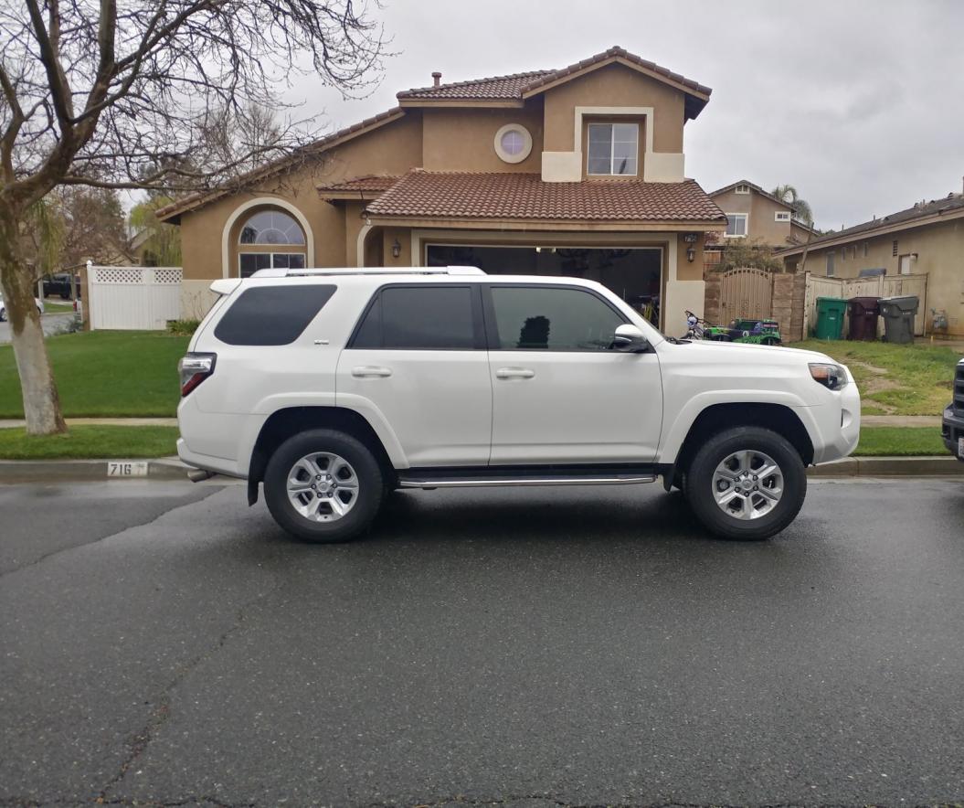

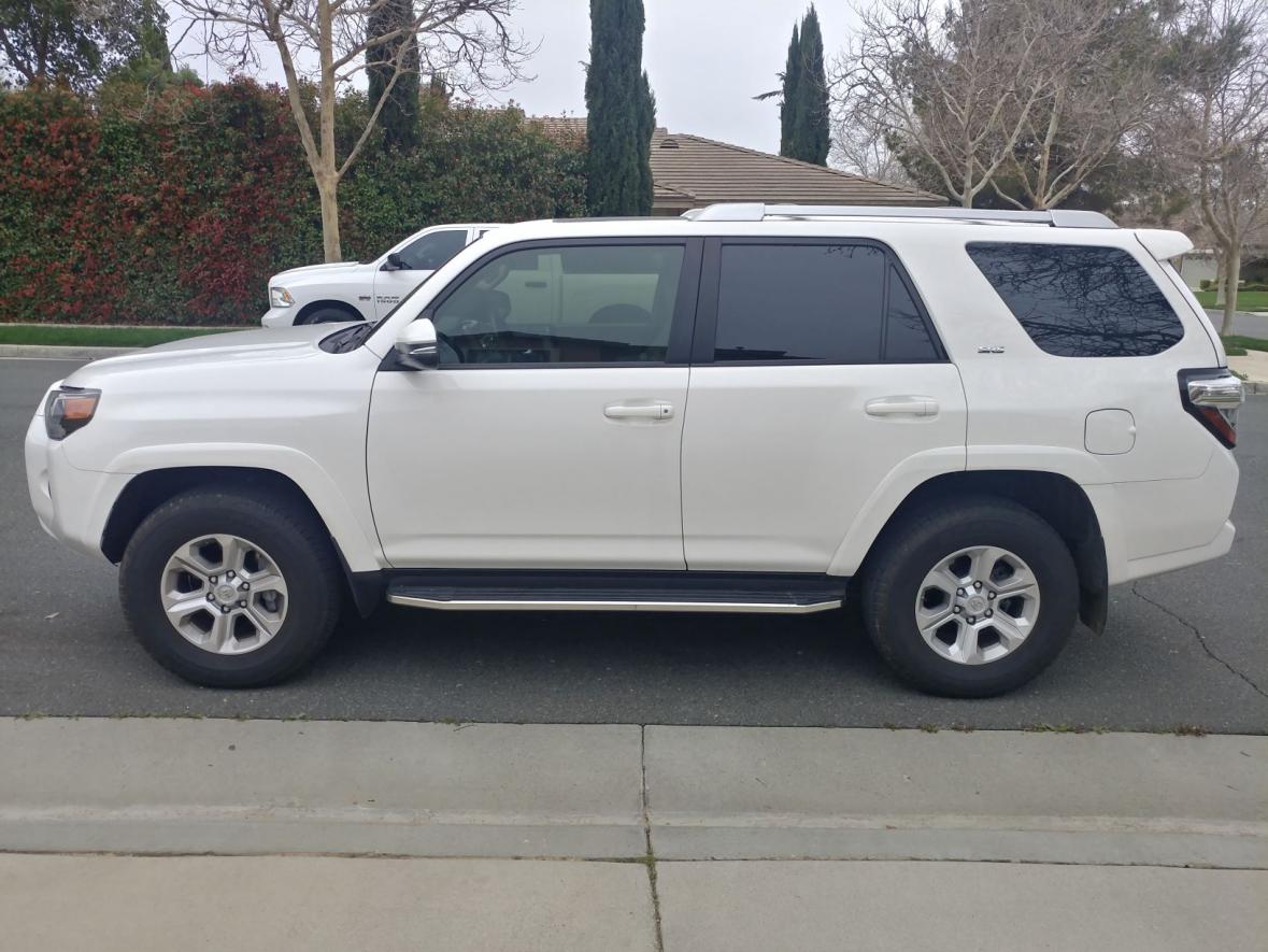

Eibach 1.75 shocks stock springs ft/rr
Eibach Pros set to 1.6 with factory springs, rear is stock. It's obviously nose high, needs to be leveled in my opinion.

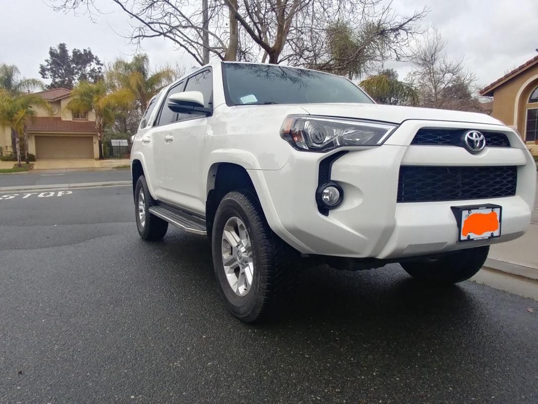

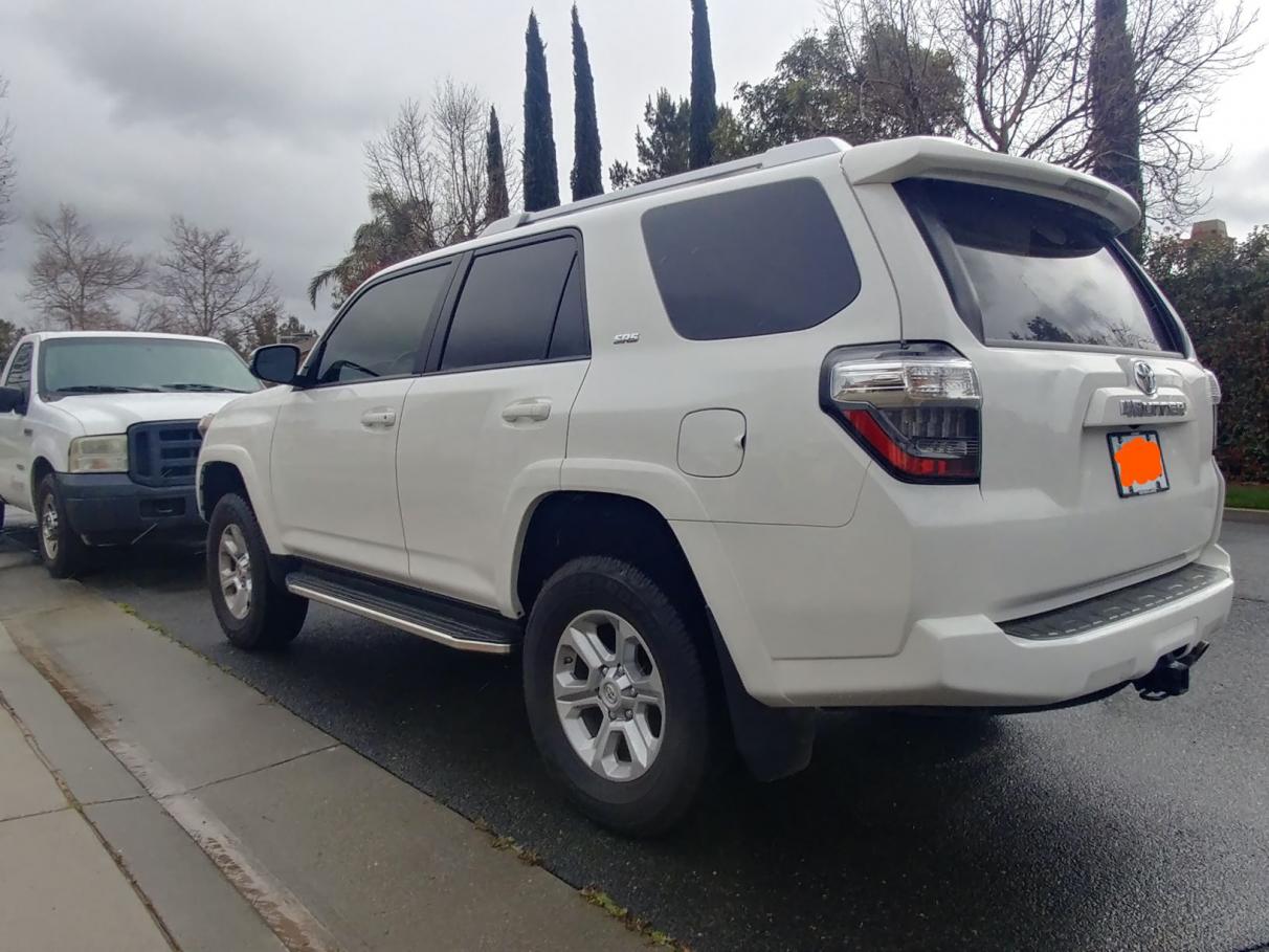

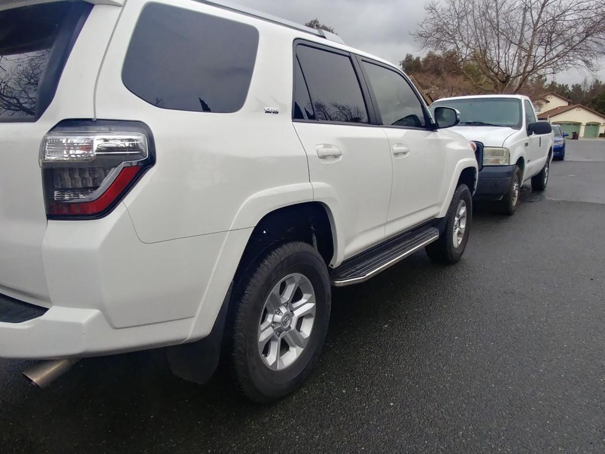

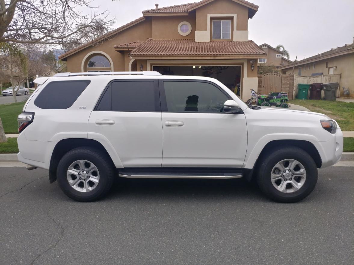

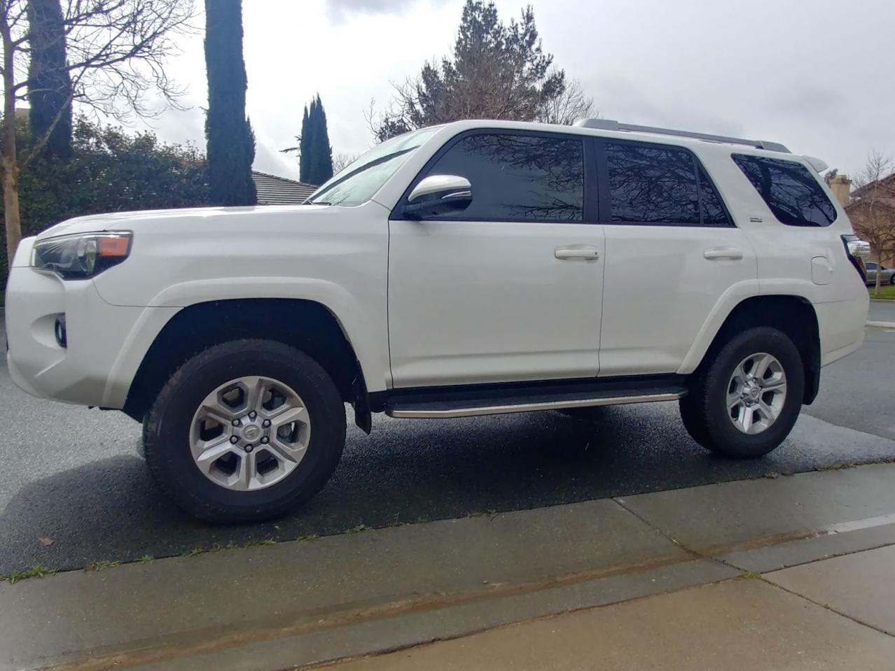

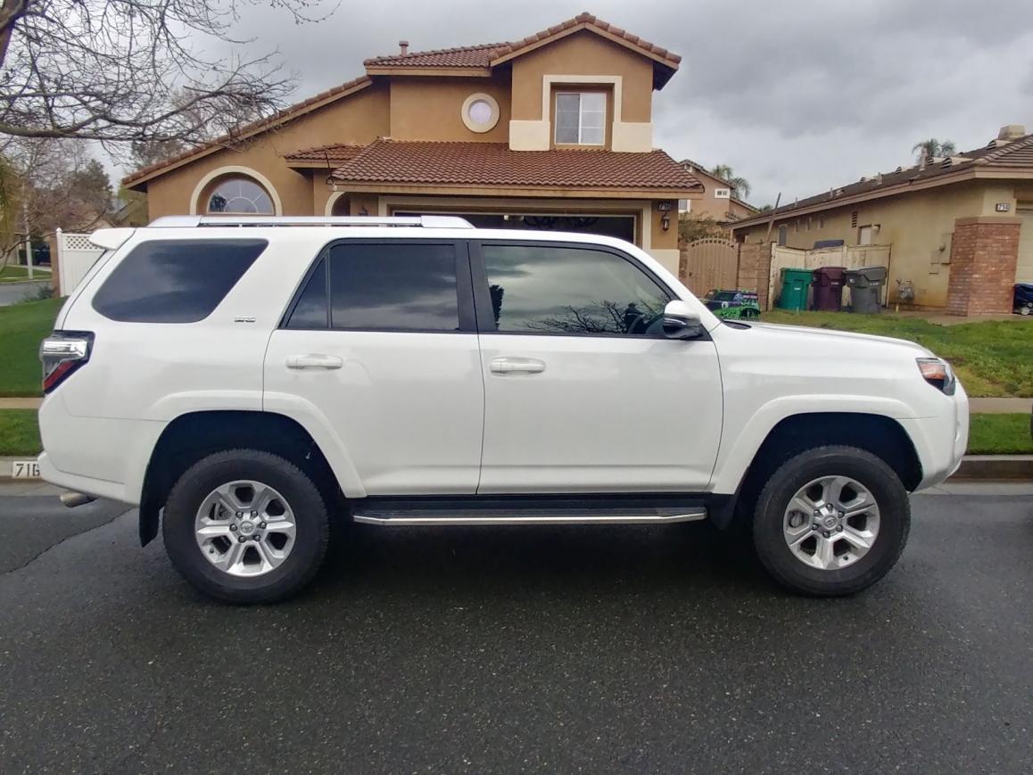

Eibach Pros Ft/Rr @1.6 with 1" Eibach Rear springs
Lift installed with Eibach Pros all around! Front springs are stock, rear springs are Eibach 1", the same ones that come with the Pro Lift. The fronts are set to 1.6 and perfectly level the truck with 1/2" rake at the fenders! Perfect stance in my opinion, and doesn't look odd with stock size tires. I'll probably keep the stock size, or go 255/75 on stock rims with a decent all terrain once these bad boys wear out.

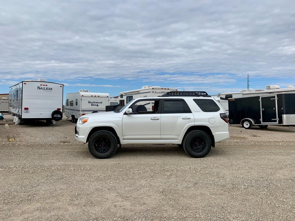

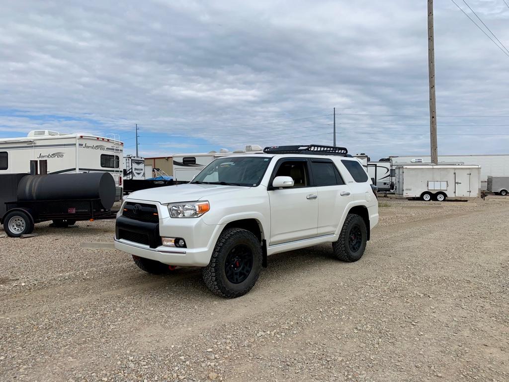

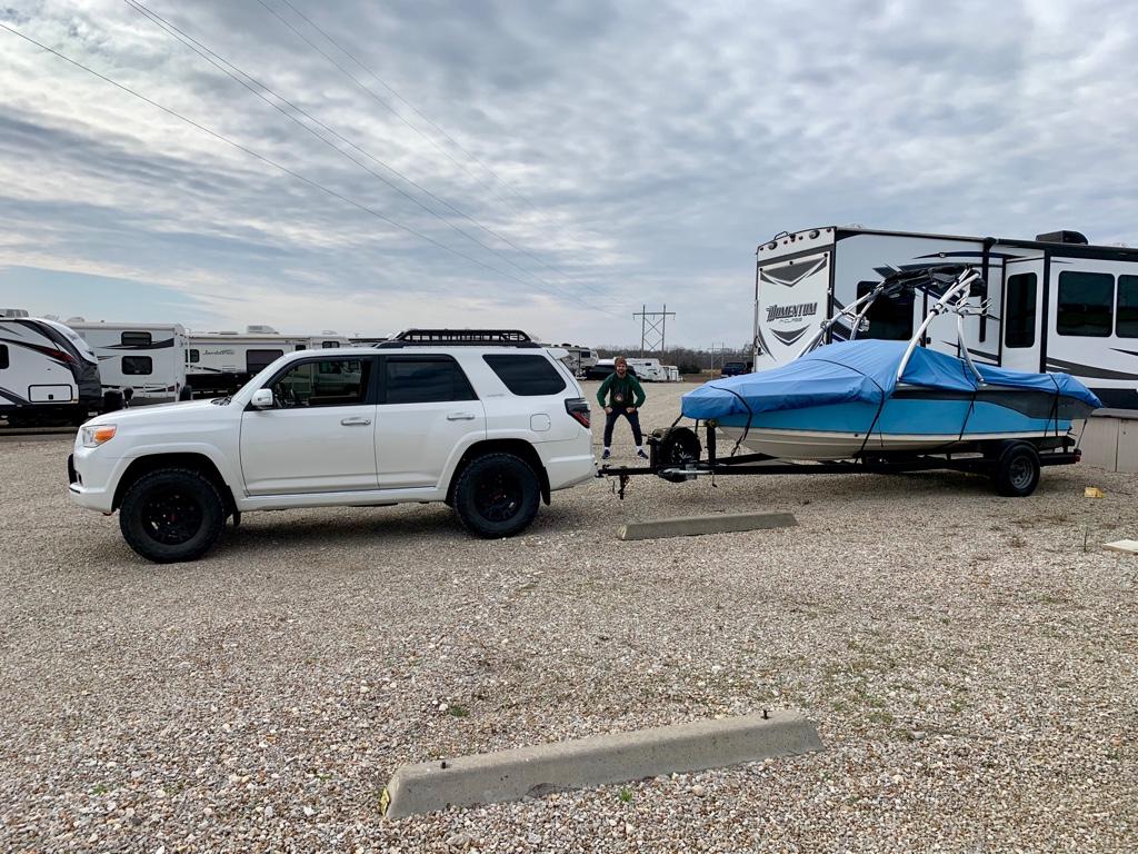

Out with the old in with the new! Finally got the lift installed. Mine isn’t the exact pro lift kit but mostly Eibach parts. Pro Shocks all around, Wheelers T1 (made by Eibach) front coils and OME rear coils. Good for 2.5” front and 2” rear. Tucked 285s (KO2s) no problem, plenty of room. With my boat hitched up I still have a slight rake which is exactly what I wanted.
Took mine off-road today. 100% pleased with the ride and performance.
My friend noticed the difference, said it felt smoother than stock. My tires were at about 32 psi.

I did the OME 2895E, I had 200 pounds of tires in the back taking these pictures.
