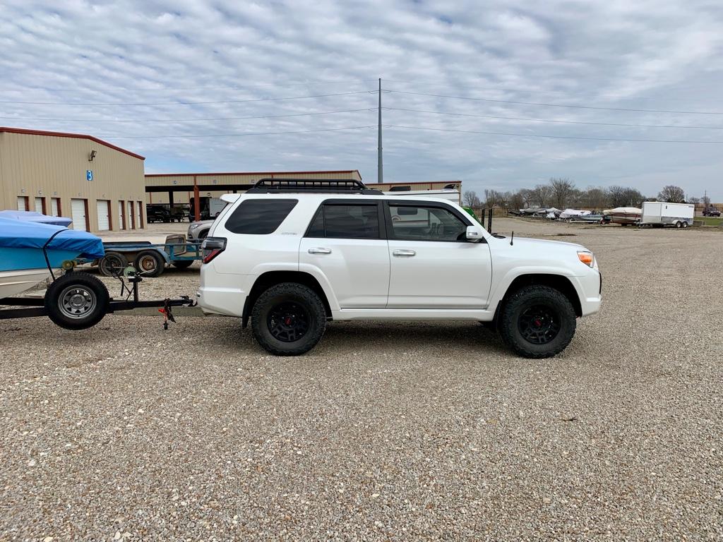

I did the OME 2895E, I had 200 pounds of tires in the back taking these pictures.

Wheelers Off-road on the coils. I think they were $180 or so for the pair. With the boat hitched and back full of gear I have no reverse rake.
