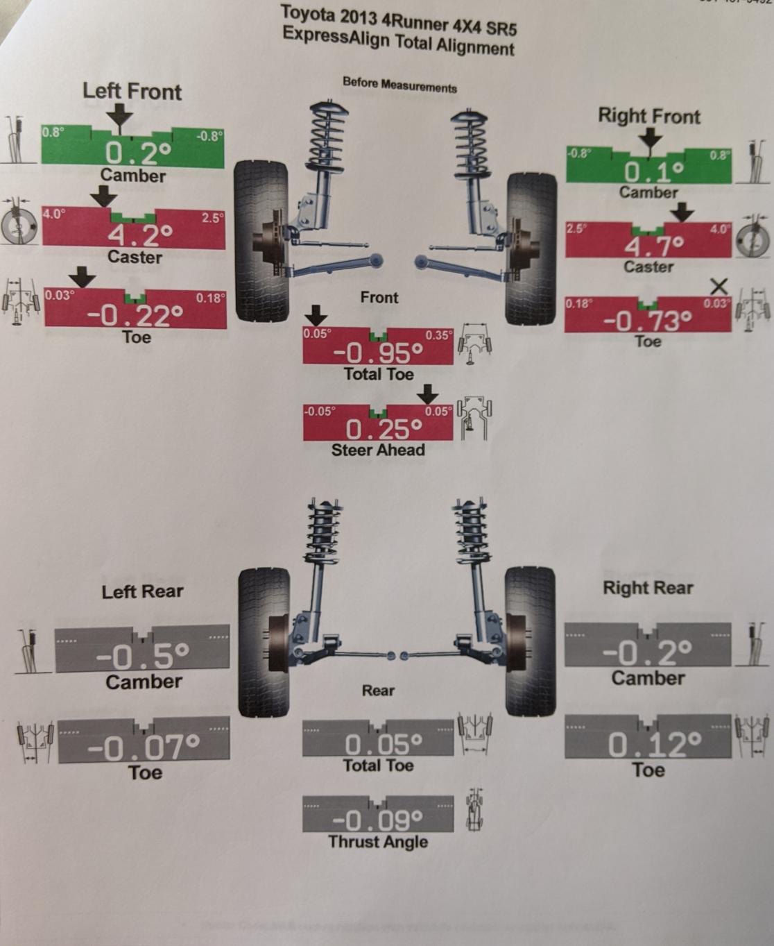

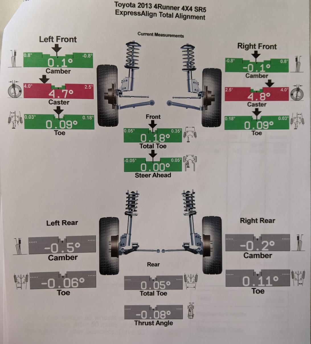

I have a 2013 4Runner SR5 Premium with a the 3rd row. New to the forum but have been lurking since I purchased the Eibach Pro-truck kit. Also installed JBA UCA as well. Do these alignment numbers look fine?
