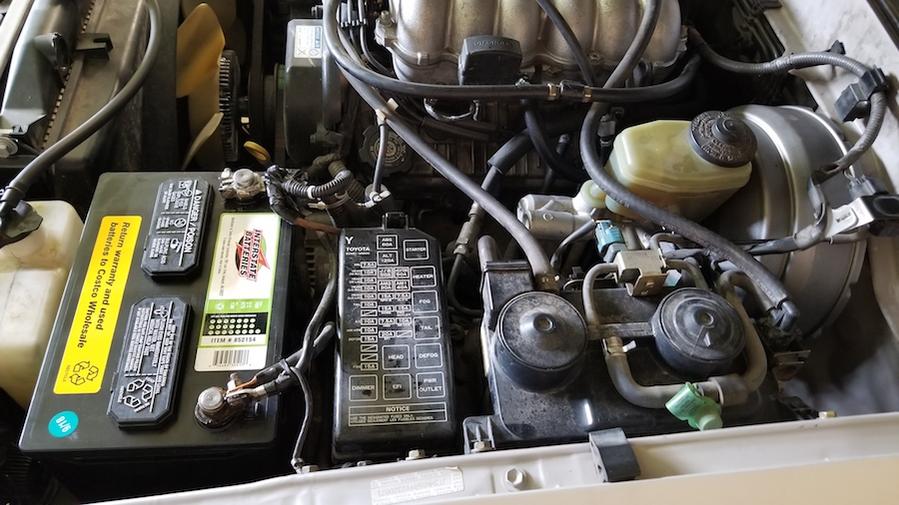

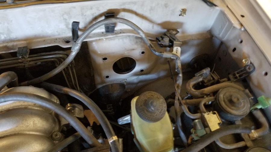

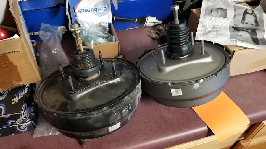

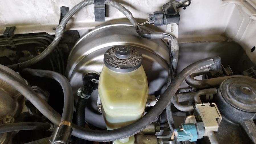

My 4Runner let me down for the first time in the last 4.5 years and 45k miles. Well, kind of. I was still able to limp home through the neighborhood streets from the grocery store. I went to back out of the parking spot and found I had no brake boost after the first pump. Boost would take a few second to build back up, so I suspected a leaky/bad booster. After doing some research, I opted to just put a new booster in given there were no vacuum leak symptoms in the system.
I couldn't justify the approximate $900 Toyota part this time. So I went with a Napa remanufactured unit for much less. Budget woes.
New booster fixed it! This job was much easier than I anticipated. The most difficult part was ensuring I took care to remove the booster with the MC hard lines all still attached to the MC. I think if I would have cracked open those lines, the job would have gotten a LOT harder. To make it work, I removed all of the brake hard line connections at the firewall as well as the ABS unit, and that gave me enough room to pull the MC back while I wiggled the booster out. Probably a 2 hour job for me, and I take my sweet time.
Also - New battery too! Terminals/poles all cleaned and freshened up with a wire brush and dielectric great. I saw while I was working in there the battery was starting to spit some kind of junk out the top and a bit of usual corrosion on the positive terminal (my 2nd terminal now), and the charge it was holding was steadily dropping the last few times I noticed when charging it. So I ran to the big C store and got my free replacement days before the warranty expired. They aren't the best batteries, but they are the best warrantied batteries if you live in a hot climate that cooks car batteries in ~2 years.
