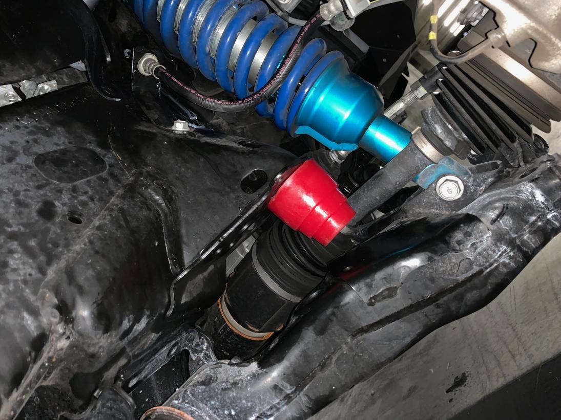

your wish is my command. Excuse all the wd40 sprayed all over the place. I used it to soak the old bump stops to get em off easier.
How tall are the OEM ones? Did you have to jack your truck up to install?
OEM is about 1 inch tall. I didn't have to jack mine up to take off old bump stops. I did have to jack my ride up to install these mainly because my allen wrench was too dang long and wouldn't clear the lower control arms. If you have the right size allen wrench I guess you wouldn't have to jack your car up.
