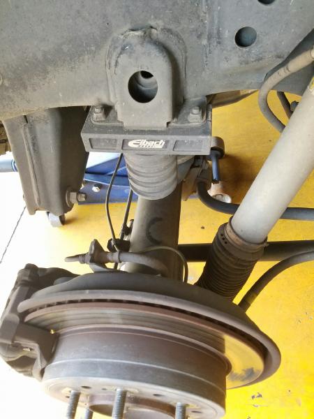

Ryan from Eibach posted their new rear adjustable springs on their Eibach suspension thread, it has pictures of their product that matches their website. It is possible they had help from ES but I will let them confirm that. The 3rd gen in the picture from BB with the demo front bump stop design looks very similar in shape to the rear bump stop Eibach sales just without the included extension plate. I don't know why I'm just now noticing that. I have the rear Eibach BS installed, they said 6 months ago they would sell it separately on their website outside of their kit.

Timbrens got too proud as well. I missed out on a rear used set for sale for $100. If I were to start over I would of gone with the oem GX rear bump stops ($100 a set) due to the square curvature for that positive contact point over the center of the axle. My rear Eibachs ($125 then) work but the round contact point only hits the front half of my axle. It might not even be that big of a deal after all, maybe it was designed that way. I would love to see pictures of the axle contact print on someone who upgraded to the taller stock GX bumps stops to confirm my rambling.
