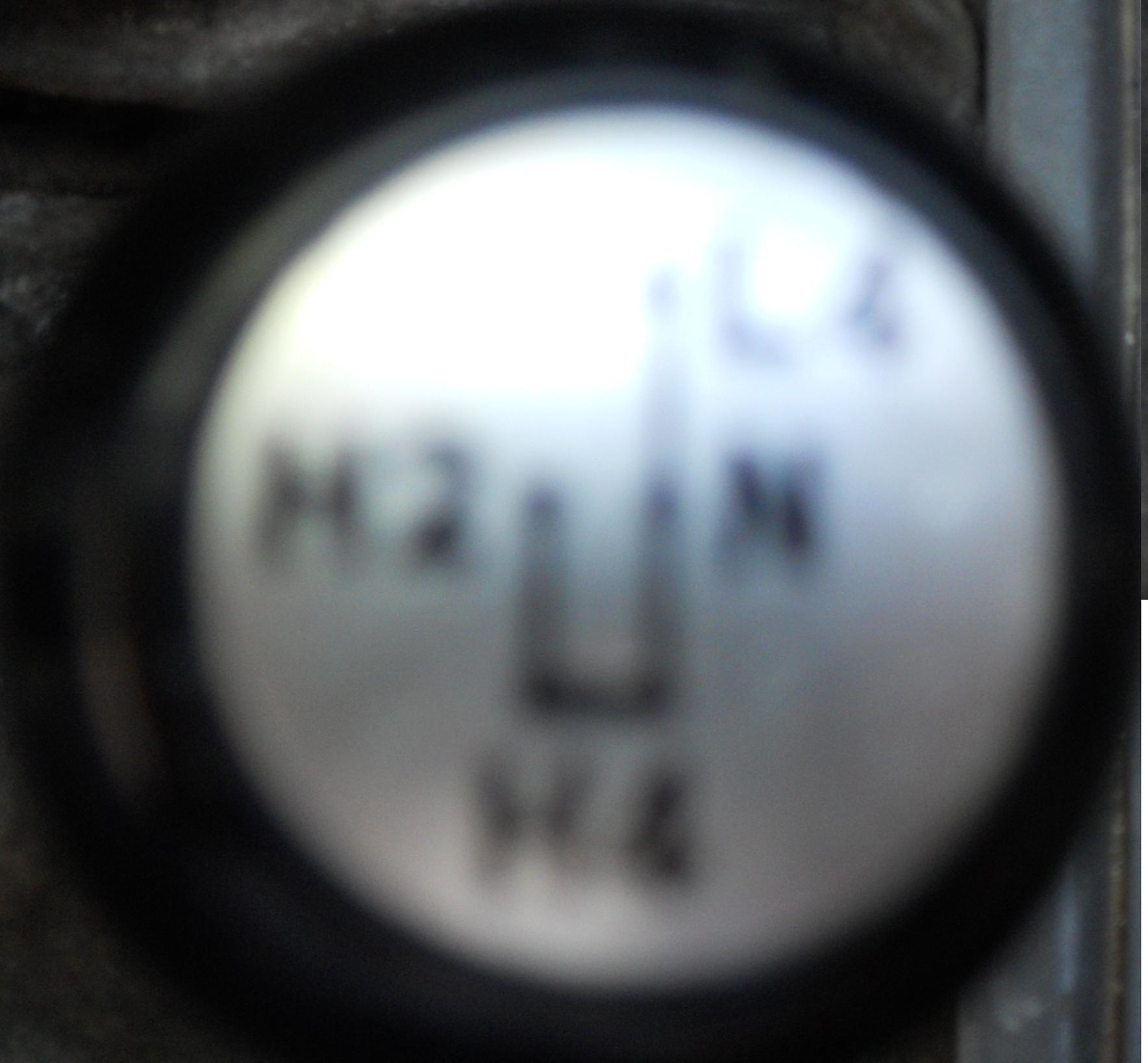

Well when the guy did it he didn't even move it, the thing is what I mean is this. If you look at a Jeep Wrangler or something, the 2H 4H and 4L go in a straight line, forward and back movement, but the 4runner has like side-forward/side-backward movements and I just can't figure out the trick to putting it back on 2H.
That's the diagram on the stick for the 4WD...

Sorry man, mine just goes in and out whenever I shift the little shifter. No tricks to it really. It will engage/disengage without moving an inch sometimes. Other times I have to move it maybe a foot before it clicks in or out.
When your in 4HI, you should just push it straight up to get to 2HI. The mini shifter should move maybe 2 inches and clunk into place.

Well theres yer problem, your gear selector is all fuzzy and out of focus, no wonder you cant figure it out!!! Just kidding man, If your having trouble getting your transfer case OUT of four wheel drive it is because your binding somewhere, usually its in the auto hubs, which is not a strange problem for 4r. (which is why our bros here are telling you to drive forward and back).
jack the front end up and rotate your front wheels (when this problem is occurring) If your drive shaft turns.... Your hubs are binding. If the front wheels spin free but the stick still wont go to 2wd your problem is in your shift linkage (if your lucky) or your transfer case.
