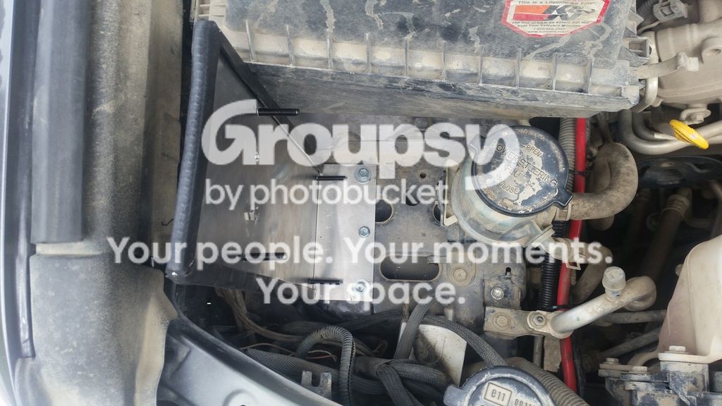

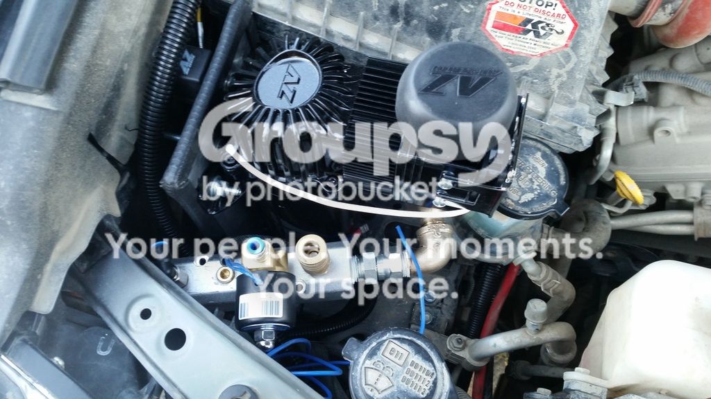

Piece of white plastic cutting board (thanks [MENTION=65614]Antman[/MENTION]), aluminium flat bar that they sell in bulk at homedespot/lowes, nut certs.
IIRC, they are M6x1 or M8x1.25
How did you bend the flat bar?
With my scrawny, delicate, office worker hands. I think I put it in a vice to get a nice straight bend.
Cuts real easy with a body saw, angle grinder, big snips, whatever, drills easily, very easy to work with.
