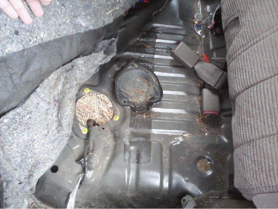

Isn't there an access panel in the floor to change the pump?
If so where is it? I haven't looked yet.

In my first car, a Bronco ii, my fuel pump had hard starts. The remedy: a new fuel pump. I cut an access panel to pull the pump out of tank. I don't think the 4runner has one either. Given how close the tank is to the undercarriage, I would probably drop the tank when on empty.

Not sure if its to the fuel pump but there is an access point to the fuel tank under the drivers side rear seat. It's under the carpet and it's a black cover with a few wires going under it...:shrug:

Gerdo, I didn't see an access panel but there was a hole visible. I have a runner now with the gas tank removed. I'll take a pic of what it looks like under there and edit this post.
Edit**** I have a pic of the inspection panel removed from under the 2nd row seat on the driverside. I assume the fuel pump is directly below this but doubt it would be easily worked on from this location. However, I'm sure you could atleast disconnect your electrical connections and fuel lines before dropping the tank.
I need to dig into mine. I'm sure the pump won't come out that hole but should allow the disconnecting easier than I was thinking.
