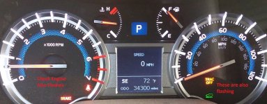

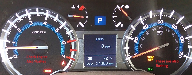

I have a 2016 4Runner TRD PRO and when I started it today I immediately noticed a rough idle followed by the dashboard showing:
  • Check Engine light flashing
  • TRAC OFF light flashing
  • Multi-Terrain Select light flashing
ODB shows codes:

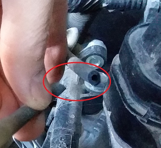

When I opened the hood there was a little sign of grassy material, nothing at all like a nest, but I'm pretty sure a rat / mouse did some damage. See the attached pics where there is some chewed tubing.
What is this chewed tubing for? Can I temporarily duct tape it back together? :)
I'm not a mechanic so have an appointment at a shop on Wednesday. But anything else I can troubleshoot before then? I'll take a closer look at the engine bay tomorrow to see if there is any other evidence of damage.

Looks like the vacuum hose to the fuel pressure regulator. Take the old hose off & replace it clear the codes. if you don’t have a way to clear codes auto zone can do it and you can get the hose there also
Thank you!
Hoping this is the only fix that is needed.
I didn't find the broken tubing until after I drove it about 8 miles -- it drove fine, just sluggish. Anyone know if it is damaging to drive it another 5 miles to AutoZone to get some new tubing?
Would taping it together before driving there help at all? I guess that line is normally pressurized? No fuel at all is coming out of it.
Do you not have a friend or coworker that can take you?
Taping it together should work assuming you're using decently strong tape. There isn't a ton of vacuum. Tape it together and see how it runs. If it runs smoothly, then go to the auto parts store.
I'd cut a small piece of the line so that when you go to the auto store, they can get you the correct inner diameter line. Make sure to measure the full length of line you need.
Don't worry, this isn't rocket science. You're truck in running like crap and throwing codes because it has a major vacuum leak and the fuel pressure regulator isn't getting the vacuum it needs to work correctly. I wouldn't drive until it's temporarily fixed with tape or a new line.

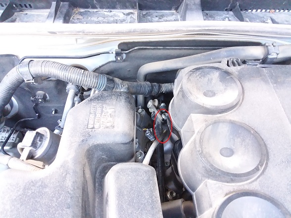

I took another look under the hood and the wires that connect to (the coil pack on?) cylinder 3 are chewed off. I don't see other damage besides the chewed vacuum line.
Ya, I'll get a ride over to AutoZone to get some supplies to replace or at least patch the vacuum line. I'm taking it to a shop tomorrow in case there are additional problems.

Found it! I got Tree Ratted.... The connector over cylinder 3 was bitten thru and wire harness was sitting in place so it looked good until i touched it.
