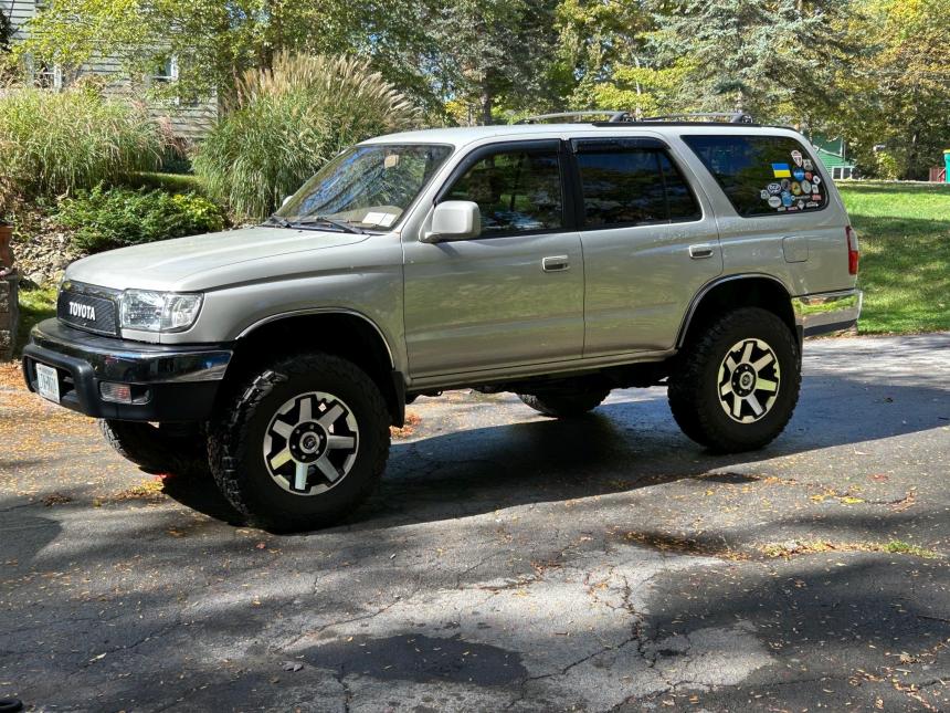

So far our $3400 "GEARHEAD" reman is running well. Well for 185hp/215 ft lbs that is.
Great oil pressure. ( almost too much!) No leaks. All good.
Would i pay $5500 for a 185 hp 5VZ from YOTA1. No friggin' way.
My 13 Highlander has some scoot. I may have done an LS or more likely a Cumming RS2.8 swap into the 4 runner if i wanted to spend 5K plus. 181 hp is hard to adjust to for a old man that drag races. Either one would be + 200% more ft lbs. Forget about HP, its FT LBS we need.
Yet the TacoYota ( Mexican) rebuild from GEARHEAD is running flawlessly. Coming up on 1000 miles and ready to switch to 100% synthetic 5-30. Will she run good for years??? Donnow yet, but i can recommend them.
Even though i may have to put a BLOWER ( TRD) on this 5VZ before it sees 7000' altitudes again. :D old farts dig TORQUE.
