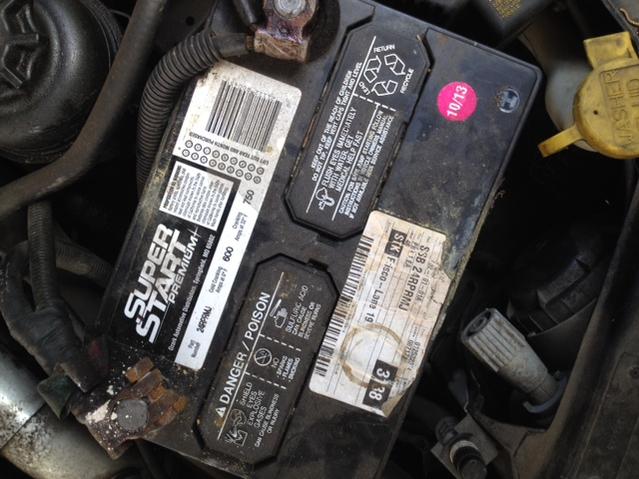

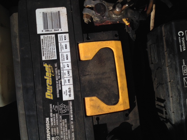

I have included some pics of the batteries. The duralast is from the SAAB and is now in the 4runner. The other battery was in the 4runner and had been sitting for a very long time and is pretty much toast I am guessing.

I'd say your battery terminals need some serious cleaning and TLC as well. Rust there will cause some serious issues.

Cleaned the battery terminals and connectors as best I could w/o solvents and then applied a thin layer of dielectric grease then clamped it down.
Still no success. :dammit:
