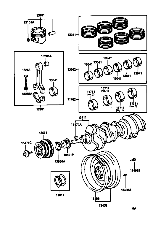

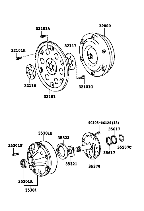

Isn't that just the flywheel?
Torque converter looks like a Bundt Cake.
Hey, I said I know nothing about slushboxes. For some reason, I thought the flywheel was built into to the TC. On a 5-speed, it for sure is the flywheel. I've never even seen a TC.
I assumed he was looking at what is in the top half of the first image below, which is the ring gear bolted to the TC. But you are right, the flywheel is just like a 5-speed, as shown in at the bottom of the second image. I shouldn't even be looking at these evil images.
It's close, but not exactly the same thing. The flywheel provides both a friction surface for the clutch, and acts as rotating mass to make shifts smoother. On an automatic it's not really a flywheel, but a flex plate. It's much thinner and doesn't have any real mass at all because the torque converter has plenty.
