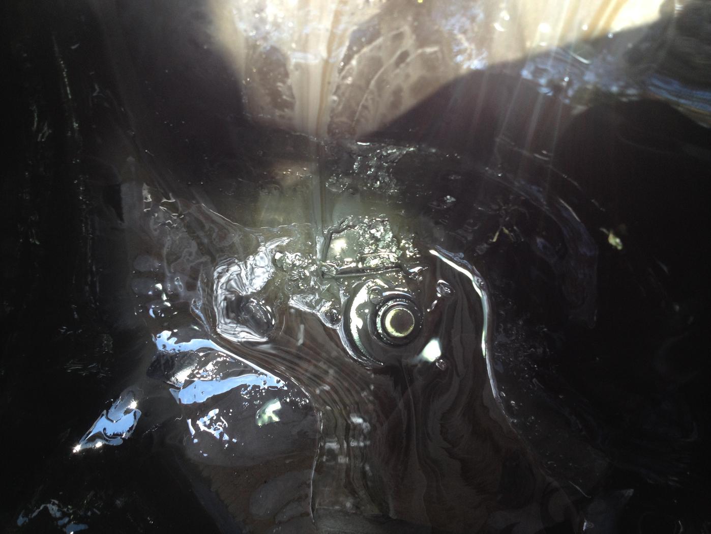

I found treasure in my oil pan! :d
I found some interesting things in my oil pan. It looks like I have some aluminum shavings as well as an extremely fine metal oil sludge as I expected. What I didn't expect was the enormous metal piece that I found! I wonder where it came from in my engine. It looks like a piece of a bearing perhaps. I am going to clean up the shavings and post another pic.
My plan now is to keep on keepin' on with my plans to try my band-aid job. It's only going to cost a couple hundo and a little of my time. So I am going to keep posting pics and what not and let people know how long it takes before it breaks down again if I can get it to run. This should be a fun journey. Once it breaks down again, I will just sell it for scraps to an eager beaver from Canada as suggested previously in this thread as I agree that it would be unconscionable to sell my car to anyone expecting a functioning daily-driver.
That being said, if anyone reads this thread and is interested in buying my truck let me know. Everyone else, post suggestions and keep posted to find out what happens next.
Post up some pics. You never know maybe someone will toss you some coin.
