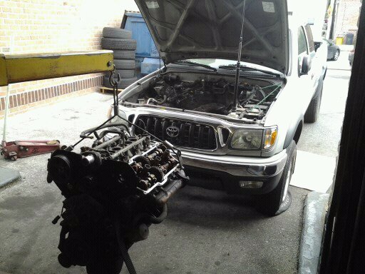

Same thing happened to the PO of my 04 tacoma. He had a oil leak (which turned out to just be a loose oil filter) but he never had it checked and just kept adding oil, bed was full of empty oil containers. He ran it low causing internal engine damage. He had it towed into my work and when we gave him the estimate for a engine replacement he declined the repairs. He stated that he would sell it to a local pick-n-pull junkyard so i purchased it instead. I found a 69k mile 3.4L on ebay out of a totaled 03 tacoma prerunner. I replaced all the maintance items and installed it. It's been about 2 years now and i love this truck. Don't be scared of a used engine just verify the mileage. I did a carfax on the donor truck's vin and the last recorded mileage matched when it was totaled. I've done many upgrades to it since i got it up and running, it's been a fun project.

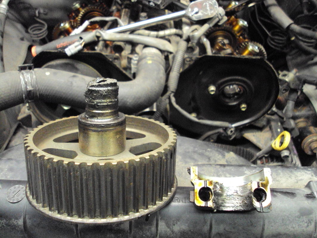

That first photo, is an absolute PERFECT example of what I was talking about. Thanks for that!
This is AWESOME! Great job!
