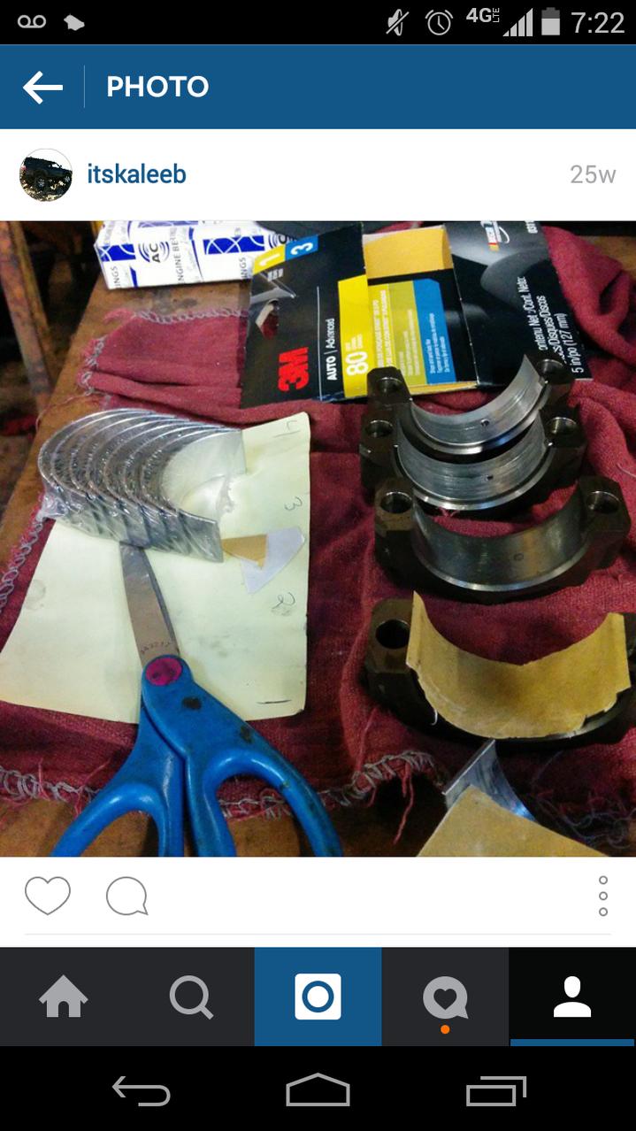

Some months ago, we had a forklift which burnt all its oil, jacked up the rod and main bearings. They wanted us to just clean it and throw new bearings in. So we did. My coworker got the bright idea to use sandpaper on the cap and bump the starter to "resurface" the crank. And it lasted another 4 hours and then seized. Lots of money wasted. Though I wish you luck.
Bearings can be replaced, with the engine in place. But, it is critical to measure all clearances and install the proper bearings to maintain the correct clearance. If the bearing journals are scored, the crank will need to come out to either fix it or replace it.
Putting it back together with improper clearances, or scored journals, is just a waste of time and money.
