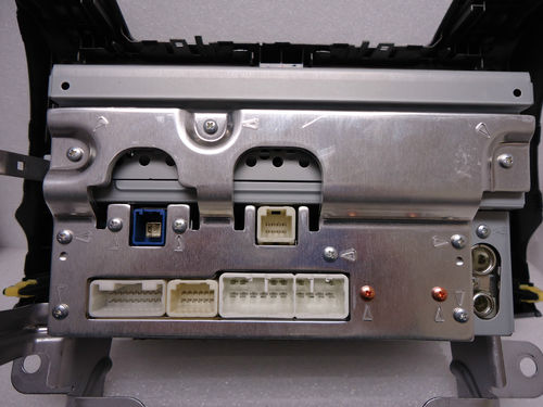

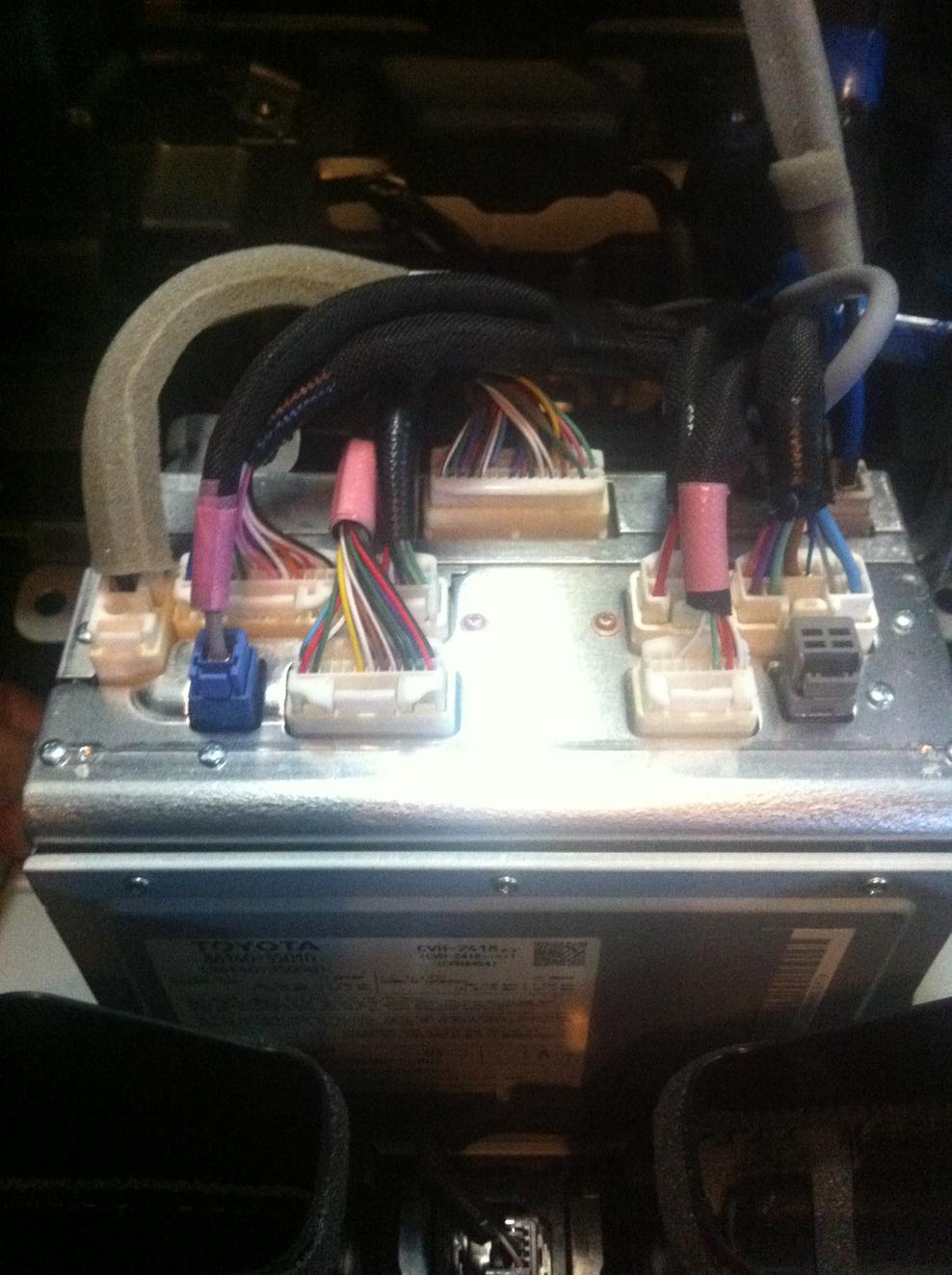

There's no extra harnesses in my non-entune vehicle.
Here's the back of the factory regular radio and the entune radio. The one with no wires is the factory regular radio. The one with wire harnesses shown is the entune unit.
The Entune unit looks to have quite a few more wires.
*I pulled these pics from other threads and ASSUME them to be correct.
Well that's not a good sign...
