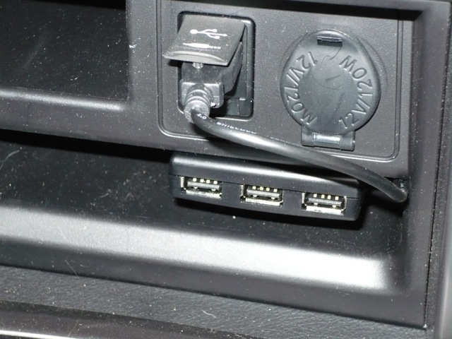

I agree! I installed a 3 port USB hub. Entune recognizes two USB sources, so I can have my wifes’ iPod and mine both plugged in and select either with just a touch of the screen.
