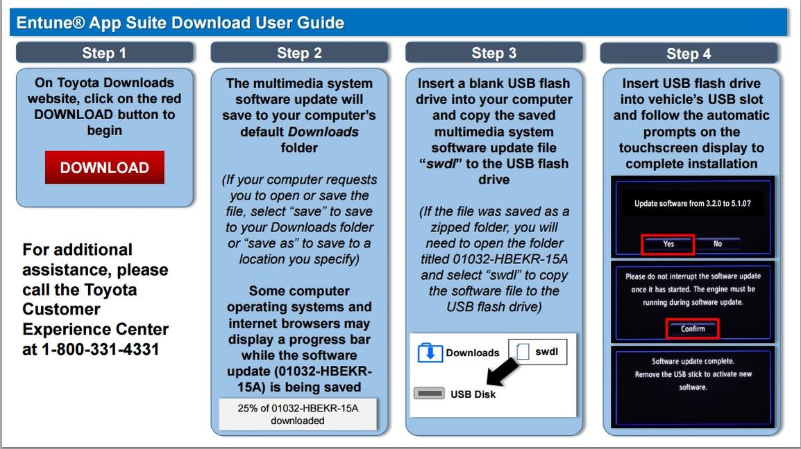

here is a direct link for the file you will need (if you don't want to use your data on your phone) - I'll leave it up for awhile - https://dl.dropboxusercontent.com/u/2191949/swdl.iso
Just put it on a fresh USB Fat32 formatted. I think some people were having a problem because the file at the original link has to be unzipped. If copied from zipped it is 275MB if unzipped it is 312MB.
Instructions - https://securedp.toyota.com/static/toyota/pdf/SoftwareDownloadPortalQuickStartGuide.pdf
Direct link page - https://securedp.toyota.com/download-app/toyotaHeadUnits
