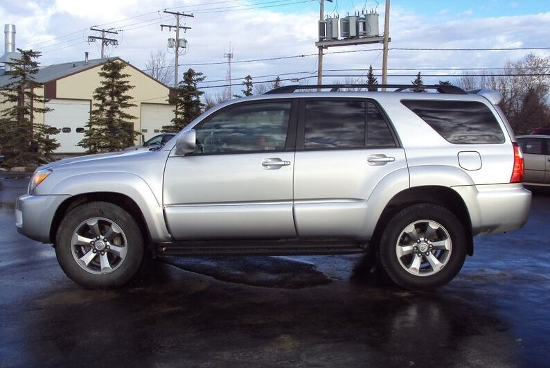

The day I picked it up at a small town Chev dealership.

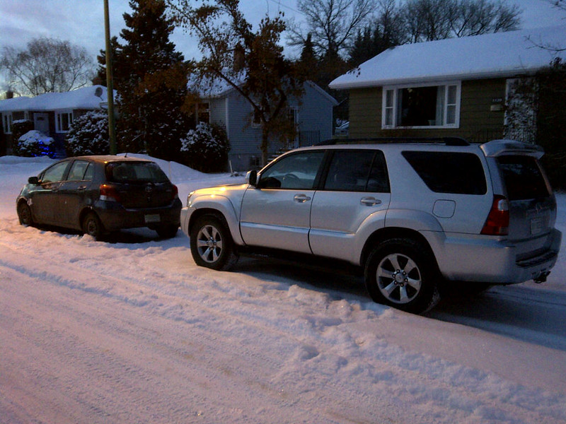

Parked behind my wife's Yaris.

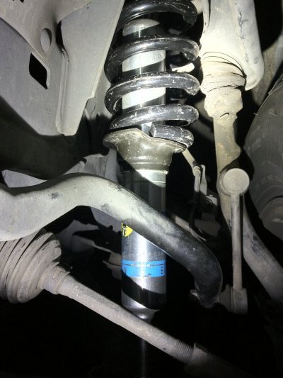

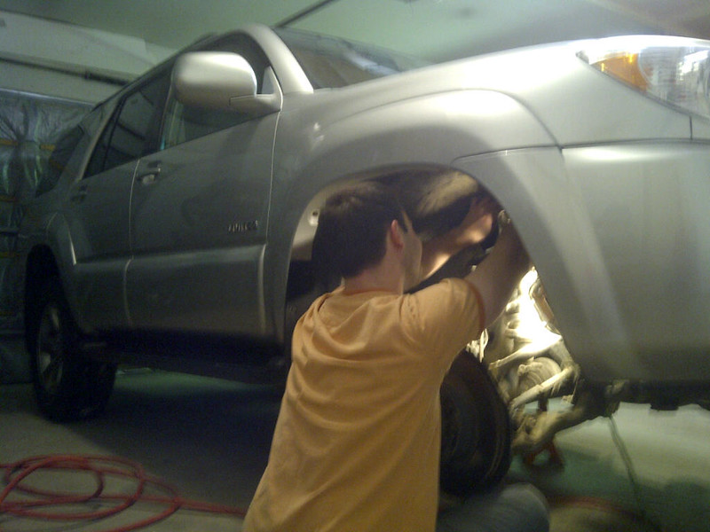

Starting the lift install. It's FJ coils and Bilsteins front and back with the front set to 1.5" and a 1.5" spacer in the back.

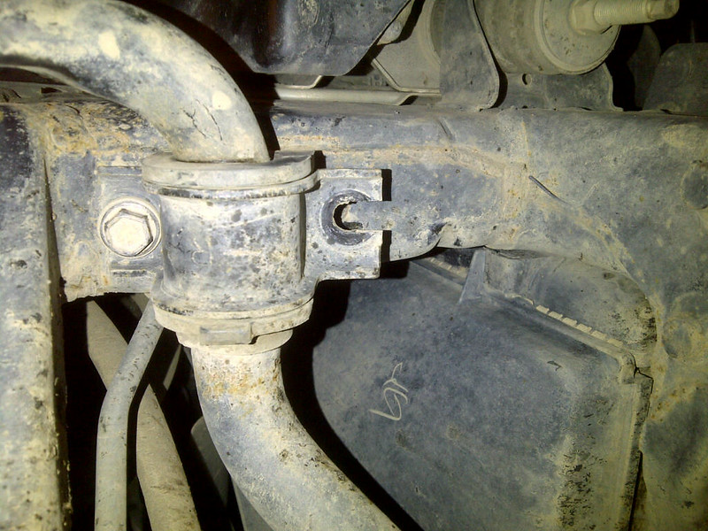

The stupid freakin' nut that broke off on the inside of the frame when I was taking the sway bar off.

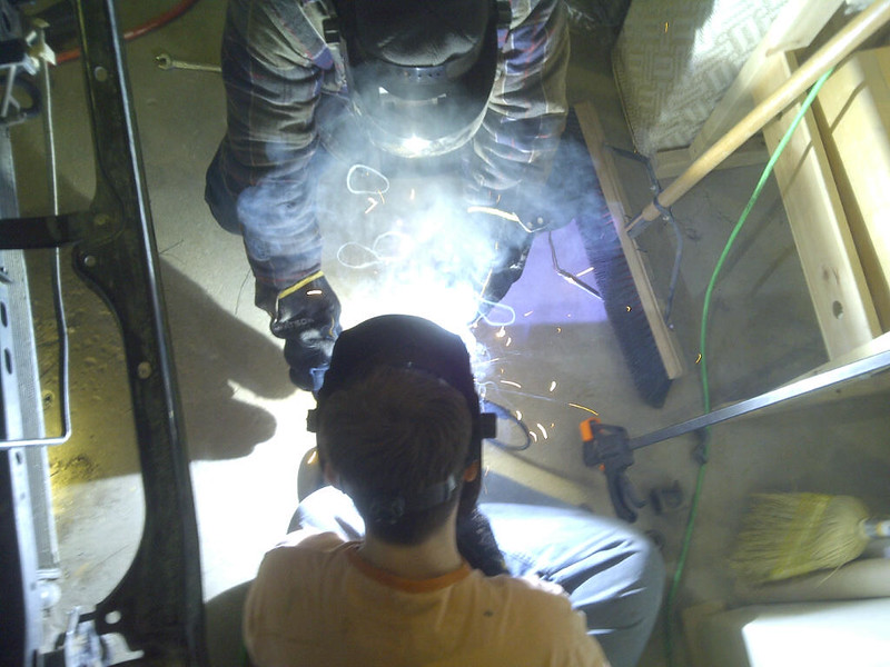

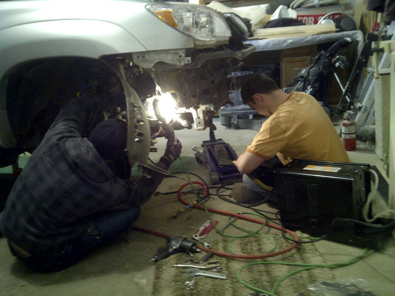

The complete bumper removed to access the little whole on the front of the frame rail to fix the stupid freakin' nut.
Messing around trying to find a solution for the stupid freakin' nut.

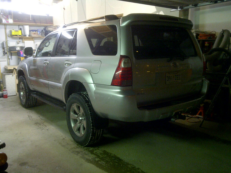

All wrapped up before the springs settled. They were off of a brand new FJ that a dealer put a lift on before selling. I put on Spidertrax spacers too.

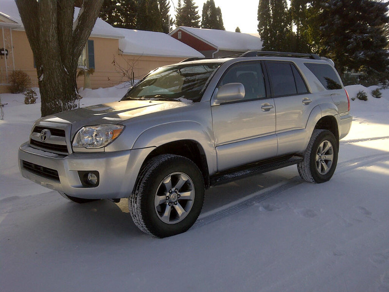

After a day of driving around.

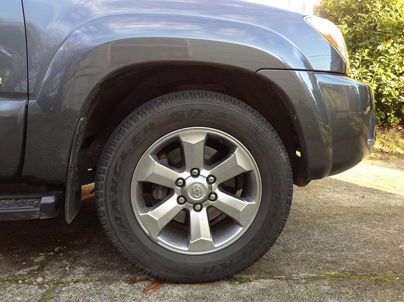

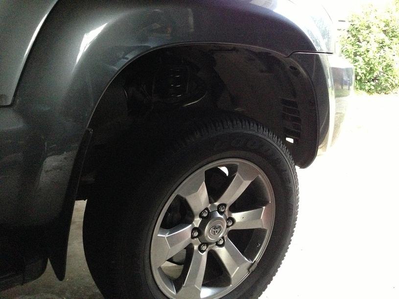

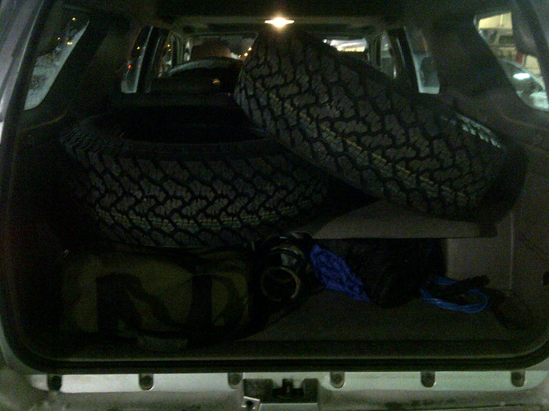

For anyone that's wondering, in my case 265/65/18 (even when very worn out) rub on the front of the inner fender with the spacers and lift installed.

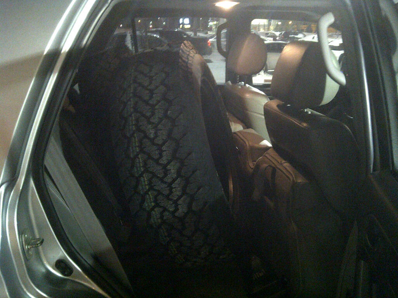

Hopefully I'll be able to get these installed sometime this week. They're 275/65/18 General Grabber AT2. I figured since I have to do some trimming anyway I might as well get the size I want.
Looks good. I love the smell of tires in the car. Based on the rake and the new tires going on, why not move the fronts up 1 more notch?
Gawd I love those tires.
I'm just waiting for an excuse to put a new set in that size on my limited. I am excited to see them all mounted up!

Okay, I think I've decided I need to go higher in the front so I could use some input. I'll get some UCA's but what should I use to get another 3/4 to 1"? I only got about 2.25" from the FJ springs and the 5100's set to 1.75". I'm worried that if I just adjust the struts to the 2.5" setting that those springs will be too compressed to handle in a balanced way compared to the back.
So, right now I have:
5100 @ 1.75 with FJ Coils = 2.25" (not enough)
What do you think?
5100 @ 2.5 with FJ Coils = 3" Is this too much compression on those coils?
5100 @ 1.75 with OME 883 Coils = 3.25"
5100 @ .85 with OME 884 coils = 2.85" Not sure this would be enough to level it out.
I know it's the same question as everybody else but this is different because it's me. :eyebrows:
I am at 3" with stock UCA's. alignments is ok, but at the edge on the caster. I would just raise it to the 2.5" point on the Bilsteins, let it settle then get aligned.

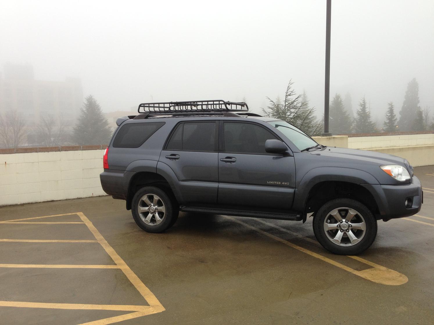

So here's a pic of my 06 with Billstiens all around and OME springs. IMG_0880.jpg
Rides great. The front is up a touch but my ARB should be here by the end of the month
I didn't get an exact measure, was waiting to see if things settled in.IMG_0858.jpgBefore. IMG_0881.jpgAfter.

Evan B and Chreaus, your rigs look great! I'm interested to hear and see what happens if you go the next setting up on your Bilsteins Evan, and Chreaus, what OME's did you use? How is the ride without the added weight of bumpers, winch, etc? What setting did you use on your Bilsteins? This is exactly the setup I'm looking to do on my runner!

Wow! What setting on the front did you use? That looks much higher than I expected front and back. Are you sure those are 895e and not 895's in the back? Was size tire are you running in those pictures? I would love to get that amount of height.
From looking at pics online I am saying they are set at the lowest groove.
I had Wheelers here in Southern Oregon install the 885 OME coils. I told them I wanted to put a ARB bumper on and this was their suggestion.
My receipt and the OME box both state that I have 895E for the rear coils..
Tires are stock, 265/60/18....
I'm getting alinement done tomorrow then ARB by the end of the month if all goes well.

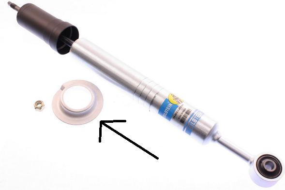

Cool. You are well on your way. If you're ever curious you can turn your wheel to full lock and look at whichever strut is easier to see. The bottom of the coils will be sitting on the collar in this picture. It is shown right side up there. You won't be able to see the groove it's sitting on but the three above it should be visible through the coil.

Yup, you got it. There is a c-clip that fits perfectly in the groove and the collar sits on it while holding it in place in the same time. So, if you can see/feel three grooves above the collar it's on the lowest groove.
FYI - Here's a picture of a collar installed upside down.
