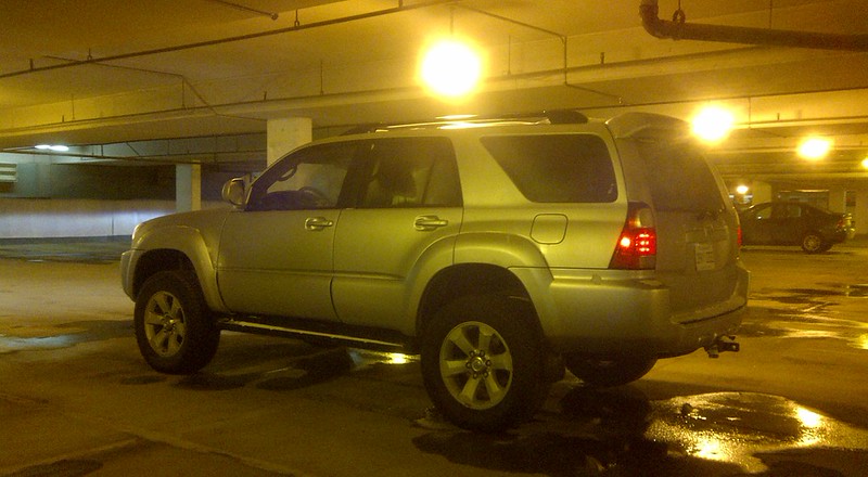

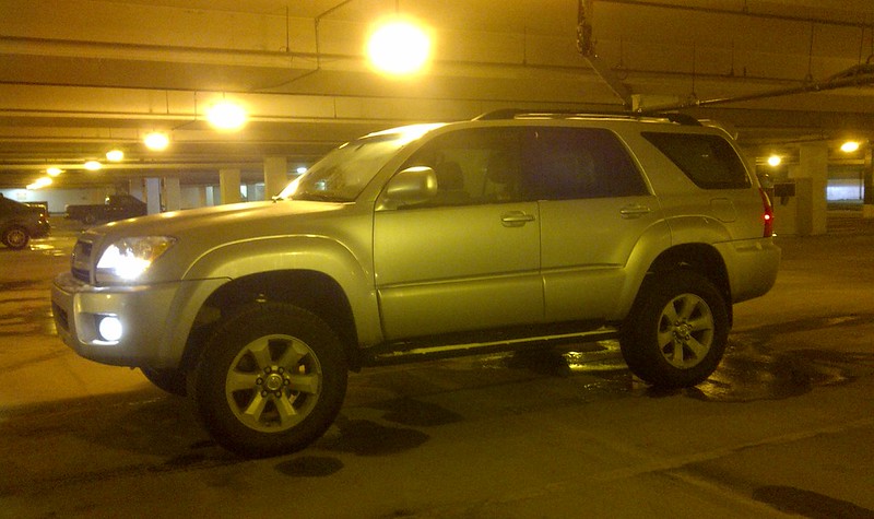

I love the new ride and look.
I want to get tires, but getting the bumper to see how things settle down seems like a smarter next step... and cheaper than tires.... kind of...

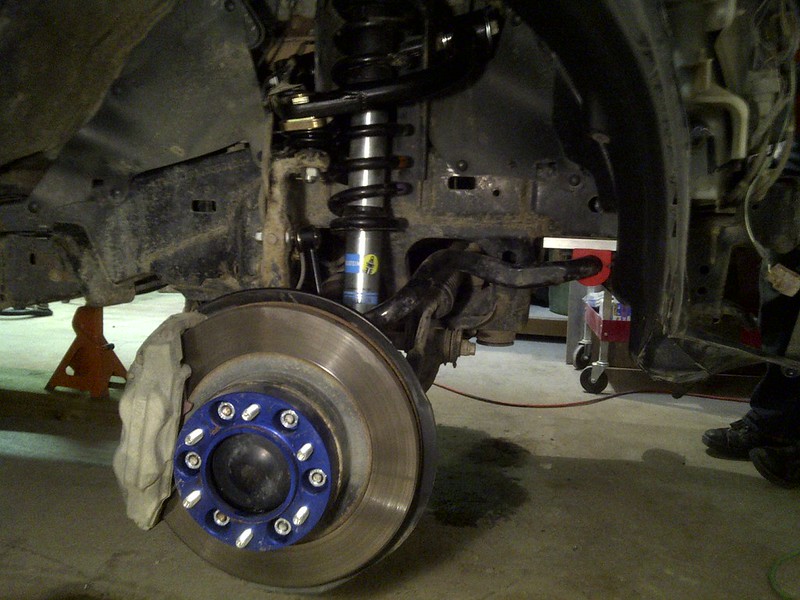

Now that I've come to realize the amount of lift available from OME coils it's temping to try 884's on the .85" setting since I'm not getting a new bumper anytime soon. Just in case I can save a few bucks I think I'll try the FJ coils on the 2.5" setting when the upper control arms arrive. If it still rides well I will probably keep it that way.
Made some progress this weekend. I got the sway bar relocator, new bushings and upper control arms installed and adjusted the struts to the 2.5" setting.
Tomorrow I'm hoping to have the new tires installed and alignment done.

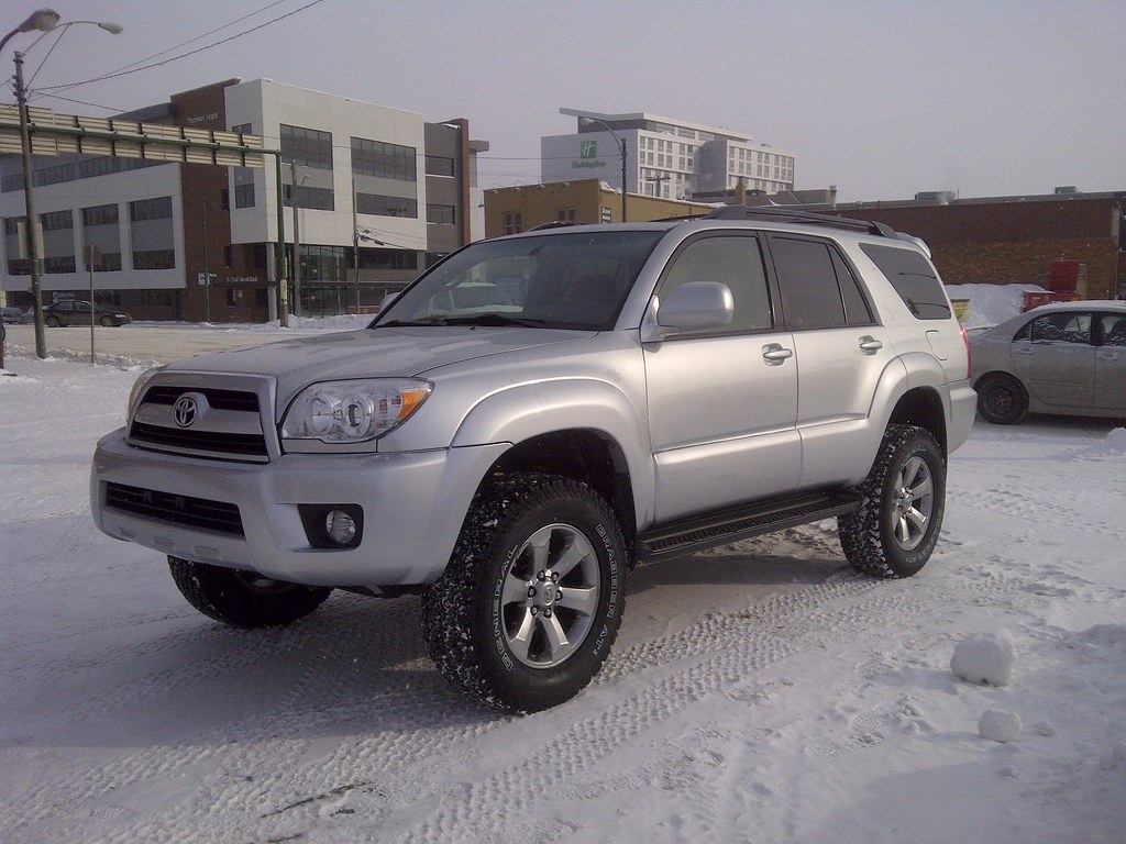

Got the General Grabber AT2 tires installed today. I am very happy. I forgot to specify the white lettering in or out and they guessed out. It's not what I was planning but I think it looks alright.

Any different feel with sway bar relocator ? Noise of any kind ?
Nope, no noises at all. I had a clunk in the front end before I did this round of upgrades so it was either a sway bar bushing or an upper control arm bushing. Luckily, everything is silent now.
Hey evan B how have those been since you put them on? Do they perform well in the winter conditions ? Im in the market for new tires and these are one of my options. Thanks
I really liked those tires. I traded my 4Runner for a Tacoma a few weeks ago and it has BFGoodrich All-Terrain T/A KO. I've heard rave reviews about the BFGs but they are way louder than the AT2s were. The AT2s were fantastic in winter conditions and I liked the look of them better too. This will be my first winter with the BFGs but for them to beat out the AT3s overall they will have to be f-ing magical in the snow.
OK thanks thats actually a really big help because i was pretty much between these two tires.So i think i might go with the generals
