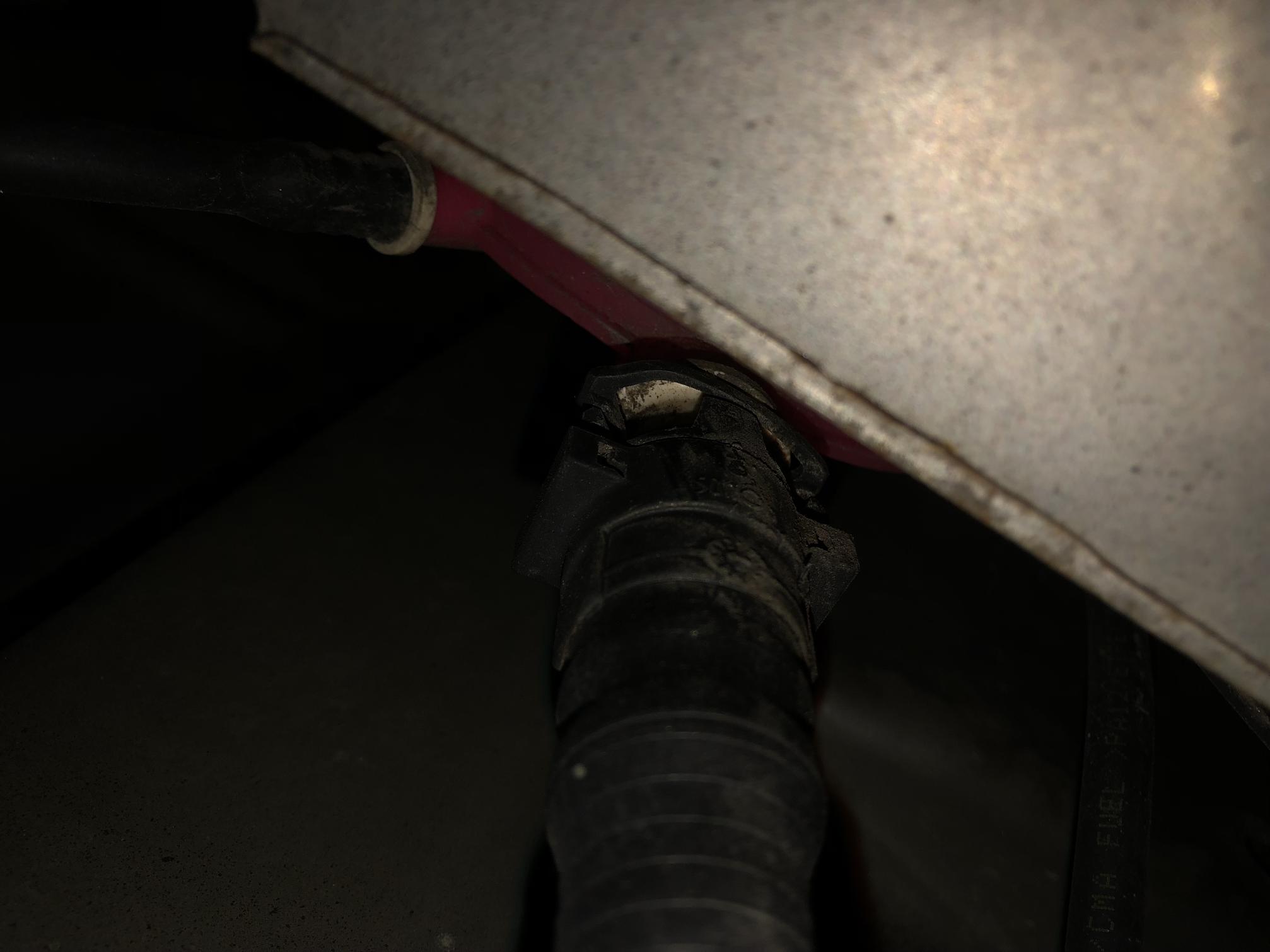

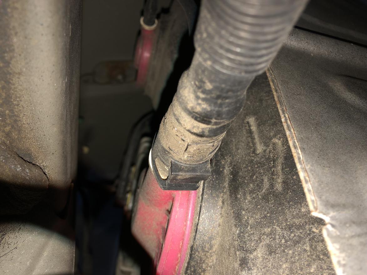

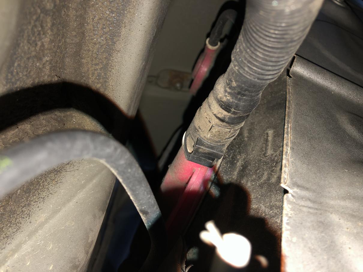

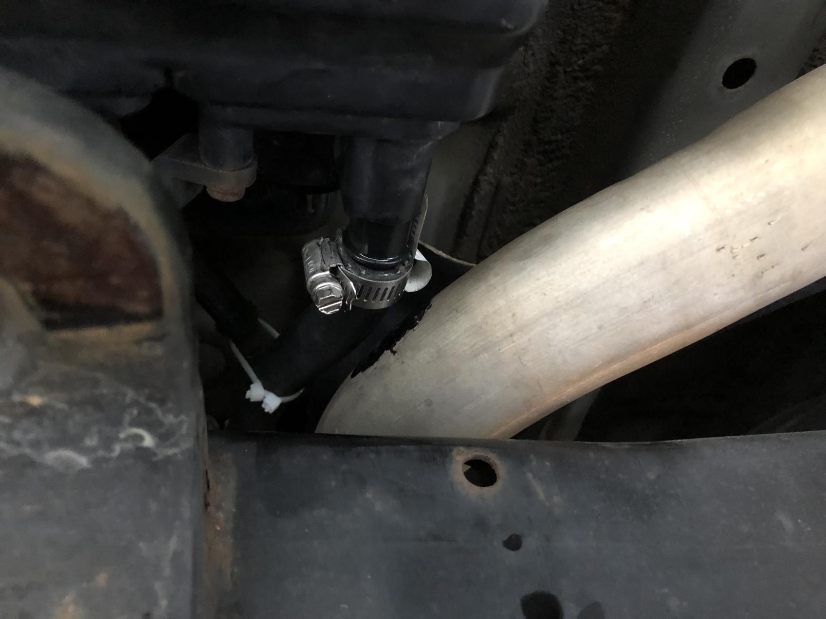

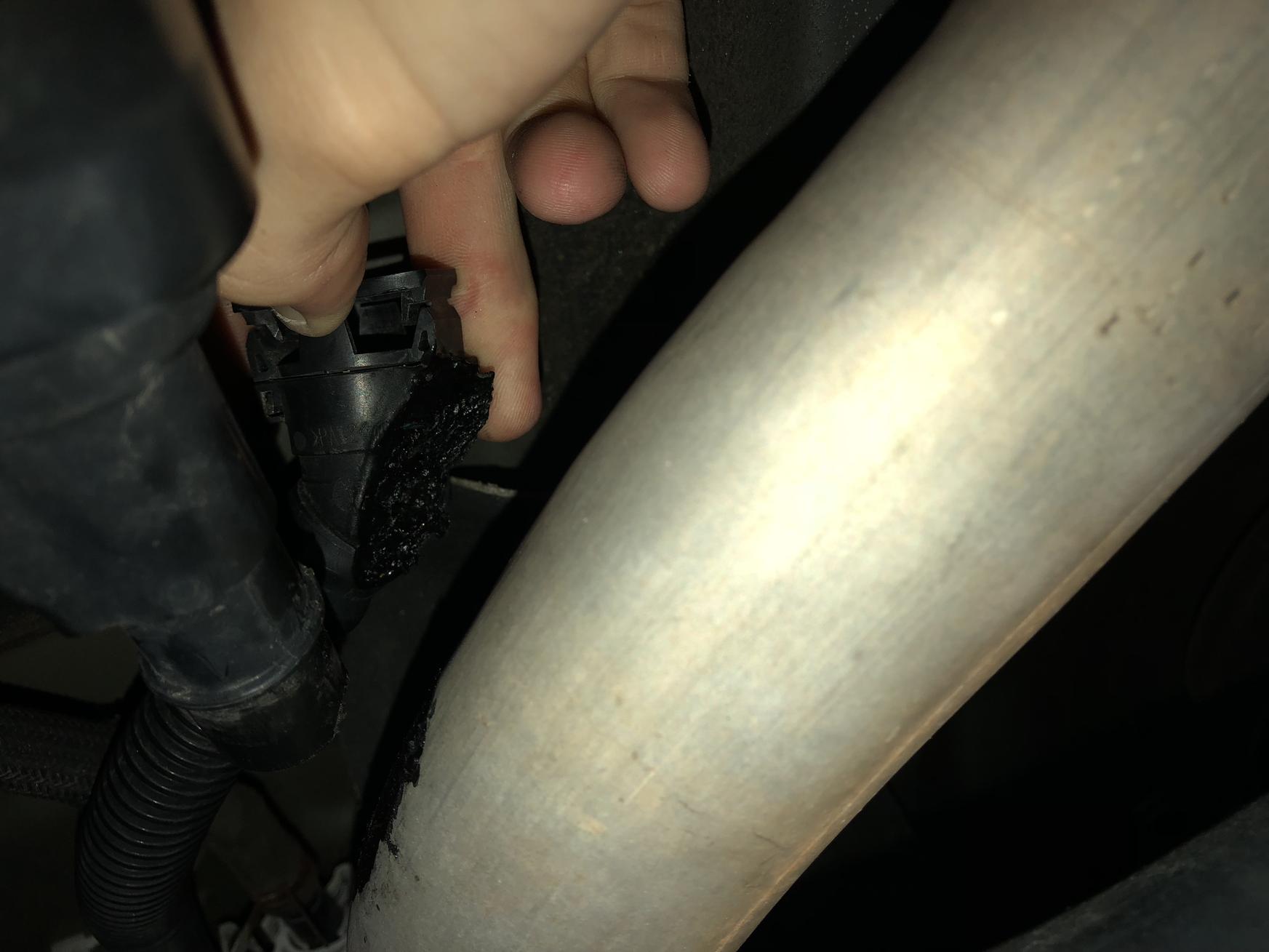

Just went to Toyota today to get an evap system test done...

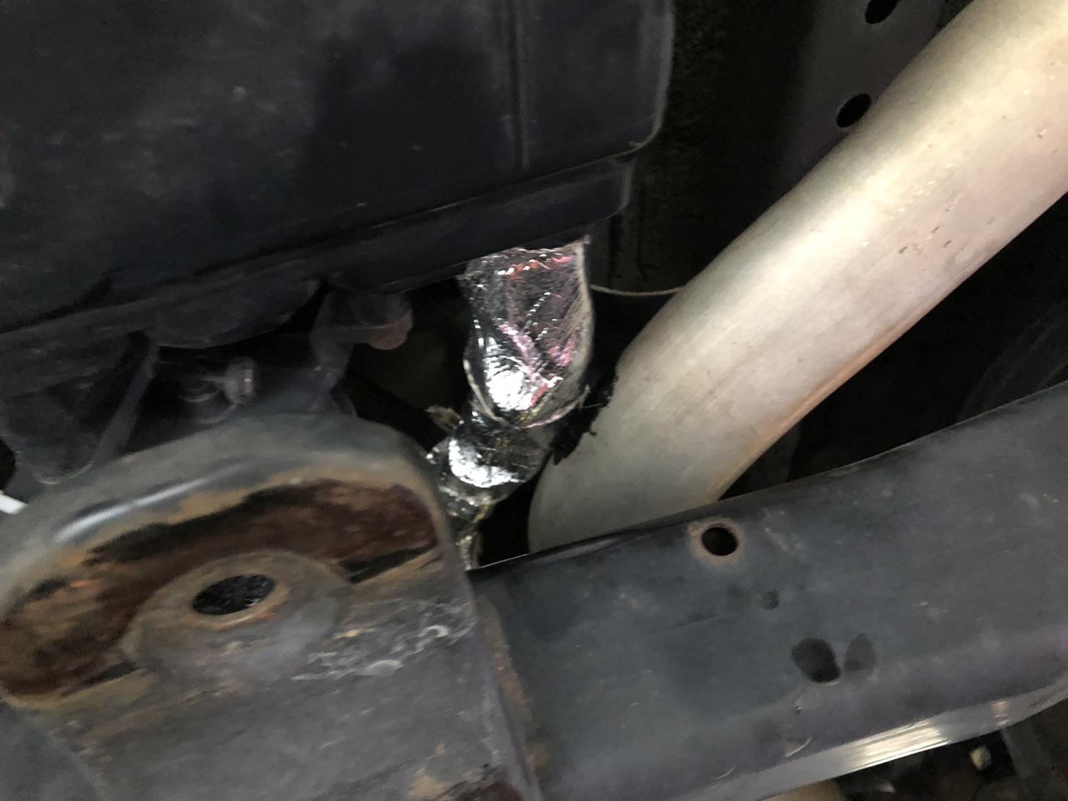

long story short very quickly they found out that the part of the exhaust that goes over the rear crossmember had been moved when I had my new exhaust put on which caused it to melt one of my evap lines. No wonder I had a major leak code lmao. The part is 30 bucks and I got heat shielding tape to avoid having this issue again. I'll post a pic of what it did when I replace it friday.
Fingers crossed the evap system issues are a thing of the past

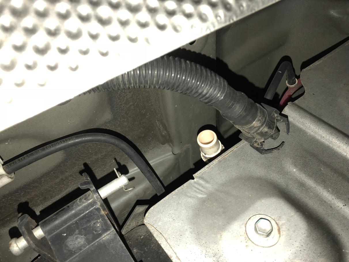

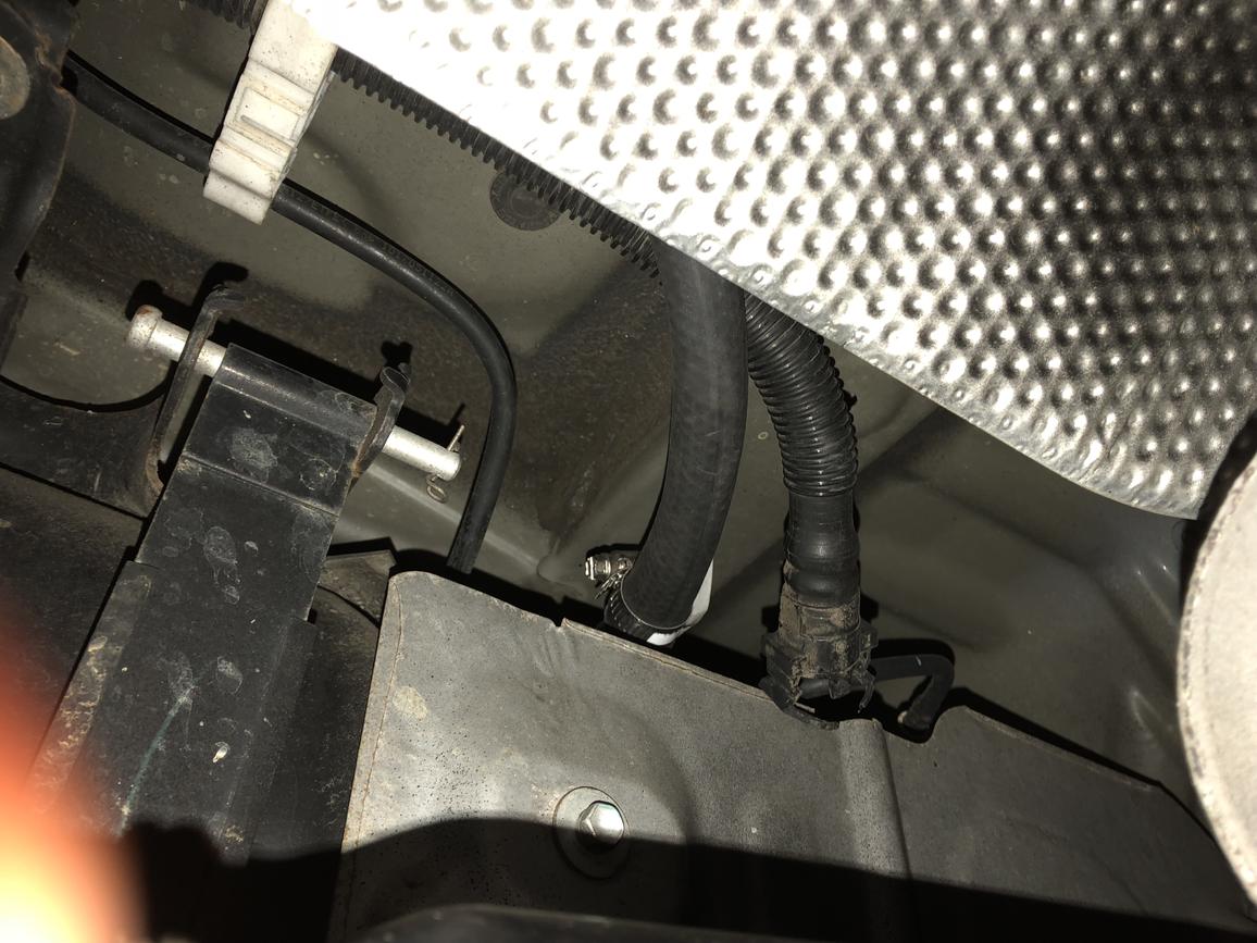

Toyota wanted 233 dollars to replace the melted hose because they claimed the fuel tank needed to be dropped to remove the hose. Not the case. I bought a high temp 7/8 OD rubber tubing with 2 hose clamps to replace the original line. I used zip ties to put it in route of the original hose and where the original had melted I used a 2000 degree safe adhesive tape to ensure nothing would melt again.
I would be rasing hell with whoever did your new exhaust, why in the world would they reroute the exhaust that close to a rubber hose much less one that is part of the fuel system!!!
I would also have them move it further away from that hose and the connection point, even with the tape you're just asking for more trouble leaving it as is!!

Yeah well I think the issue was that a portion of pipe was too long when it was welded in causing the bend around the frame to move up and over to the left. (I should have looked after the guy had welded it) My plan is to once I'm back in charlotte have it fixed by moving the muffler towards the front of the 4runner about 4 inches and then have the resonator behind that in hopes I can get that bend in the pipe further away from the evap line.
a good exhaust installer will replicate the factory bends somehow with the new pipes. atleast your truck didnt start a fire.
I agree. Whoever I take it to once I'm back won't be a random shop. My heart sank a little when I saw how melted that fitting was especially since I had been driving like that for nearly 4 months

No problem! I'll be getting this properly fixed this fall with having my resonator and muffler run together and the pipe routed properly with a side exit tip. I completely understand where you are coming from. I'm very hesitant to bring my 4runner to anyone as I had a complete F***show to deal with about a month ago (posted a thread on it). This is why I'll be replacing my needle bearing myself hopefully later this week when I get a day off of work.
Update
Just wanted to let everyone know how everything has held up. As I had said I will be getting the exhaust permanently fixed this fall. But as for the evap issues they are a thing of the past! this replacement hose fixed all the error codes. Also I replaced the needle bearing with one from ECGS and it completely eliminated my vibration! Thank you to everyone for their feedback. Yall's input saved me close to 1000 dollars in repairs
