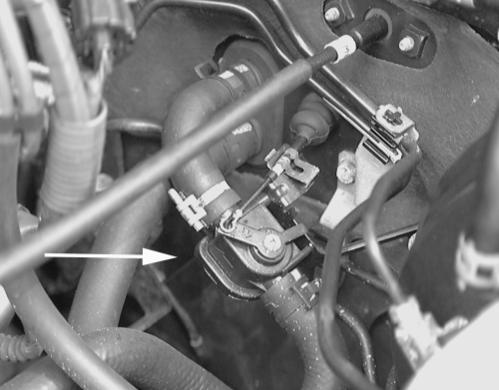

I believe the OP is talking about the clamp above the arrow on the heater control valve pictured below. (web photo of some random Toyota) They are factory clamps, the 3rd gen has a few of them scattered around, at least my 96 did.
They are a pain to take off. Needle nose pliers slowly will unwind them. I have never tried to reuse one. Just find the correct size constant tension clamp to replace it.
