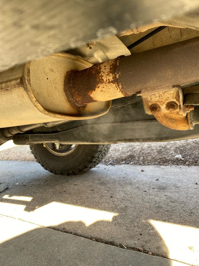

On cold weather cold starts (<25*F cold starts) I get some condensation coming out the tail pipe. But today the condensation in the exhaust system revealed a leak. The leak is in the last joint after the muffler.
Question:
There’s no reason to fix this, right?
I’d like to eventually install all new cat back, something like the Magnaflow Overland series, so I’d rather not mess with my old worn out and rusting out exhaust until I’m ready to replace it all, if I can help it.
In the photo, you can see a water droplet at the joint, and the water that has dropped and splashed onto the rear sway bar and diff.
(Unrelated, but just in case someone asks: that yellowish waxy stuff is 3M Rust Fighter-I Cavity Wax that was sprayed all up inside the nooks and crannies, after all the blasting and POR-15.)
Thanks!!
The only reason to address it is if you were sleeping in the vehicle while it was idling (or, I guess, just stationary for long stretches while idling). But even then, path of least resistance is going to put the majority of gasses out the back.

If you want to replace the exhaust eventually I see very little reason to mess with it now. If your tailpipe was full on blown apart, sure, but a pinhole won't kill you

Very common for these flanges to start seeping. I had a walker exhaust rust off right there in 4 to 5 years. If it's just a seep leave it alone unless you want to replace your entire exhaust from the cat back...:)
It's also always best to vent the exhaust out to the rear or side. As I used to see folks rot there beds off in the 80s and 90s by not fixing busted off exhaust around here.
As long as you don't see carbon and soot on your frame and or body it's ok...:)

Well, I said I wasn't going to fix this, but I can't quite help myself, so I sanded/scuffed and cleaned the metal at the flange, and then generously applied some J-B Weld ExtremeHeat paste. I'll let it cure for 24 hours and see if that fixes this (minor) exhaust leak.

Lol. It got you.. That may work.. I tried it and only may work if you take it apart. New gasket and the high temp jb weld.
I am going to use new bolts new gasket and permitix ultra copper exhaust gasket majer on these rusty flanges. I believe I have better succes then using the ultra high temp job weld..:)

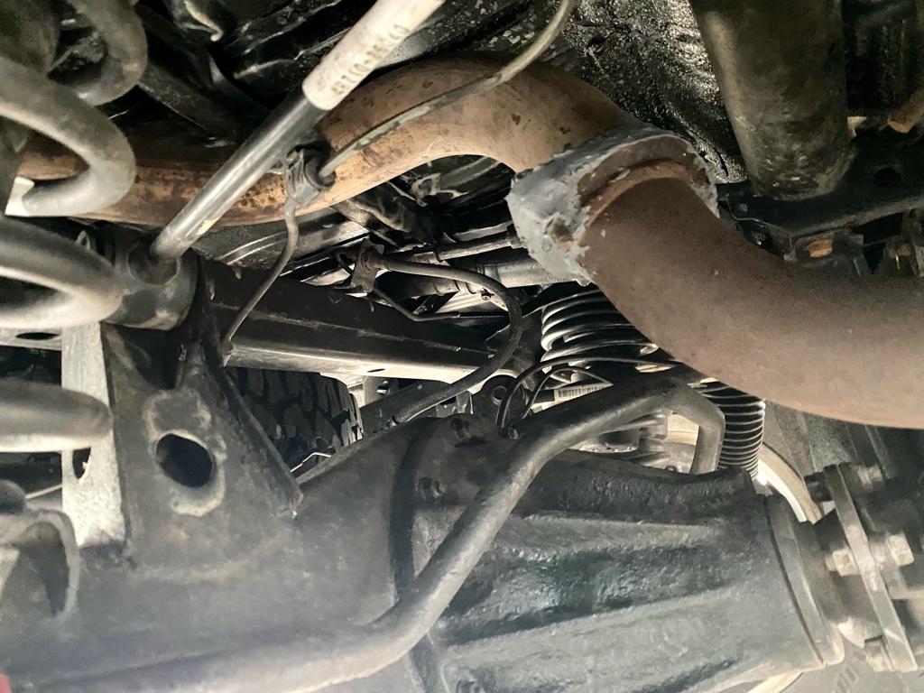

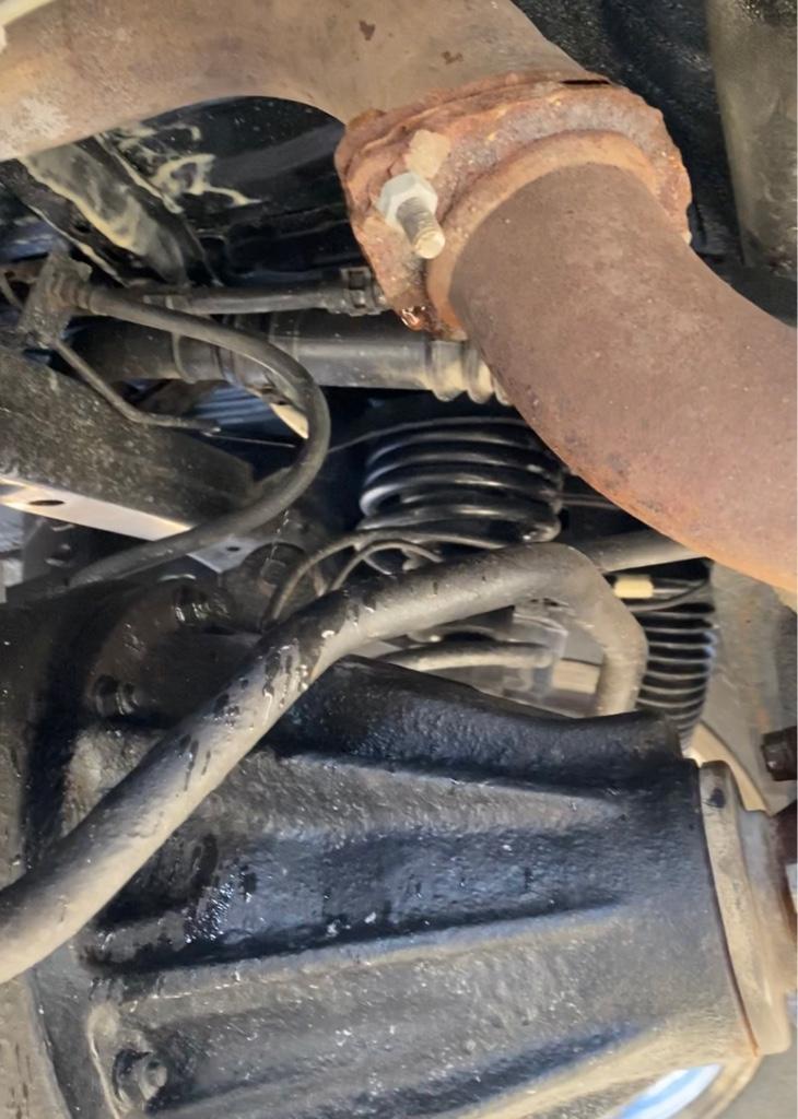

So far the JB Weld is holding up at the flange after the muffler (see previous posts in this thread for photo).
But fixing that leak revealed another one in front of the muffler!
You can see the smoke from the cold (5*F) cold start in the photo:
I have the feeling this will be a game of whack-a-mole until I replace it all…

I know that on the back cat flange because of the metal expanding and contracting the JB Weld high temp will crack off in time. :-( Most likely the metal around that hole is extremely thin and if you try to weld it shut it will most likely make
this hole worse.

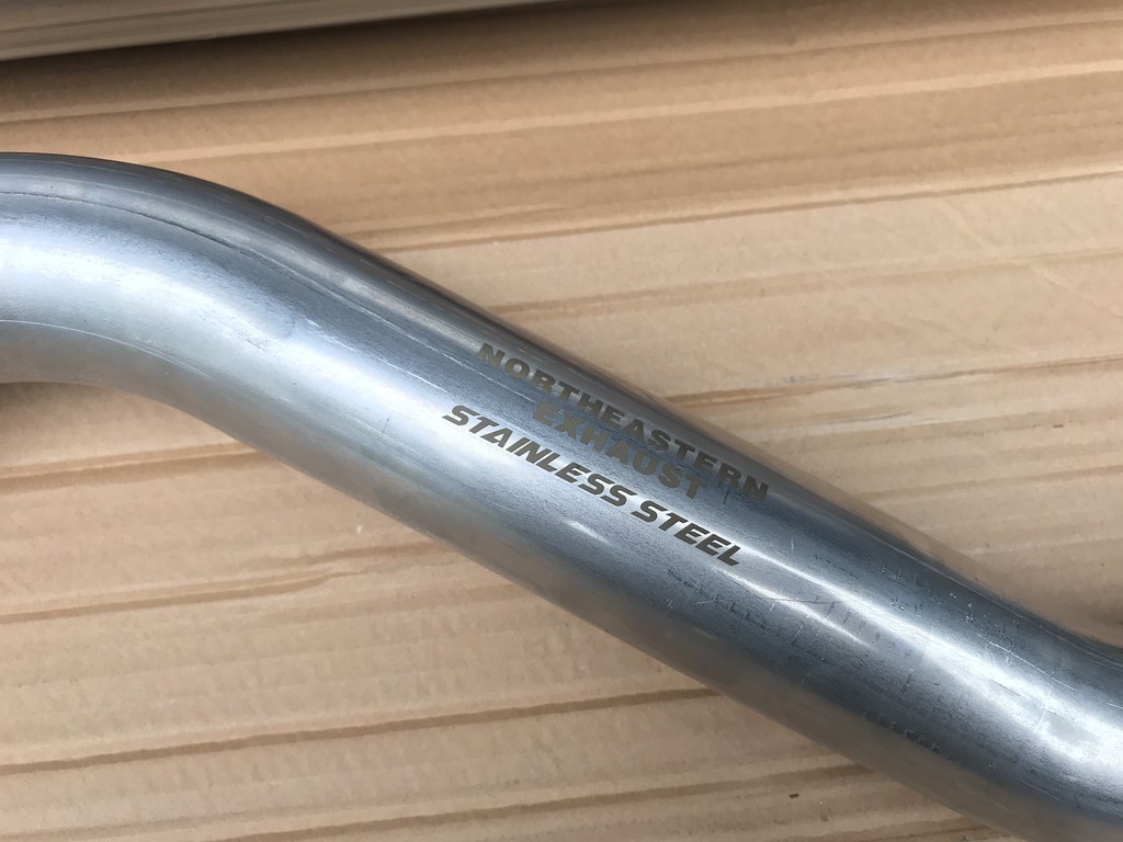

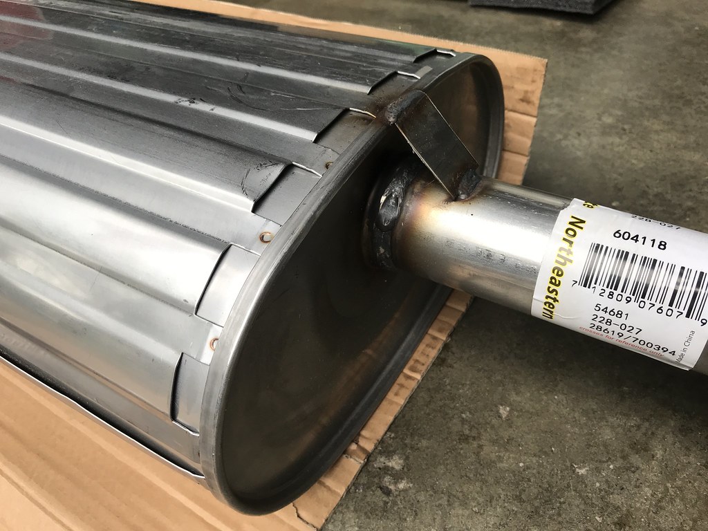

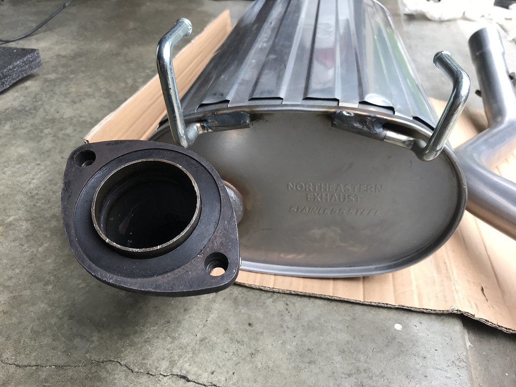

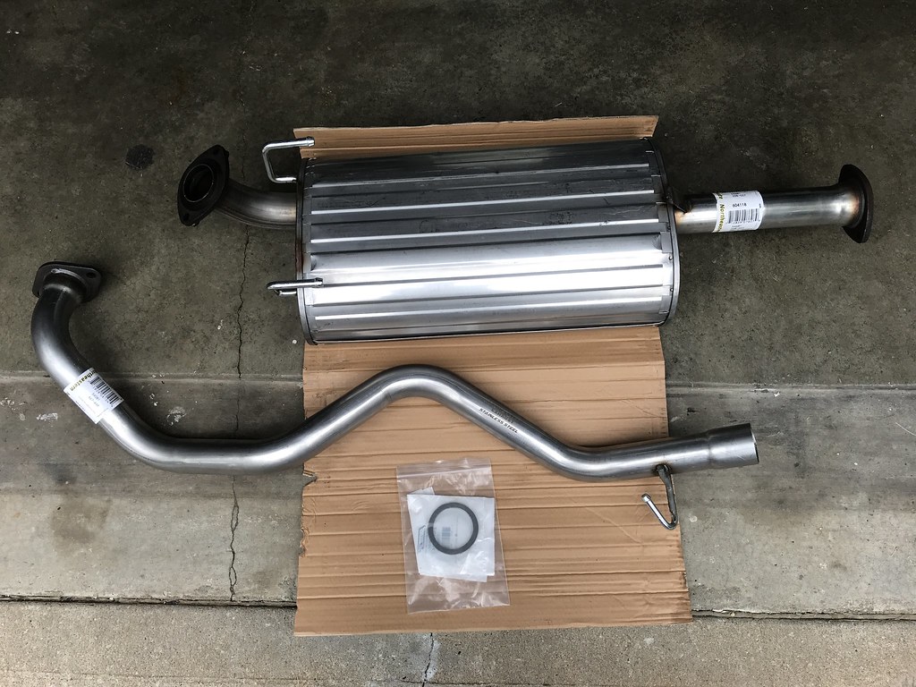

Another plug for Northeastern exhaust system! Very pleased with the fit and finish. I usually have low expectations for aftermarket OE replacement exhausts from past experiences, but T4R2014 spoke highly of them, and went on his recommendation. High quality welds, bolt-in affair, and saved a considerable amount by not going factory Toyota. I imagine it should provide the same years of service as the factory system, if not more.
I'll upload some pics of it here in a little!
These are pics of it new from summer. I will get some updated pics of it on the truck tomorrow (6 months of being installed and copious exposure to salt).

Looks like a newer model then mine or that's for the later model years. .. :) I have mine one for a year or 2. They will discolor and light rust especially on the flanges. It sure looks like they last way past the 5 years of a walker . Plus a very decent price. :) I am very pleased with mine.

Looks impressive, was installation straight forward as in bolts right up with no modifications?
May order one for my 02 and keep it on hand for when mine finally drops.
Yes they bolt right on. No modifications. Like I suggested may wish to get that back cat hanger back in there with stainless bolts so you can take apart and put new gaskets in if you need to work on something..:)
