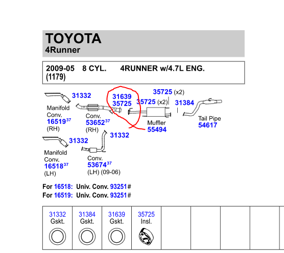

So my exhaust is leaking in the back half and im replacing it and trying to find the right parts to purchase and im seeing these parts is this spot I labeled in red here a spot that needs to be welded because I looked under my own car and didnt see an area for screws,bolts, or clips and I wanted to know if it was possible to even do this with some tools and in a garage?

I welded 2 new flanges on the pipe with the 3 ends. The old flanges were rusted very thin. That pipe/cat is pretty expensive to replace. A picture of yours and where the issue is would be helpful.

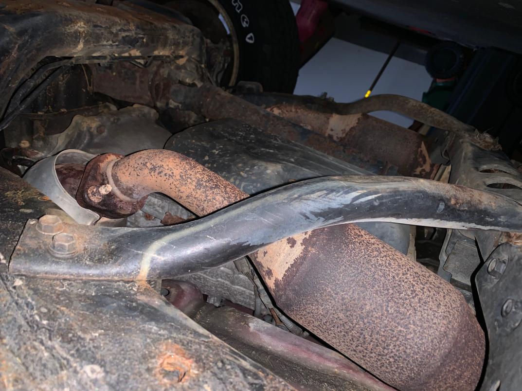

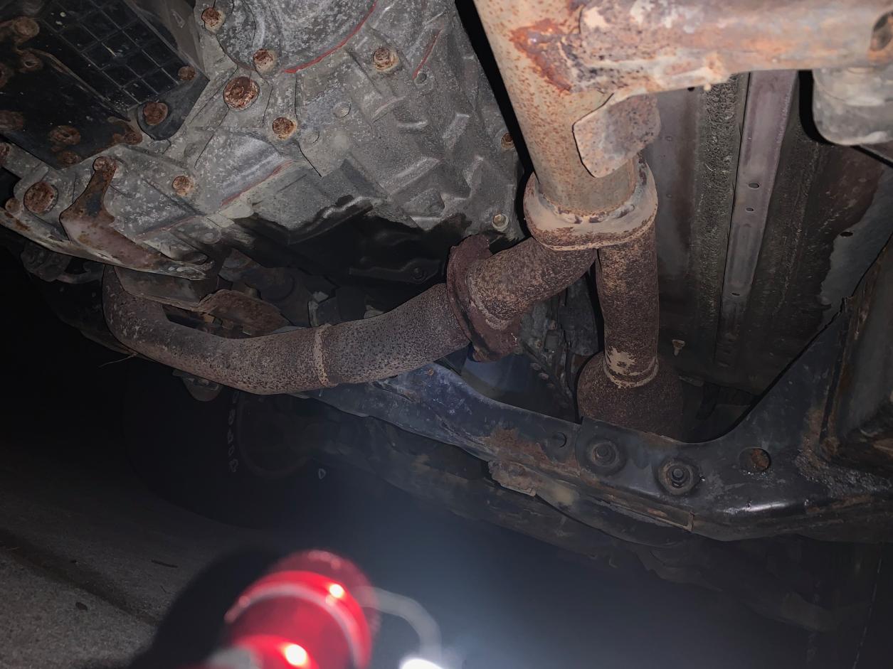

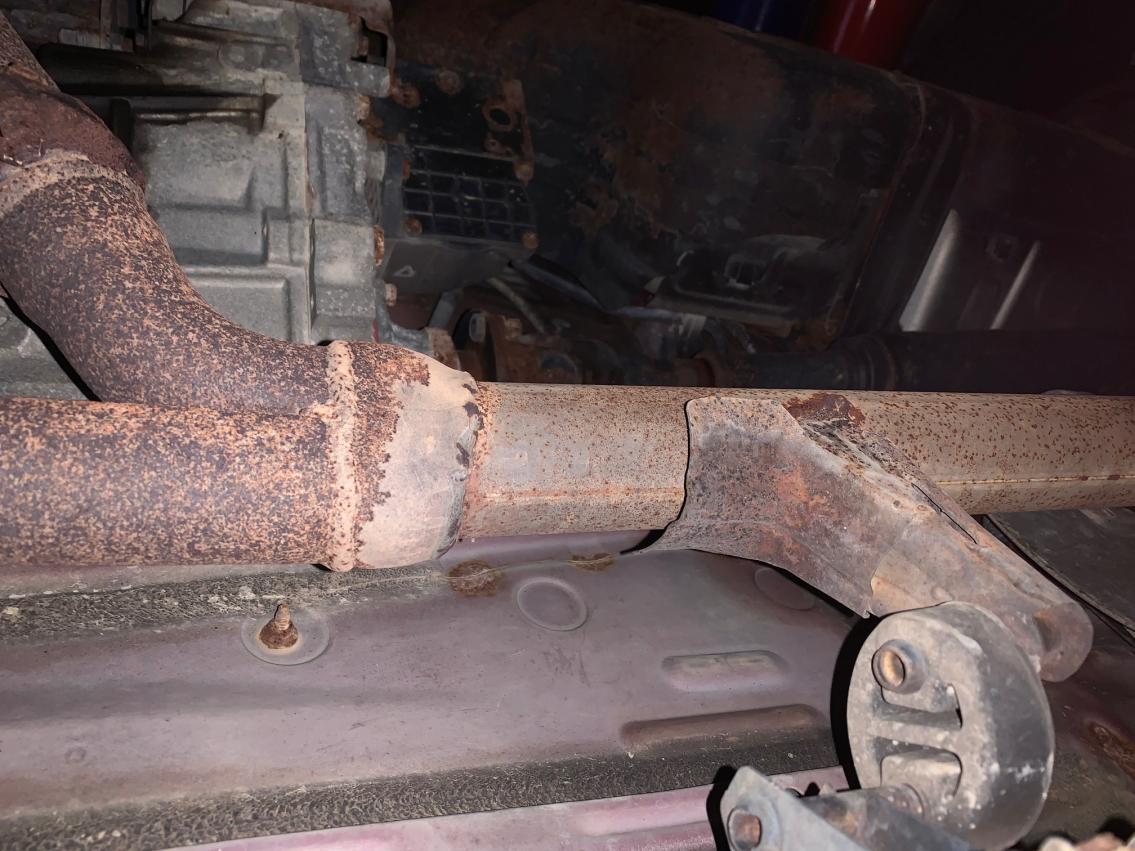

Hope these help
Somebody has already monkey'd with your exhaust. That is supposed to be a bolt on flange at the end of the y pipe & that's not a factory muffler.

That exhaust does not look like mine, that's an odd setup you have North of the rear cat. Looks like a muffler shop may have done some welding there. The back section could probably be bodged together with pieces you can buy but the tail pipe is actual quite cheap to buy from Rockauto. I was going to bodge my tailpipe but it basically fell apart when I removed it.
Hard to tell if there's a flange at your existing muffler's outlet, but it does look modified. Here's what the OEM style replacement (Walker brand) looks like

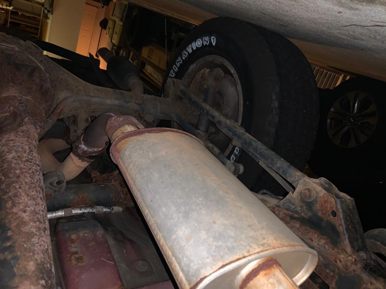

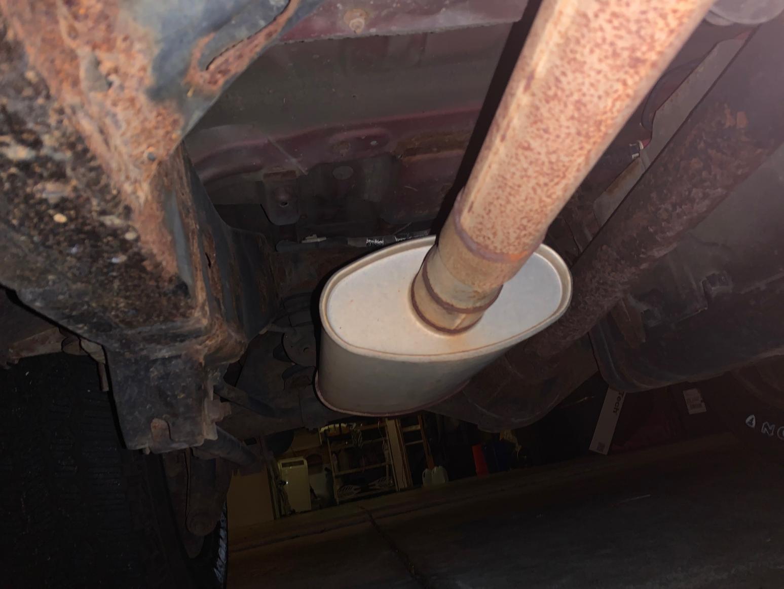

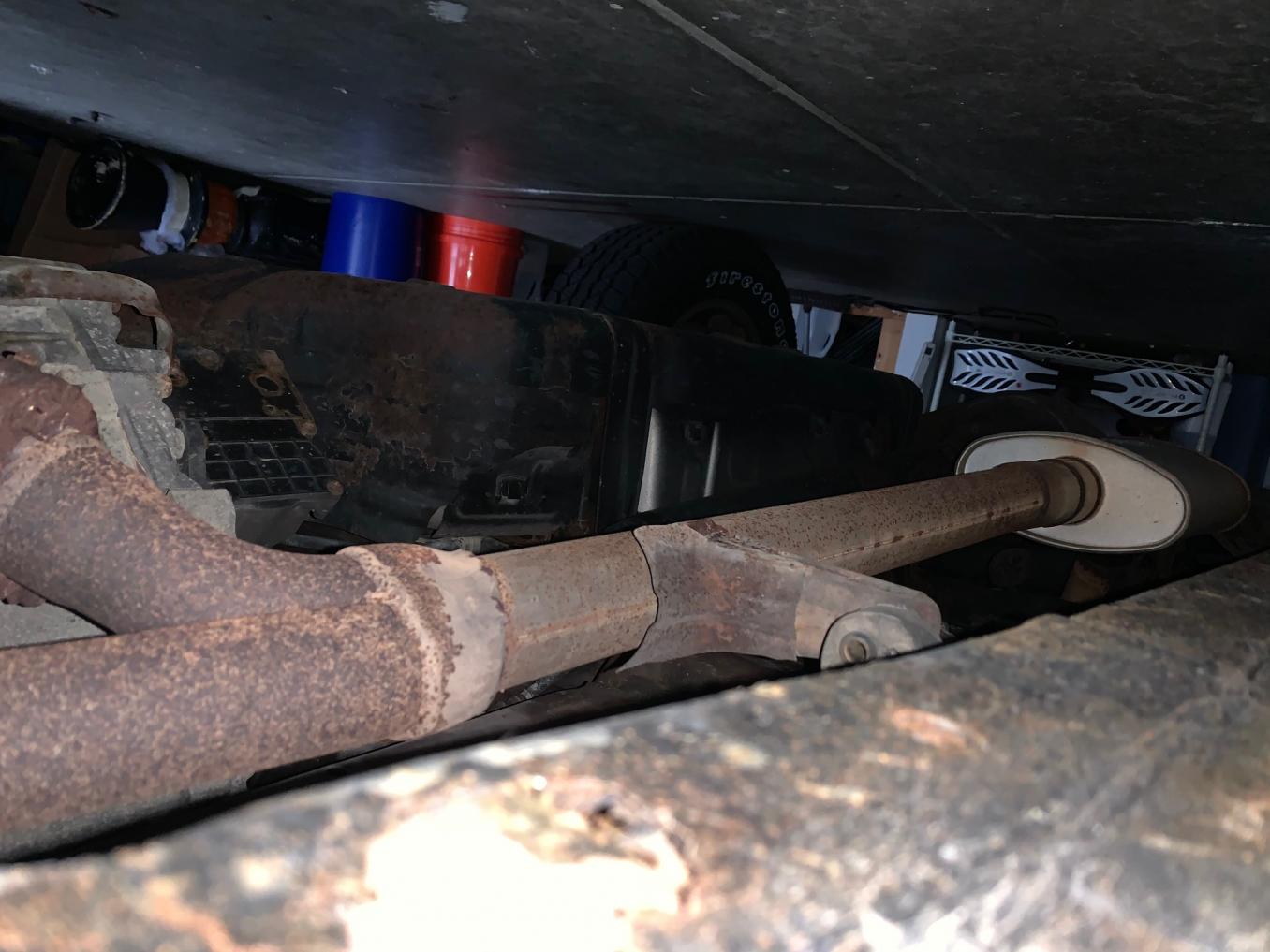

Here are some pics

Yup, whoever worked on the exhaust chopped off the inlet flange and just welded the muffler to the existing pipe. The bolts were probably so badly rusted that chopping/welding was faster. Know anyone that welds?
Sadly I do not...have any suggestions?
Best bet is to purchase a new catback exhaust that is designed for these vehicles. Then, Take it to an exhaust shop and have them cut off what's being replaced - mount the new parts - then weld on a flange that will to align with the newly installed parts.
That will approximately restore the factory flange location close enough that the catback and y-pipes can likely be replaced with factory-compatible parts in the future. Any exhaust shop should be able to do this.

Visit a chain shop like Midas or Meineke (or a local exhaust shop) and get some labor quotes. Explain to them you want to install a bolt-on replacement system and how your existing system already had the a flange chopped off.
