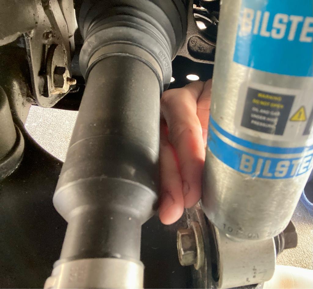

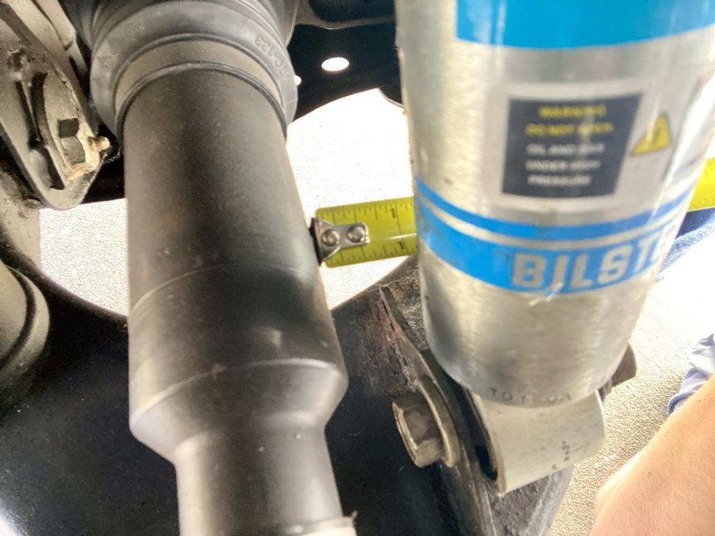

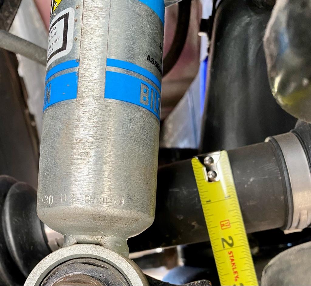

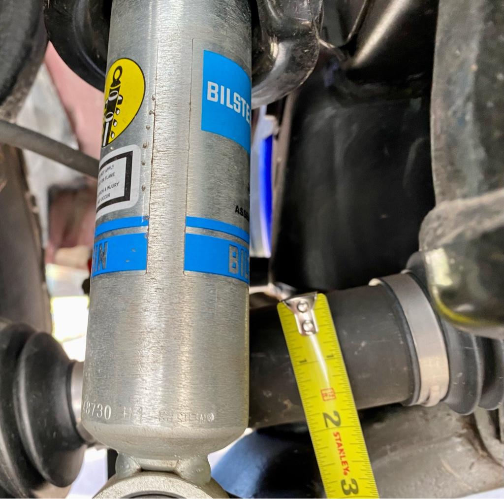

CV and 5100
I got one from rockauto (to8043et) for $120 shipped and I also got one from autozone (duralast or whatever) and its the exact same axle. They definitely articulate better than my OEM ones. There are reports that they do not fit with bigger coilovers but I just have basic 5100's and its a perfect fit.
I have 6112 in front, and I was wondering if there about the same size? I didn't want to order the Tracktion CV and it not fit?
2000 4Runner 4wd SR5 Limited.
Cheers!
[MENTION=414672]Locke434[/MENTION] The TrackMotive axles are quite a bit thicker than OEM.
Here are some photos of the TrakMotive and Bilstein 5100 clearance.
Steering wheel dead center, stock weight truck sitting on level ground.
5100s set to lowest perch and paired with OME 880 coils.
Hopefully gives you a better idea about 6112 fitment:
