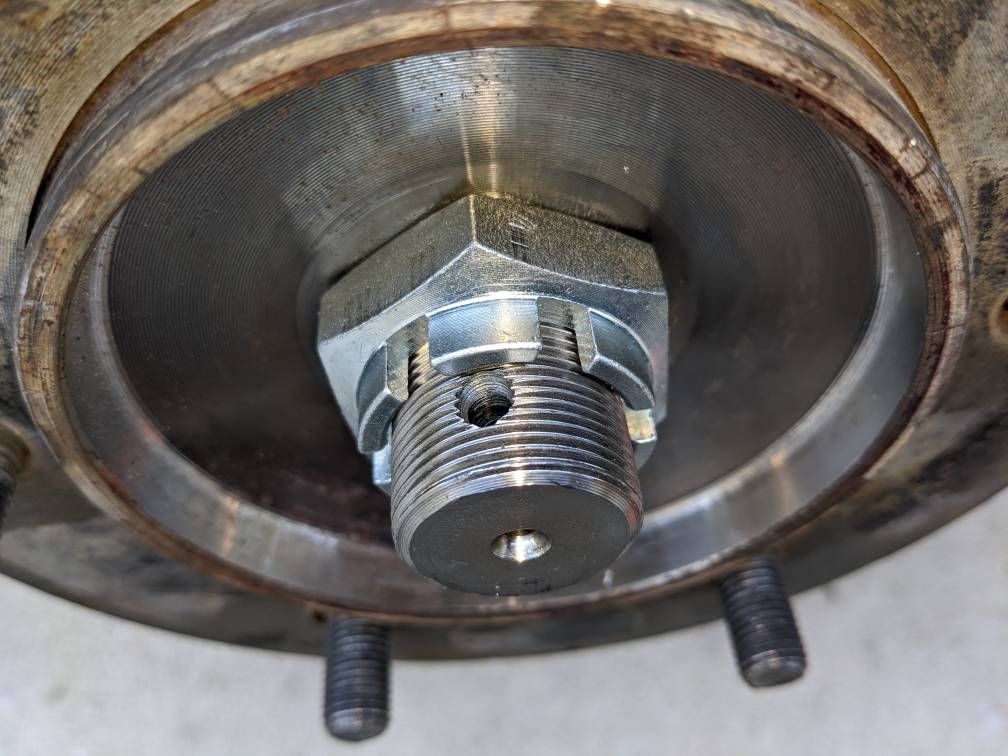

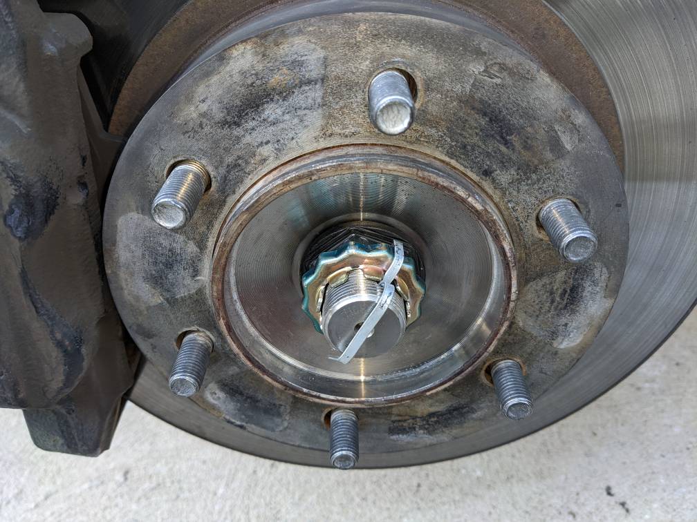

Install was a breeze, I put the nut on backwards and pounded them in with an 8# dead low hammer; 2-3 whacks is all it took.
I didn't swap c-clips but I did grease them and installed the axles into the diff gap up.
Removing them is going to be curious as there is only a flimsy dust ring, nothing to pry on like the factory axles.
Also, the 40mm axle nut went too deep on the axle shaft, passing the cotter pin hole in the axle by 1/8" plus
Rather than go get washers I reused the 35mm Toyota factory nut and castle cap, torqued to 174# with my buddy on the brake pedal and installed a cotter pin and wrapped it up.
[ATTAH]392904[/ATTACH]

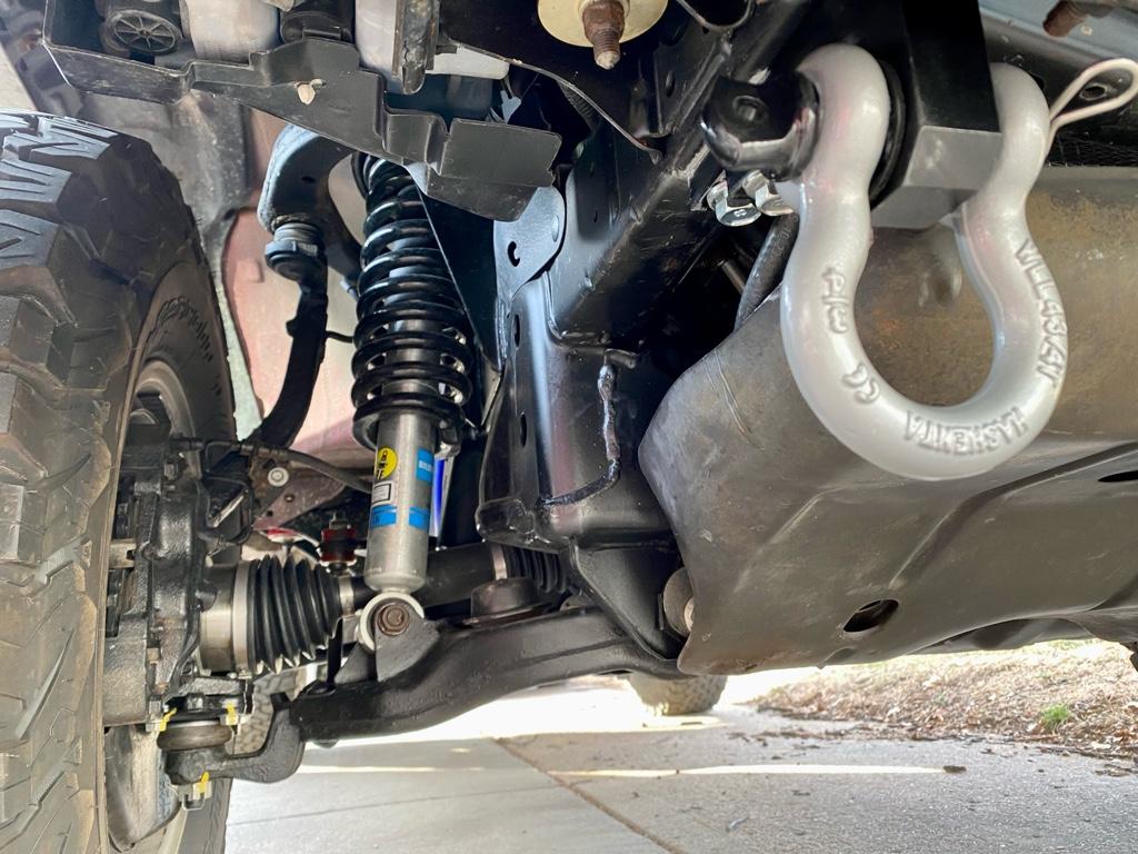

Does anyone know if these will fit with some of the larger body coils? I saw the thread on Tacomawolrd where the guy had some contact with the CV/Shock, but seems like it was alignment related. I'm going to be pushing my caster into the 4.0 territory to clear some meaty tires eventually, don't want to have issues.
Both 5100s and 6112s seem to fit fine, although that's with stock UCAs, so that might not be relevant to your application. The photos might help you visualize, though.
https://www.toyota-4runner.org/3695919-post39.html
https://www.toyota-4runner.org/3695987-post40.html
Once I install the cam eliminators, I will set my rear cam plate outboard (+) and my front plate neutral (0) and my UBJ to "E" to get good positive caster, then take it for an alignment.
Gotta weld on my PCK first tho...
I get the same 1"-ish clearance between the shock body and CV shaft.
I centered the UBJ in the slot in the UCA per SPCs instructions but it looks like it needs to move inward. Until I set up the LCAs tho, it's gonna be what it's gonna be - at least it's not my DD at this point.
