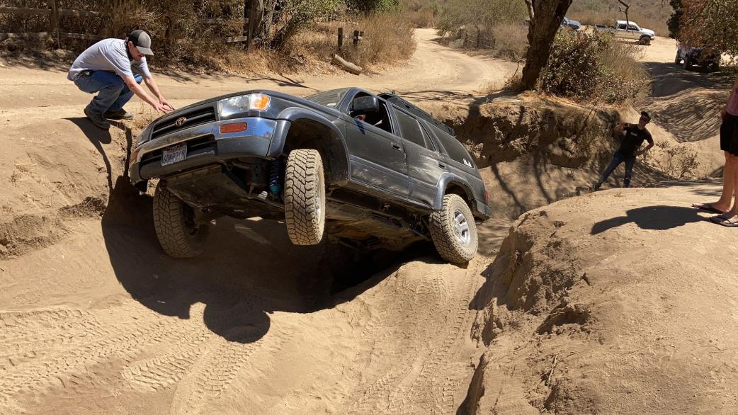

Could be worse, everyone out here runs old OEM shocks with spacers :lmao:
Just buy some quality coilovers, or just keep it completely stock
I got rid of that 4R almost 2 years ago, but did put it through its paces having been one of the first to buy into those CV axles
My old 4R with a wheel a good 4 and a half feet off the ground lol
