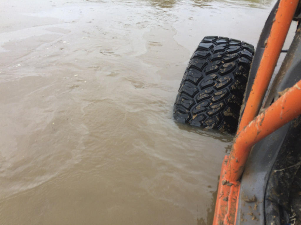

Any video? I would imagine you would have installed gopro mounts all OVER that thing! It would be hilarious to put 15 cameras on it and do a quick sequence where they all interchangeably cut, in time

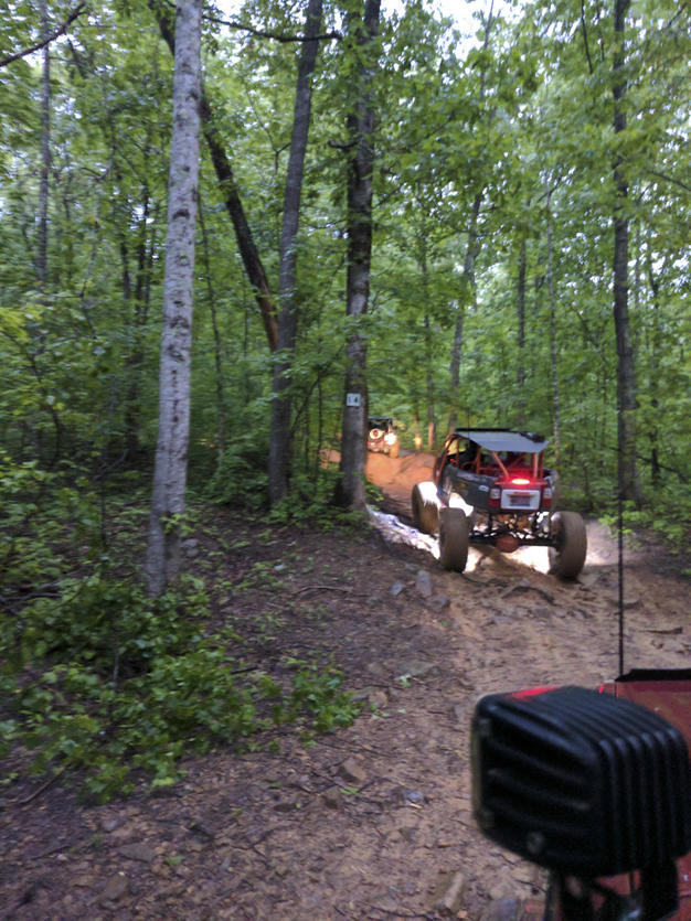

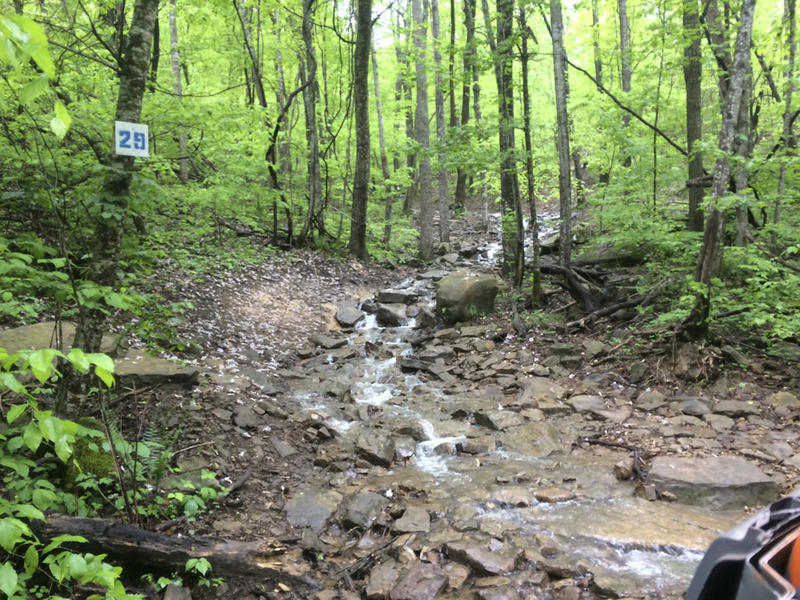

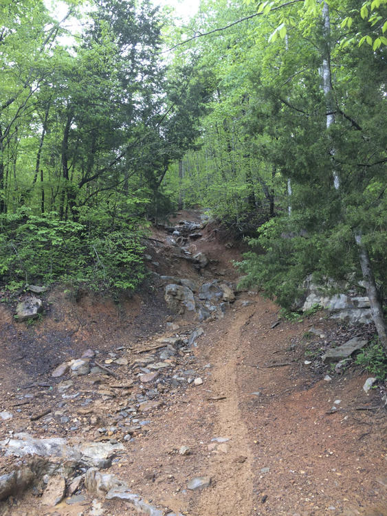

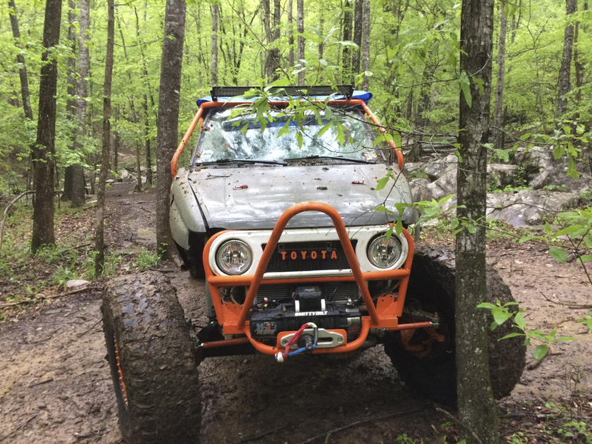

Literally the ONLY ones stupid enough to go wheeling in weather like this. Kinda not best to wheel alone, but we didn't try anything crazy and had good recovery gear, tools, parts, etc. It was kind of nice to have the whole place to ourselves. Very peaceful to be up on the mountain with nature all around. The sounds of rushing water all around you! Love it out here!

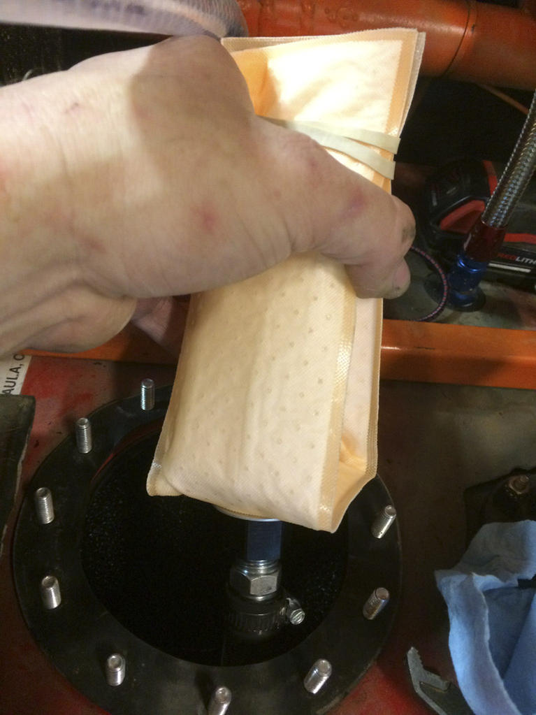

  1. Fix pickup tube in fuel cell (figured out it was pointing up), so order the parts I need to fix it.

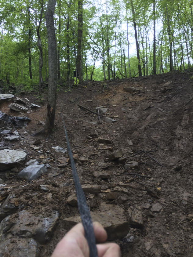

  4. Finish the front part of the cage to strengthen the front stinger and winch mount (bent it winching this weekend, forgot I didn't have it finished. Whoops! :Cry:) This includes the windshield cross bar and down bars. So basically add a few hundred pounds of steel to an already heavy girl!

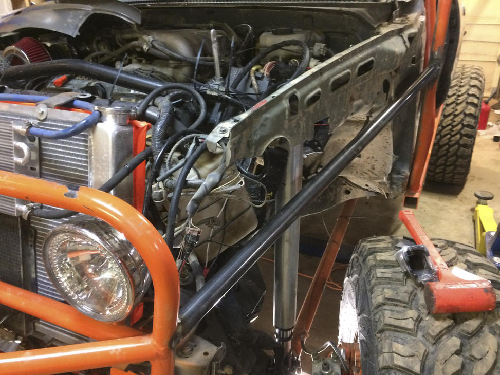

Trail Fest is this week, so I'm busy finishing up some last minute details just for trail fest. I'm nowhere near finished with this rig, but it's at least ready for trail fest. My hope is I will have it perfect by Dixie Run later this year. We'll see.

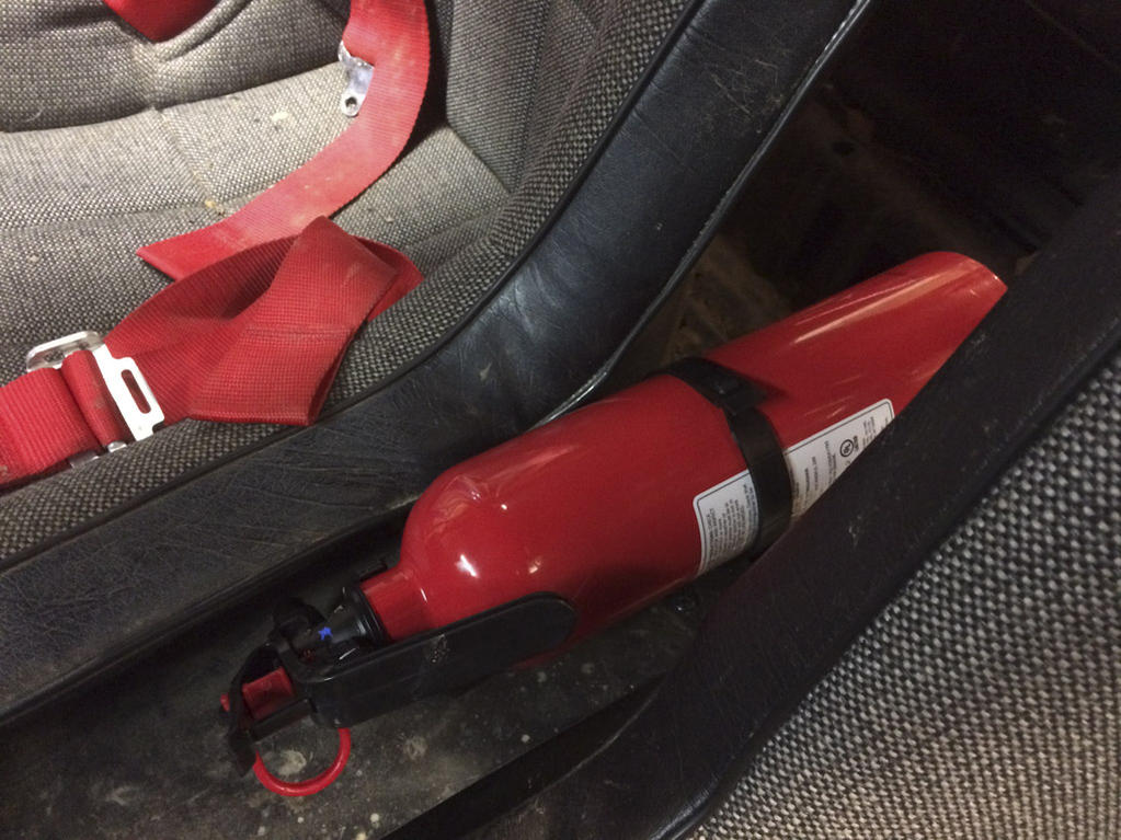

Fire extinguisher installed on the console.
Decided to go ahead and spend the $150 for a small Holley Hyrdomat. Fixed the rest of the fuel issue entirely.
Installing the hydromat (was a pain in the A$$)!

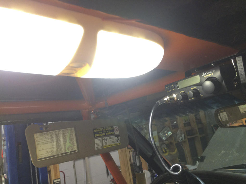

Installed the CB, Antenna, and a bright LED interior light.

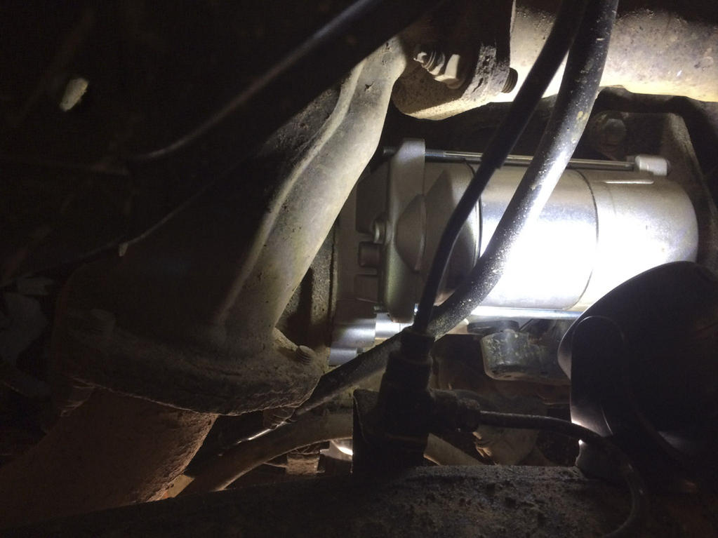

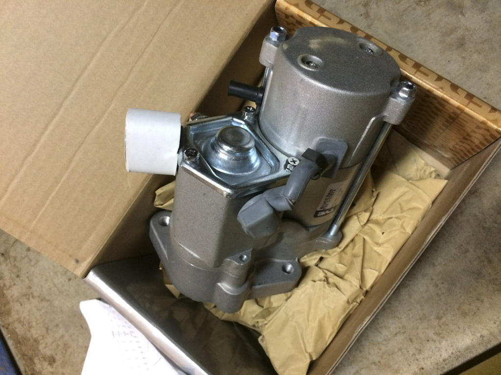

Had to change out the starter too. Was starting to not work every other time you start it. Just swapped it out for a brand new one.
Started on the front tube work too.

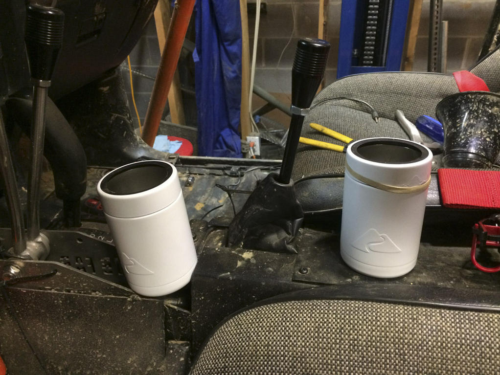

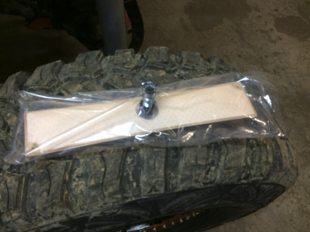

Found these great steel can koozies at WalMart. Tacking them into the console will make great temp cup holders.

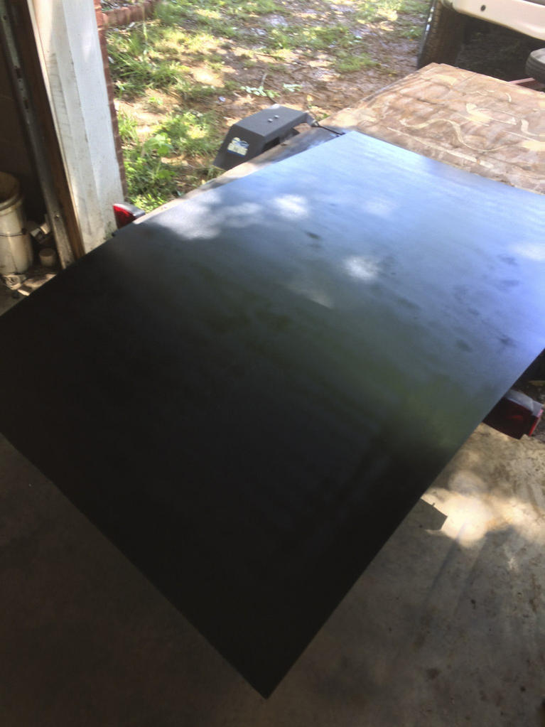

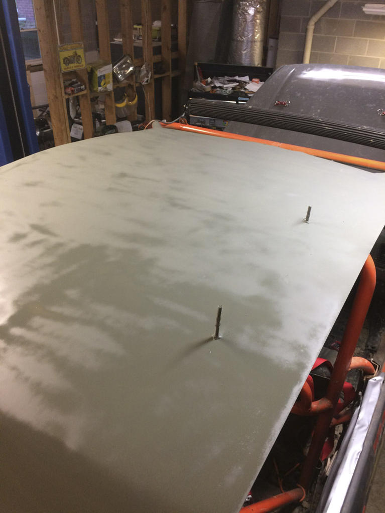

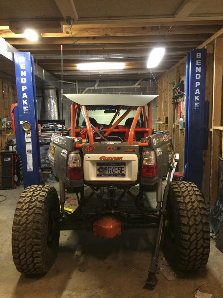

Went and got the roof panel today. 16Ga 4x8 Sheet Steel. Thick for a reason. Cut to size, then I truck bed lined the underside.

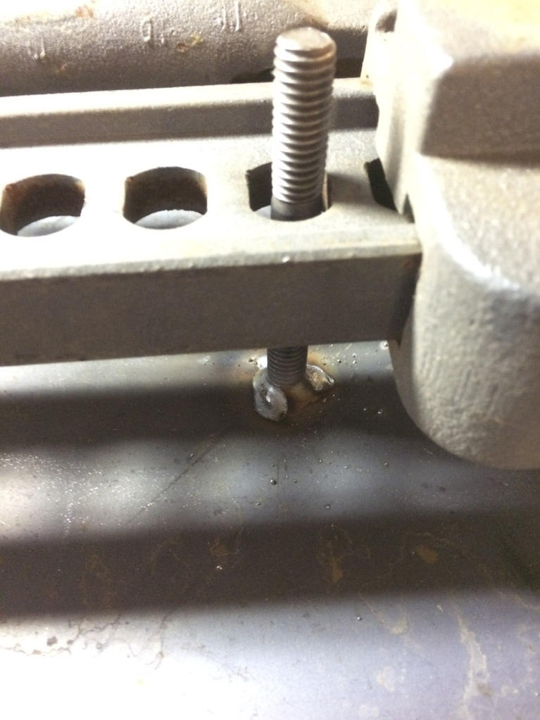

Welded studs to the roof to mount the Hi-Lift Extreme Jack.
How do you cover sharp edges of sheet metal temporarily to keep your kids from cutting themselves on trail fest rides before you get a chance to finish up the bodywork? Duck Tape of course! Gorilla Tape to be exact! Tough as nails!
Roof panel semi installed. Still, needs some massaging to have the right contours, but all the pretty stuff will come later. I just need something to shed the rain for now.

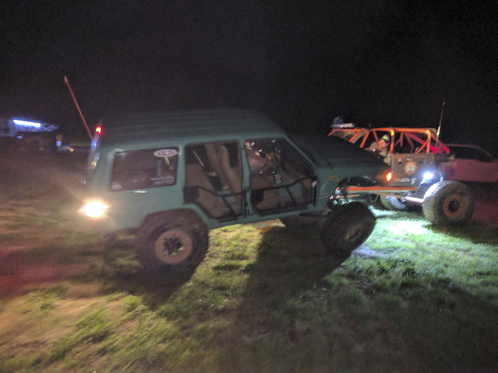

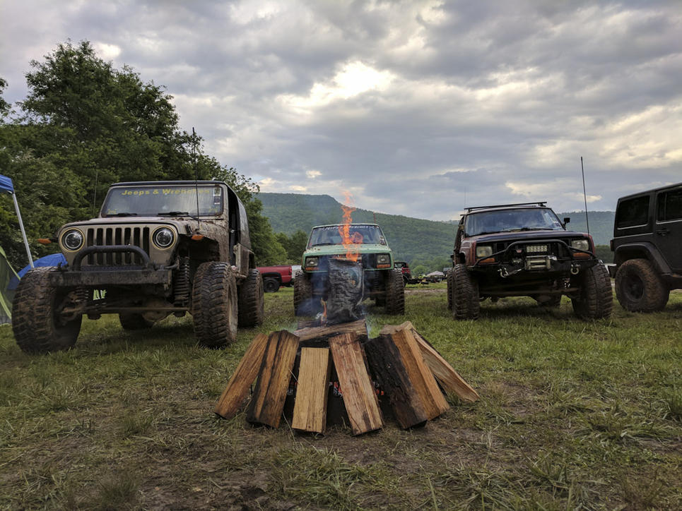

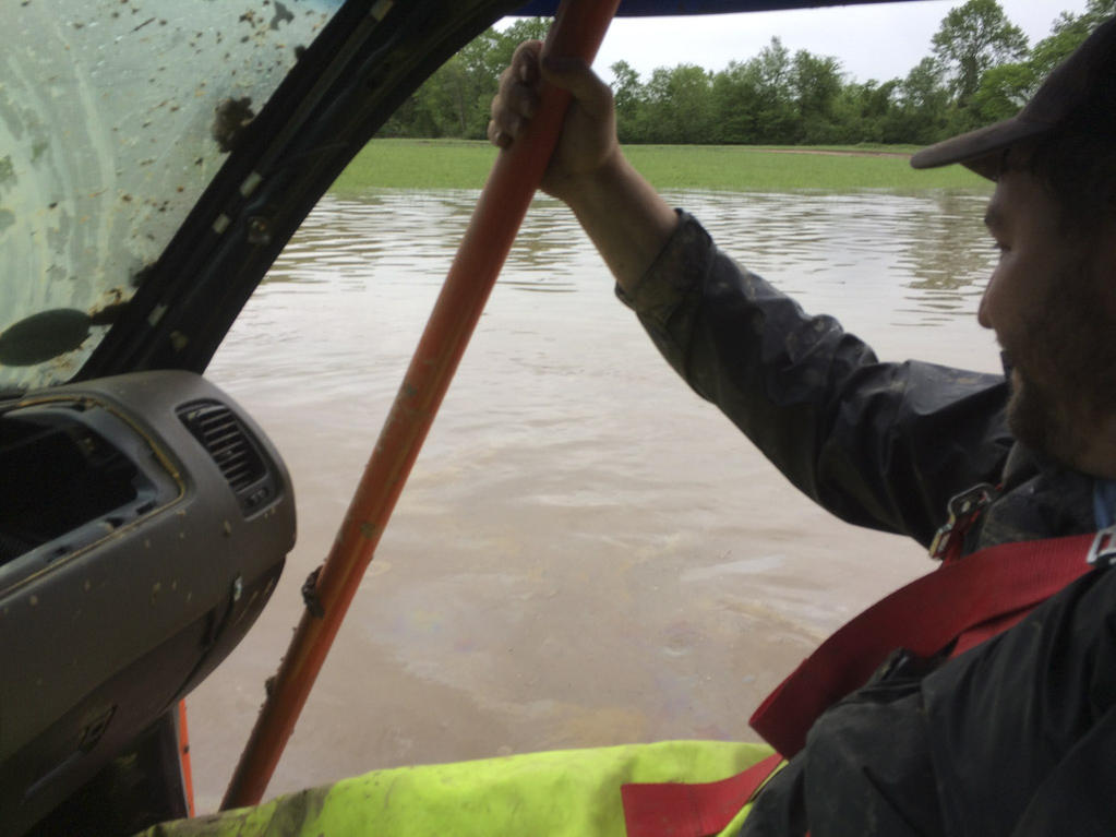

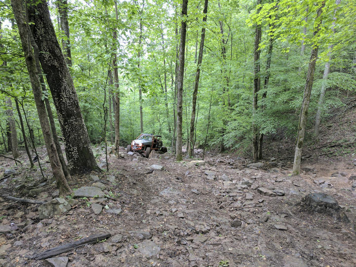

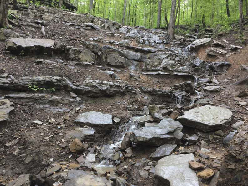

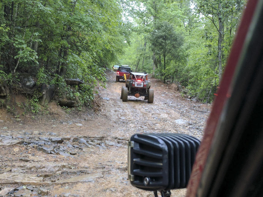

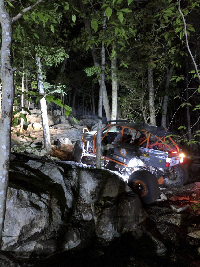

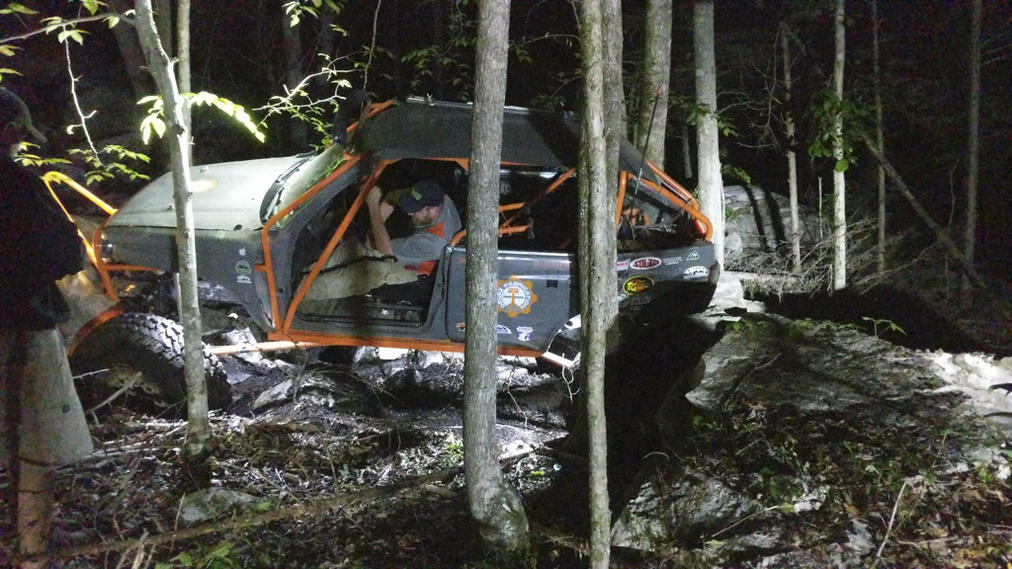

SFWDA Trail-Fest 2017 Synopsis

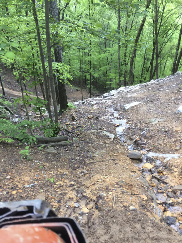

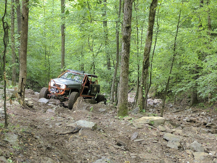

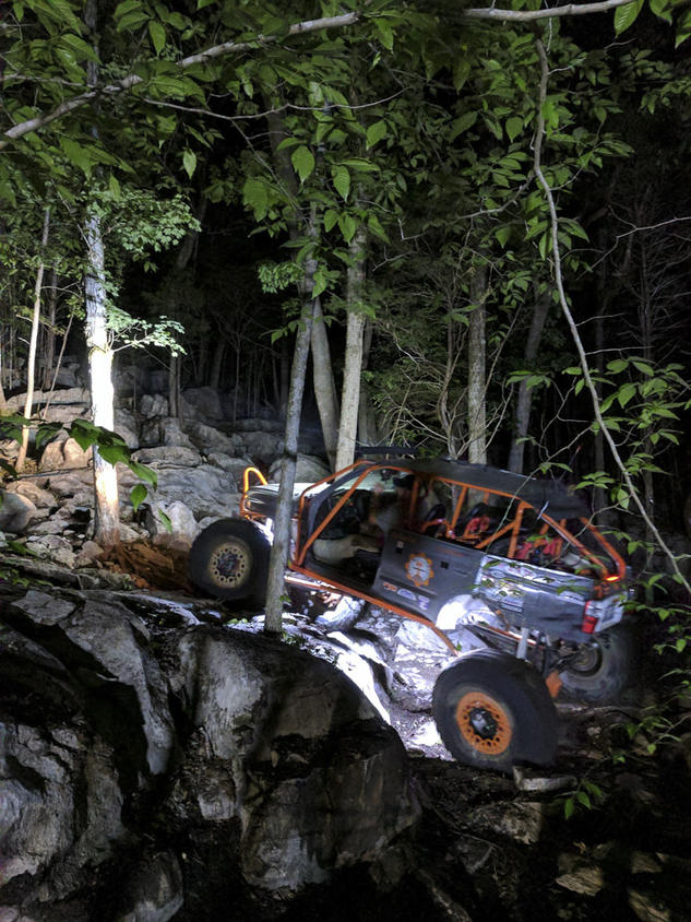

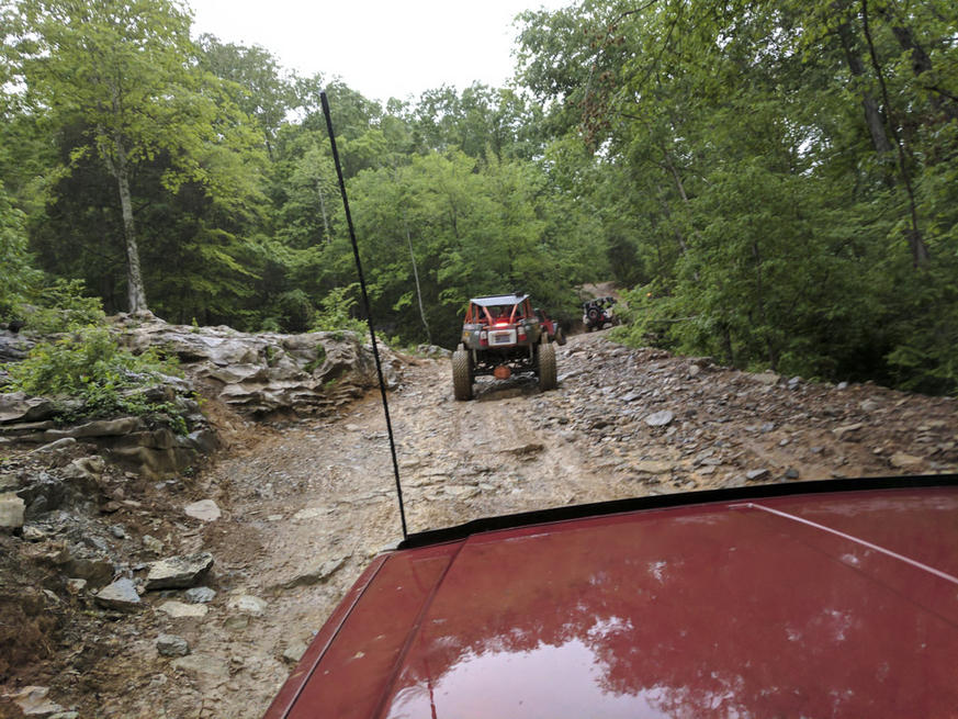

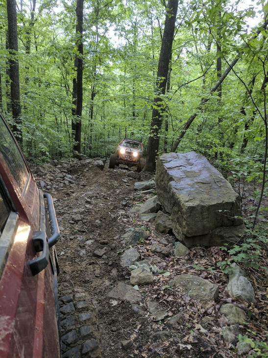

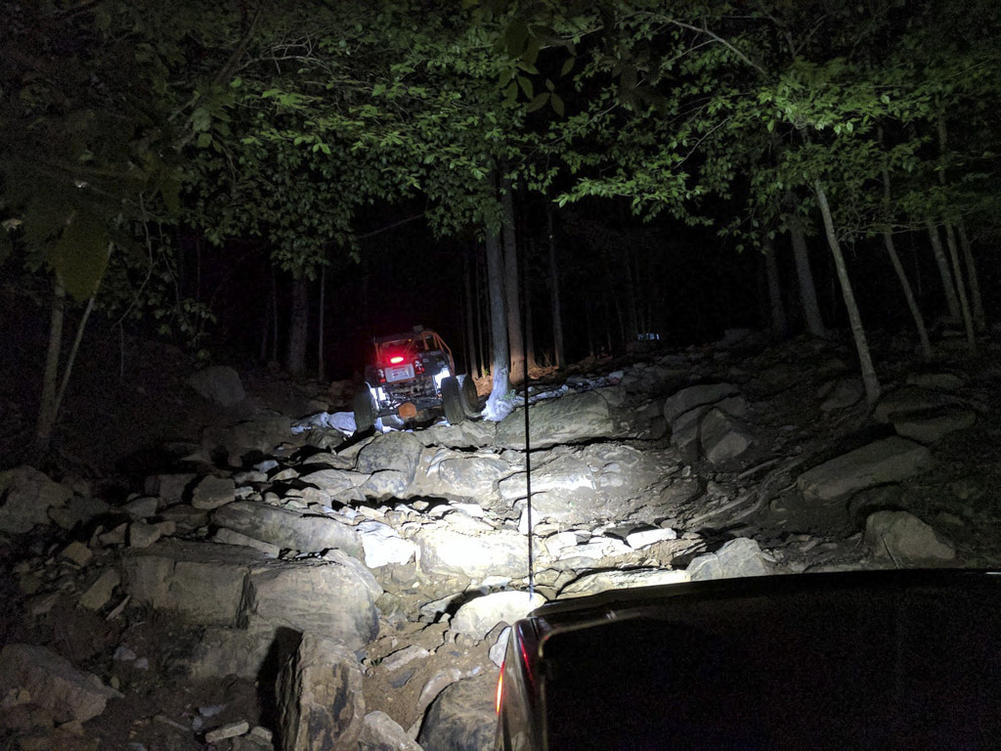

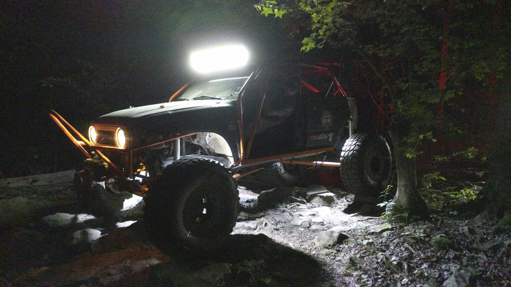

Sooooo, Trail-Fest in a nutshell... It rained nearly the entire time. Trails were sloppy and very slick. Only got to wheel my rig for two days. Only got to wheel with my wife and kids for one night. Didn't get to compete in the hill climb. Fell down on the rocks and in the mud a few times. Got the soreness and bruises to show for it. Didn't get much sleep. Broke both my drive shafts. Broke my front ring & pinion. Wasted several hours building new drive shafts only to then find out it was actually the ring & pinion. Lost my phone on a trail somewhere the last night including all the pictures I took of the last few days that didn't get backed up to cloud (including the ones of my kids having fun) and two days later I am still exhausted and sore.
Translation, it was one of the VERY BEST wheeling experiences thus far! I had an amazing time, got to spend some time with family, ride with some outstanding folks, spend time with good friends, meet new friends, and just spend some down time in nature! Loved every second of it. Even the Toyota Jokes from my Jeep buddies! Can't wait till Dixie Run!

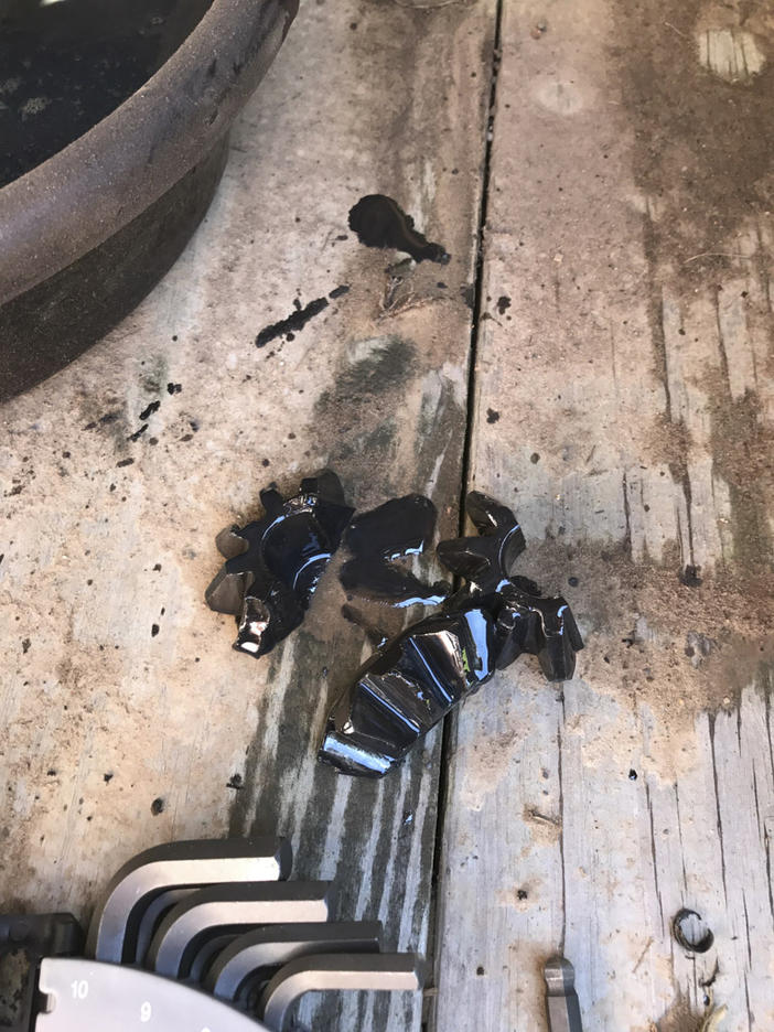

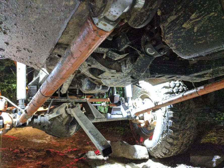

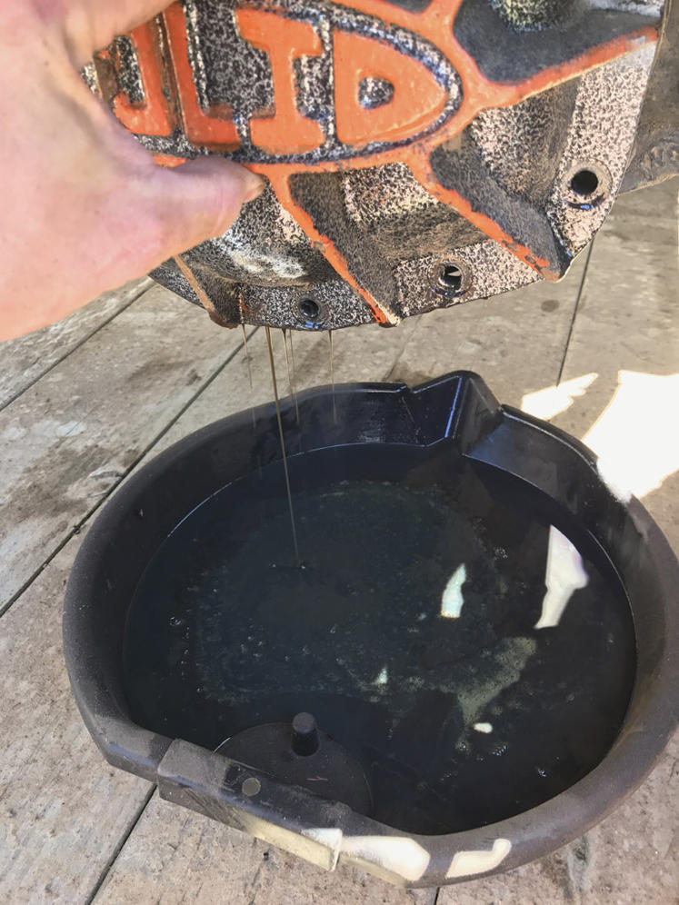

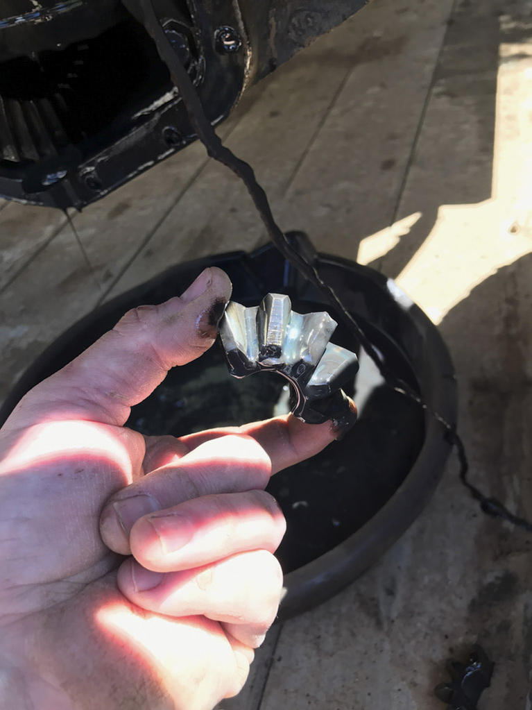

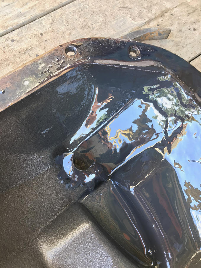

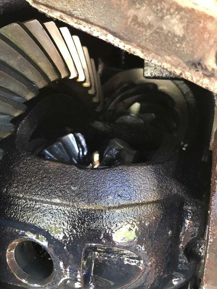

Front Axle Inspection
Good news! I took off the front diff cover this weekend to inspect the damage and there isn't any! The gears and carrier look solid and undamaged. What broke was the welds gave out on the two small spider gears while turning and eventually just broke the smaller gears up and maybe broke the center pin (or it fell out and I just didn't see it fall out.) I pulled the parts out and everything looks great. So, do I full spool it, or put in a Spartan lunchbox locker (one of the strongest and easiest to install). Well, I decided to go with Spartan for a few reasons.
  1. Cost: Spartan = $331, Spool and master kit = $400
  2. Faster install time. Spartan = about 30-60 minutes. Just remove the cover and jacking vehicle up, then install. Spool requires removing the axle, tearing it completely down, and rebuilding it. A full day of work.
  3. Acts as a fuse. The locker will give and not put as much stress on the ring and pinion, or the axle shafts, drive shafts, u-joints, etc.

Your front diff looks like a catastrophe...... you better send the whole vehicle to me.... I'll take this headache off your hands and give myself a new one!:becky:
