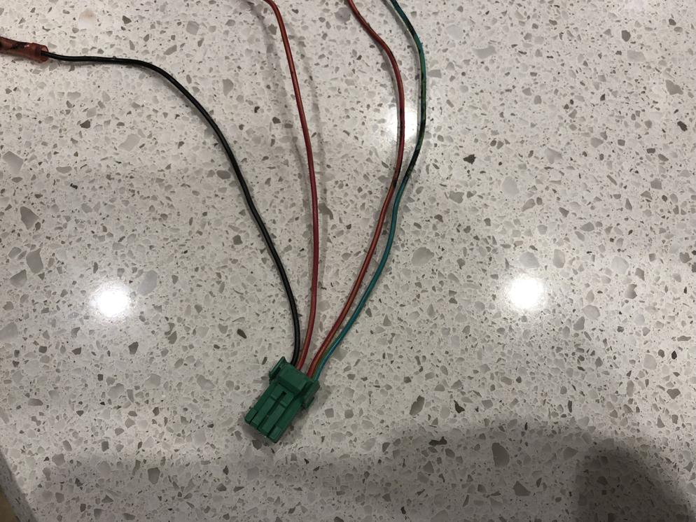

X6S wiring with OEM switch
Anybody know how to wire up the X6S? 25” white/amber combo
Comes with two rocker switches configured as follows:
Red blue black
Red white black
I plan to use two OEM style switches with the following
Black, red/yellow, red/yellow, green
Done it before with a single switch bar with the following
Black to black
Red/yellow (next to black) to fuse tap
Red/yellow (next to green) to blue
Green to white
X6S has four wires - red white blue black
Any help would be appreciated. Switch wire photo for reference.

Hi there,
The blue wire controls the clear and the white wire controls the amber. The original setup with two switches allows you to have just one color on or both on. If you're going into a single switch, you would just connect the blue and white together.

So tried to set it up as follows with no luck-
Switch one
Black to black
Red to fuse tap
Red to white
Green to red
Switch two
Black to black
Red to fuse tap
Red to blue
Green to red
