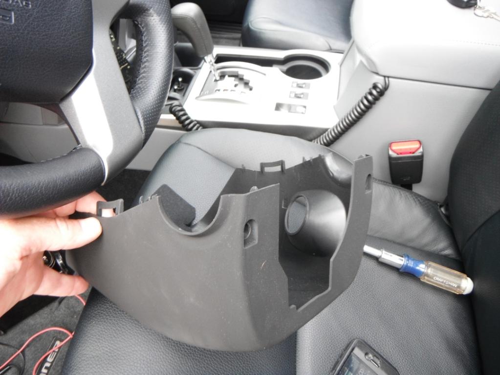

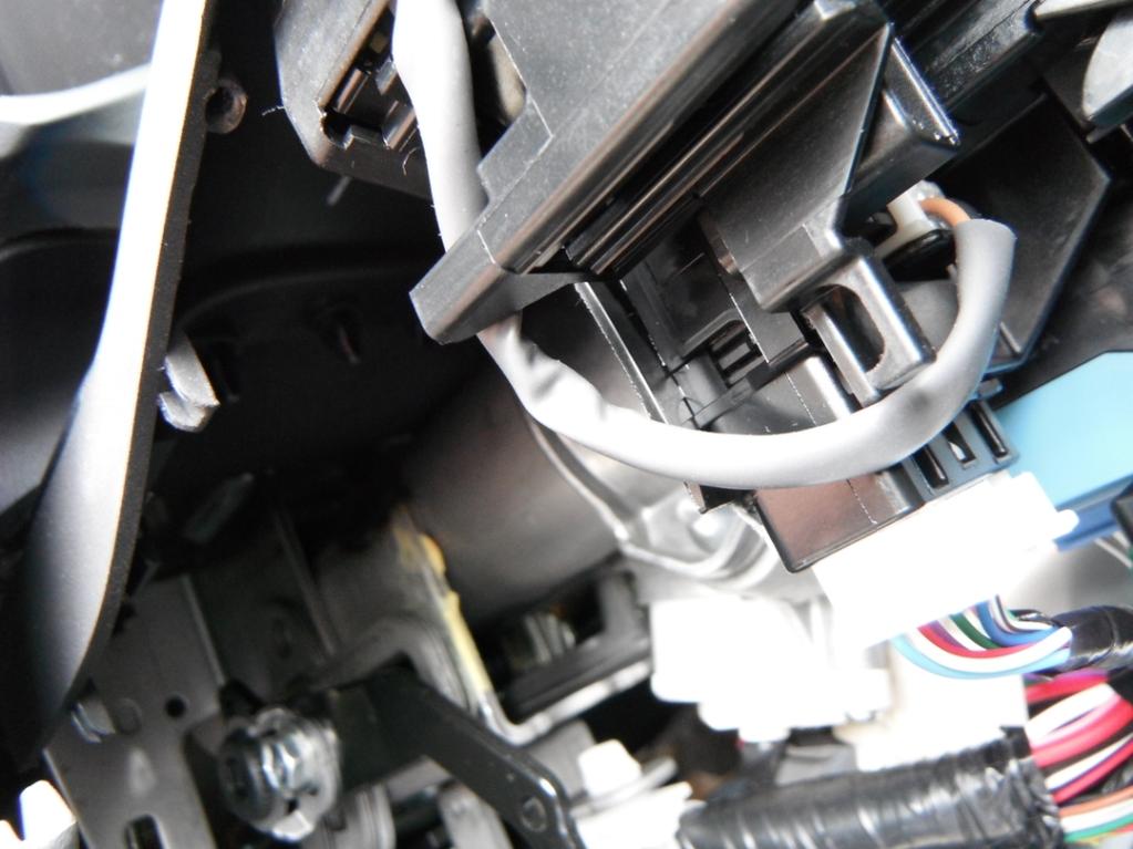

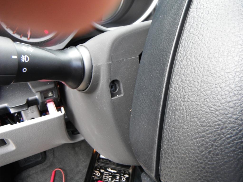

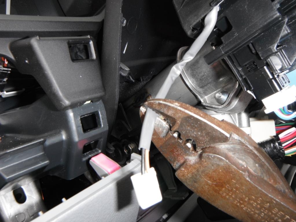

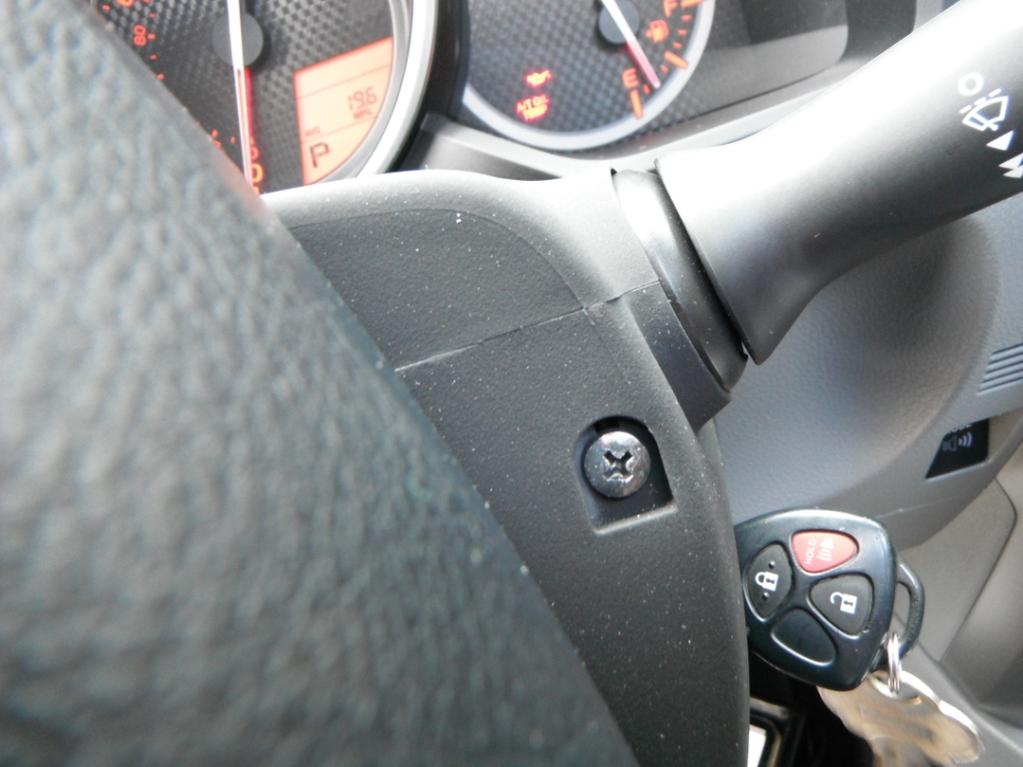

The wires are underneath the steering column. Here are some pics I took that show the wire and how to get to it. I would check here first.
