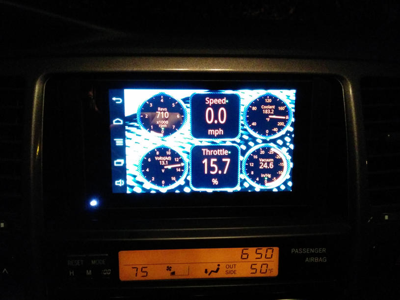

Just got Torque Pro running on my Asteroid. So far I'm loving this head unit. Works perfectly tethered to my Nexus 5.

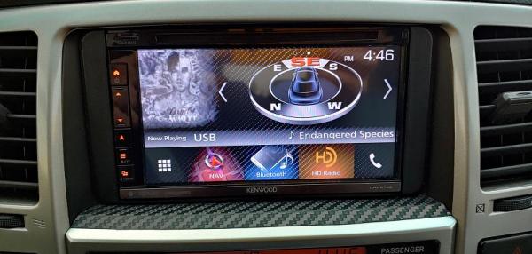

Oh yeah sorry for the confusion. I did replace a JBL H/U, but that is the Metra kit for a JBL and fitment is good.
As Riceandpho said, use the Metra 95-8202 kit if you have an SR5 with the base radio. Use the factory brackets with the kit and it is nice and solid.

Here's mine
Yeah the use of the factory brackets makes it nice.
