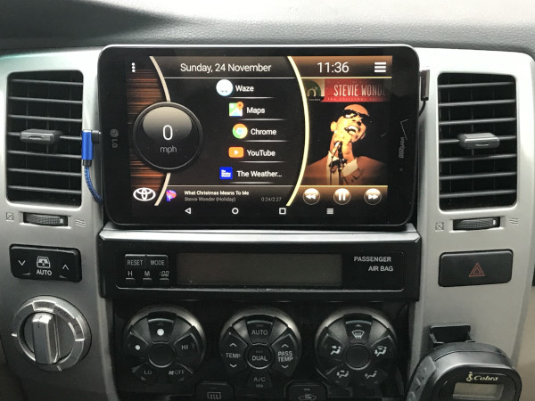

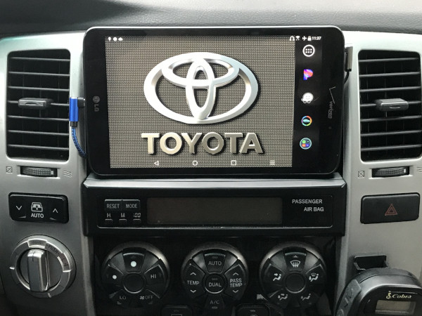

I am well on my way to a new radio myself! I was toying with the idea of the 10.2 inch Android radio on Amazon after doing some testing with tethering to my LG tablet. Ultimately I decided to go with a trusted brand with warranty and customer support from Crutchfield (I am not affiliated with them, used them many times and love their dedication to service!)
Here is what my LG tablet looked like, worked well but was ultimately doomed by WiFi threatening and poor GPS reception:
