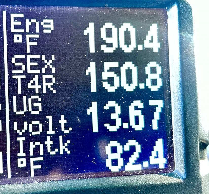

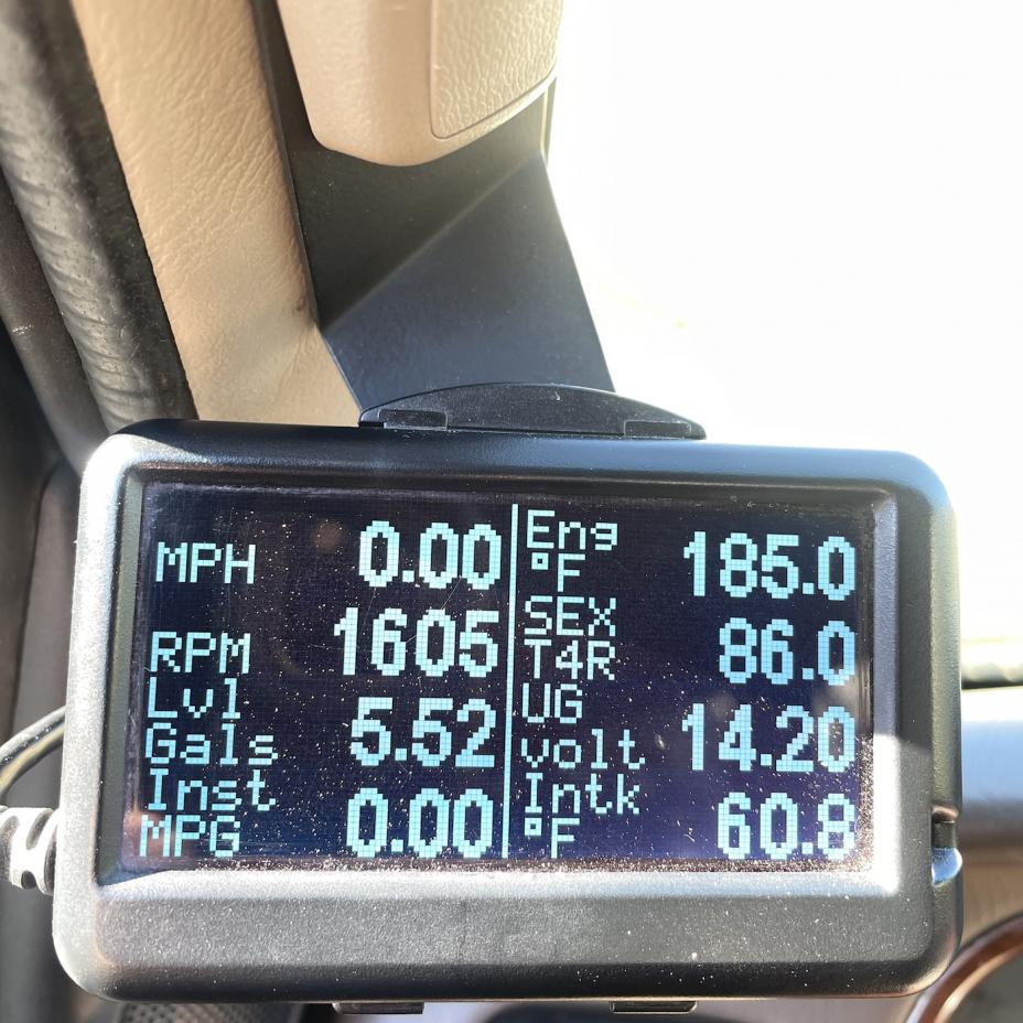

Following this as it will be my turn to make some decisions soon. I was wondering how long it takes people's AT to come to the 'normal' operating temp range (150 - 175)? When my engine temp gets to 185 my AT temp is still a chilly 86. It takes 10 mins of city driving to the the AT to 150. Is this normal?
I am running a Tru-cool (in series) which is supposed to have a thermo-bypass to help warm a cold tranny. Also a Magnefine if it matters.
Wondering if I should return to stock cooling after an AT swap and monitor (if Yota1) or just leave the extra plumbing (if junkyard tranny). I do get to the 210s on extended 4Lo climbs.
Pics:
1. In the parking lot.
2. After some city driving.
Pics:
Your temps are fine. An engine can idle to operating temp, a transmission can't. A transmission needs to be driven to generate heat. Even without an external cooler, it takes a while for the trans to gain heat, especially when the ambient temps are cooler and there's not a heavy load on the trans. Flat freeway driving isn't going to quickly raise the trans temp. If you started climbing hills right out of the gate from a cold start, your trans temp would climb fast.
