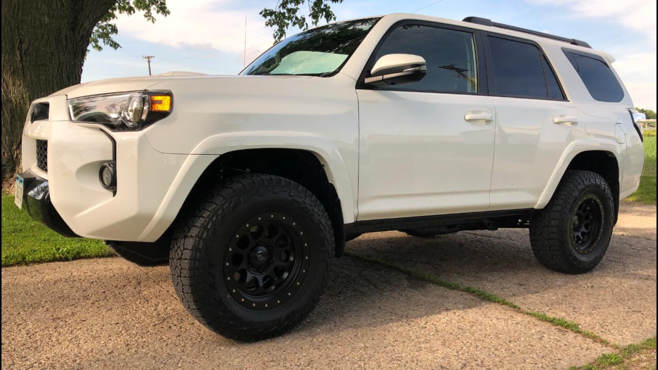

Lifted with Bilstein 6112/5100. I have both front shocks set on the 5th slot and the rears are on eibach 1 inch springs.
The rear was loaded with my old tires.

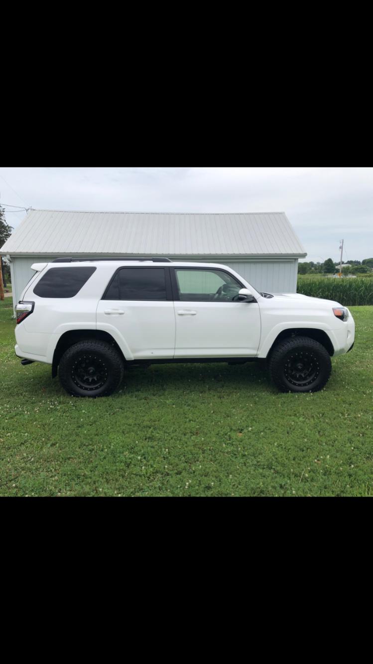

2.5 inch life in the front. 1.5 inch in the rear. They do rub at full turn in reverse when applying throttle.
Where do they rub? Front fender trim, BMC”most likely “if you’ve done all that, should’t be any rubbing. Looks really nice though!
Yeah somewhere in the front fender liner area. It doesn't happen often so I don't really mind. Thank you!
