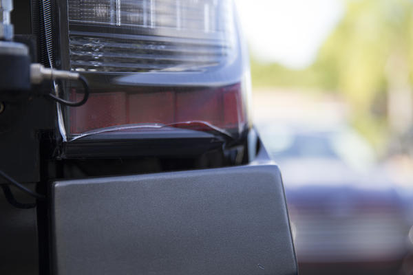

We trashed the rear bumper on this trip but the bumper and fenders have experienced no damage at all and the bumper has yet to hit the fenders once... the flex problem actually cracked our tail light a little but only because we dropped down a massive rock a little to quick and careless and ended up resting the whole weight of the vehicle on the rear bumper for about 1-2 seconds as we slid off causing it to push the bumper ALL the way up and it was a bit too much pressure for the tail light to take... So on production models SSS will be adding additional space around the tail light region to help prevent this going forward. That being said we couldn't take a picture of the impact because it happened so fast lol but here is a pic of the taillight. Aren't you glad we are the test subject?! Haha that is why it is a prototype =)
