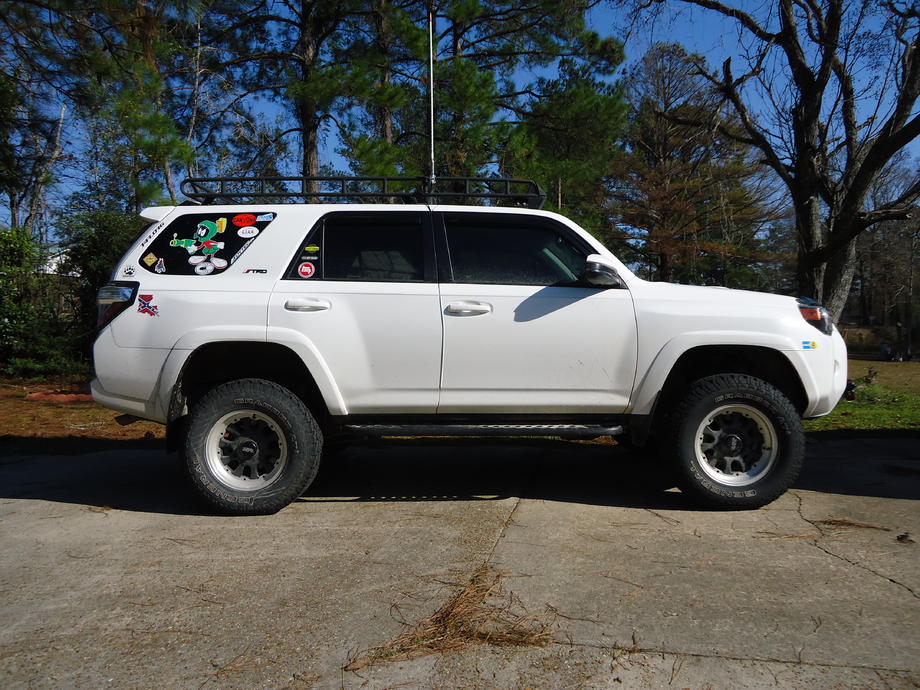

OME 2" 885's on the front (885's to offset a SSS bumper and winch). Bilsteins set at 0. Toytec Superflex rears (+10%), this is pictured with no load but a 90 pound cargo tray in the back. With a few hundred pounds in the back the rear settles an inch or so and the body looks more level.
You've already helped my immensely in my other thread.. but what do you think of people saying that superflex is too stiff?
Now, that you mention that there is at least 90lbs worth of load in the rear, I am starting to wonder again:yield:
Lol. Not too stiff for me. They ride a little stiffer than factory, but if 90 pounds is going to make it ride soft I'm worried about what a real load would do. Wait! I did that in April for 4 weeks and 8100 miles! It rode like a champ! But please note, these are the +10% light springs. Not the heavy duty ones. :p
