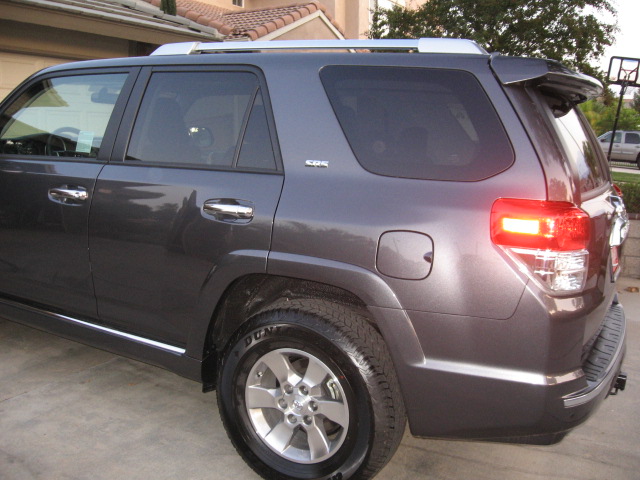

I could not figure out what ya'all were talking about so I grabbed this photo from the picture gallery, it is of jt 4rnr's rig. Do not know if it is a 2010 or 2011. But it clearly shows the plastic piece everyone is talking about. I then went out to my 2010 SR5, no such piece there. Mine never had one.
Interesting replies, thanks. I looked at 2 runners today both with stock running boards and both without that plastic thing-a-majig.....
probably owners have lost them or removed them. Mine has those things, but it doesn't have air dam under the front bumper.
and I have factory installed running boards , Canadian T4R doesn't come without running boards.
