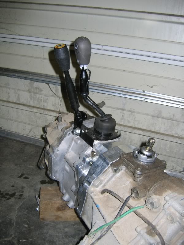

Ok guy I have a few questions. I done a few dual case before but not anything new with chain tcase. My question is in a mult-mode tcase, is it possible to be covert into a twin stick case (2low)? Want to run something similar to a triple stick, reason behind is don't want to cut a hole in floor board. Second reason is wanting to keep mult-mode feature tcase. Plan is to run a gear case in front stock 2.28 or maybe 4.7 not sure what I will decide yet. Please need some hint and answers. Thanks guys

But on a serious note you can get case adapters from a place in Washington (trying to recall the name atm). You normally have to lose REAR heat from the people I've talked to. Now, i'm sure if you spent the time you could keep the rear heat but it may not be worth it, hand them a jacket =)

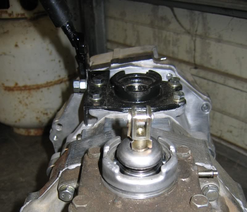

Haha..I was just thinking the same thing. But I also had some shifter idea also. Here some pics of what I found. Twin stick but for the push button rear chain case, so if I do this route I wouldnt.care for the 2wd option anyway
