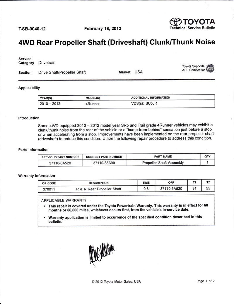

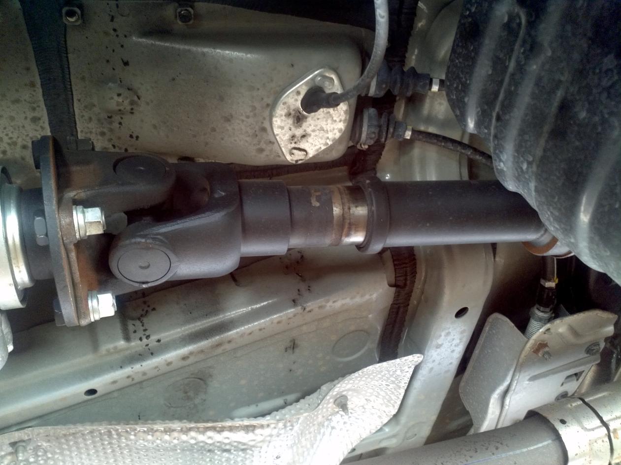

3. I also observed that the drive shaft extrudes out the cylinder like the attached photo. Does this imply I should go to dealer to replace the driving shaft according to TSB- 40-12?

2. I bought a grease gun and did some lubrication when the car was on jack stands. I found it was so hard to remove the grease gun connection from the zerk and I ended up using a square head screw driver and a hummer to chisel it away. I wonder if this is normal especially the grease gun was used for the first time.Normal....Mine are tight too but twisting and a good pull releases it from the zerk fitting. My connector is well broken in though.
3. I also observed that the drive shaft extrudes out the cylinder like the attached photo. Does this imply I should go to dealer to replace the driving shaft according to TSB- 40-12? It's telescoping and comes from the factory like that . S.B. doesn't apply unless your getting stiction there and getting the famous thunk and feels like somebody tapped you from the rear when stopping. Greasing regularly usually prevents it and my 4runners have never had it in 8 yrs greasing regularly now.

The photo of the driveshaft looks just like a normal slip joint. The TSB for the driveshaft, which I just had done, was to get rid of the "I just got rear ended" feeling while at a stop. They call it a thump. I couldn't reproduce it in the test drive with the tech but they did it with no questions. Now the thump is gone and I got a shinny new driveshaft while the rest of the undercarriage is covered in mud.

3. you lifted your 4R, the distance from the back of your transfer case to the axle is now greater. that is why the driveshaft is stretched out a little bit. how would this be a TSB issue? it doesn't look too bad, just keep it lubed.
