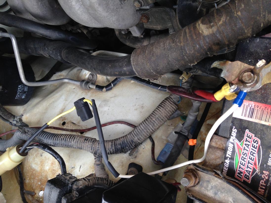

I did the same set up KidV did with the Bronco relay, with the only difference that i added a wire from the battery negative post to the relay and also i still have to add a fuse close to the battery positive post to avoid any accidents from happening. I'll take pics. tomorrow and thank you again, you guys rock.

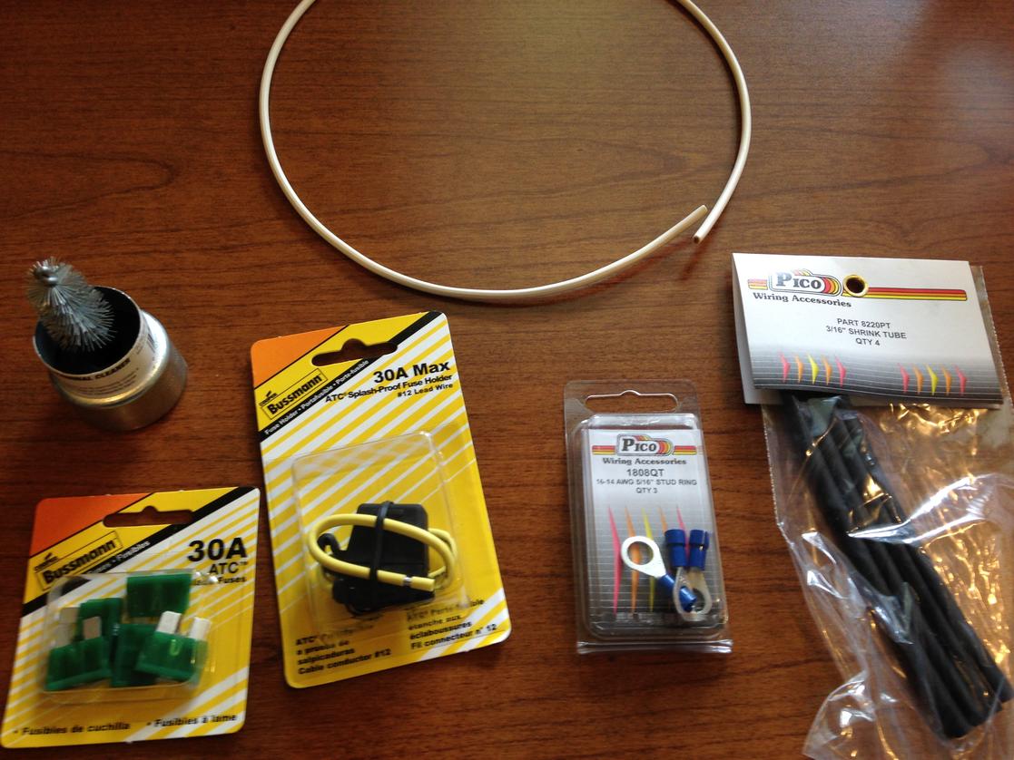

So I bought the hot shot kit. Once I got it open, and started poking around under the hood, it got a little tricky. It's designed for vehicles which have solenoids with posts, not spades.
So rather than mess with that, the path of least resistance was to go with RAD4Runner's solution.
About $10 in parts at the auto store, and simple install.
Just gotta know which wire to cut!!
So far so good. Obviously time will tell. But this fix makes a lot of sense.
THANK YOU!

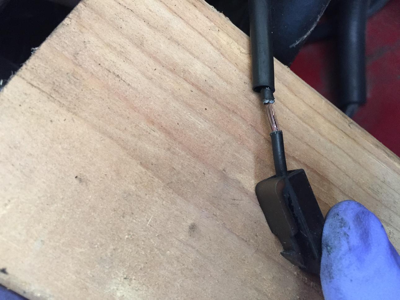

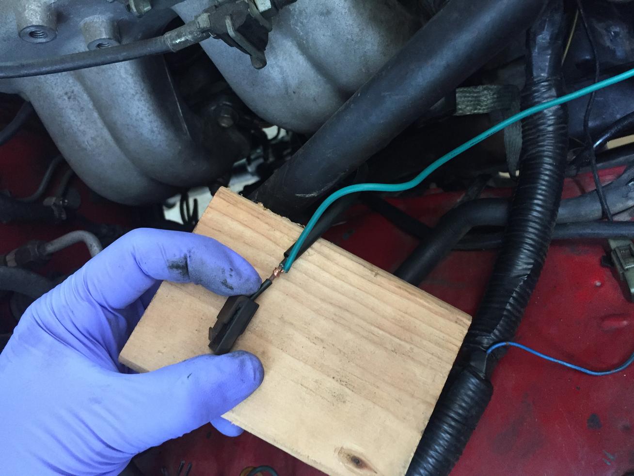

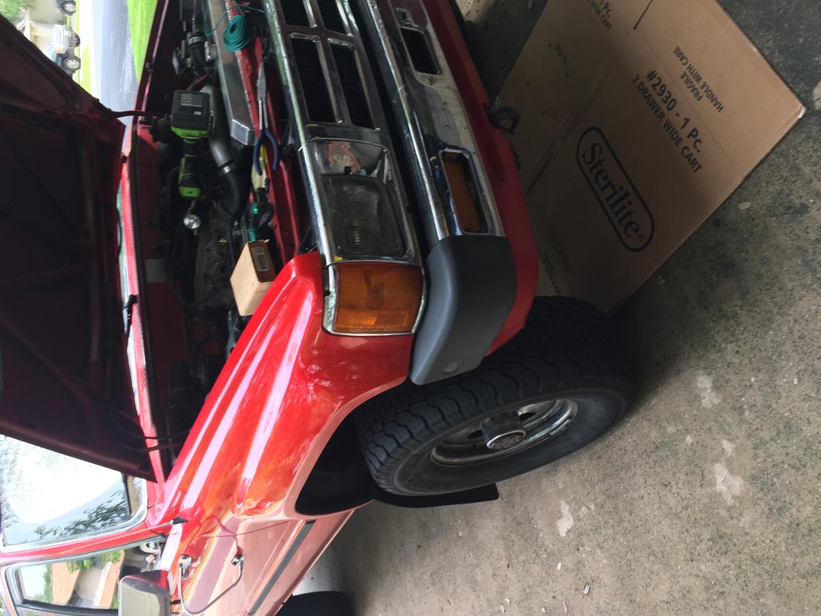

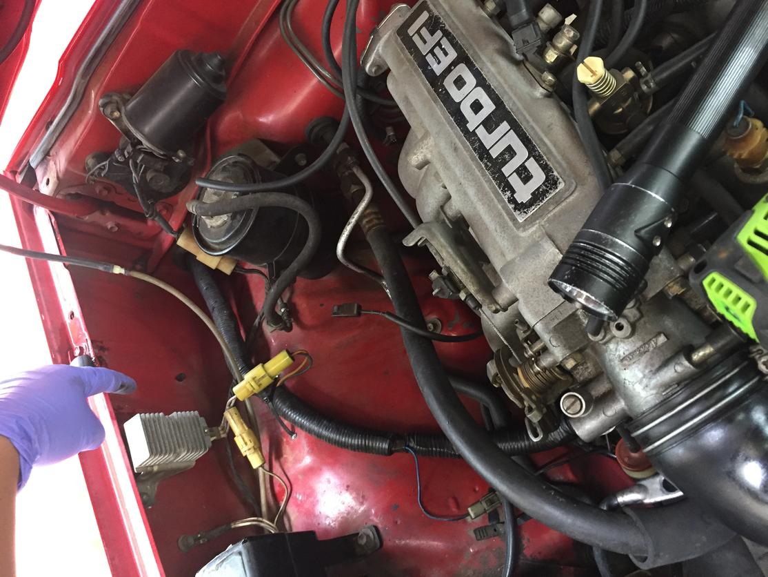

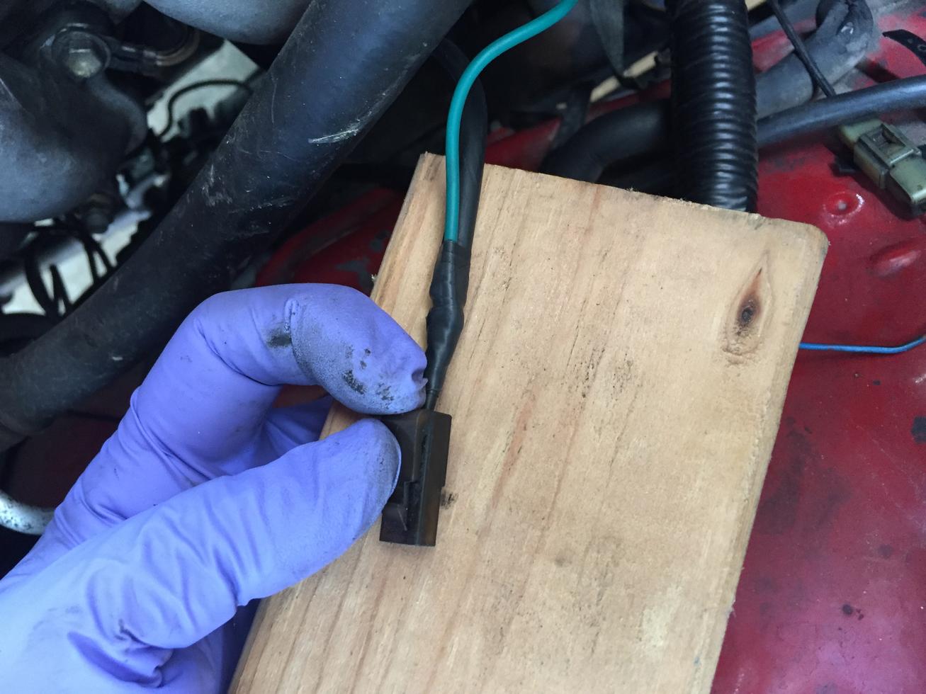

Here is a pic of the supplies,
pic of the cut wire on relay (diagonal from red and black)
pic of semi finished install before heat shrunk and tie down.

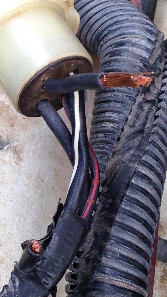

Dude, You guys are my best friends.. had to tow our 1985 Pickup home the other day due to “click, no start syndrome” tried knocking on starter... cleaned afm, etc with negative results.
Luckily I stumbled on this forum feed and how to. Like KidV, I bypass the starter solenoid to the battery with the key in “ON” position and started to crank and turn on immediately.
I will have to use this setup temporarily and get the relay and parts later for a more permanent fix.. but again thank you! At least I didn’t get a new battery, starter etc.
