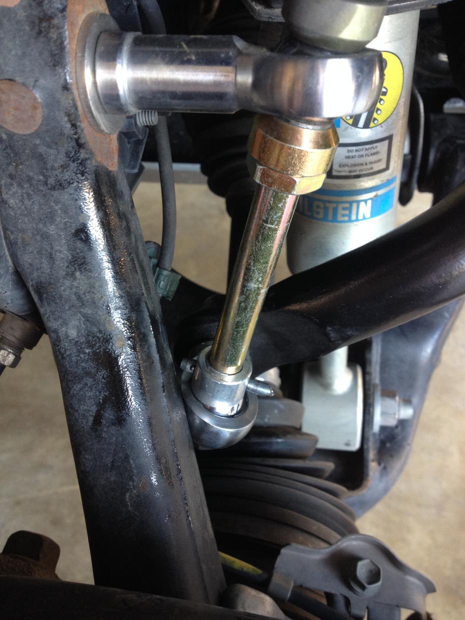

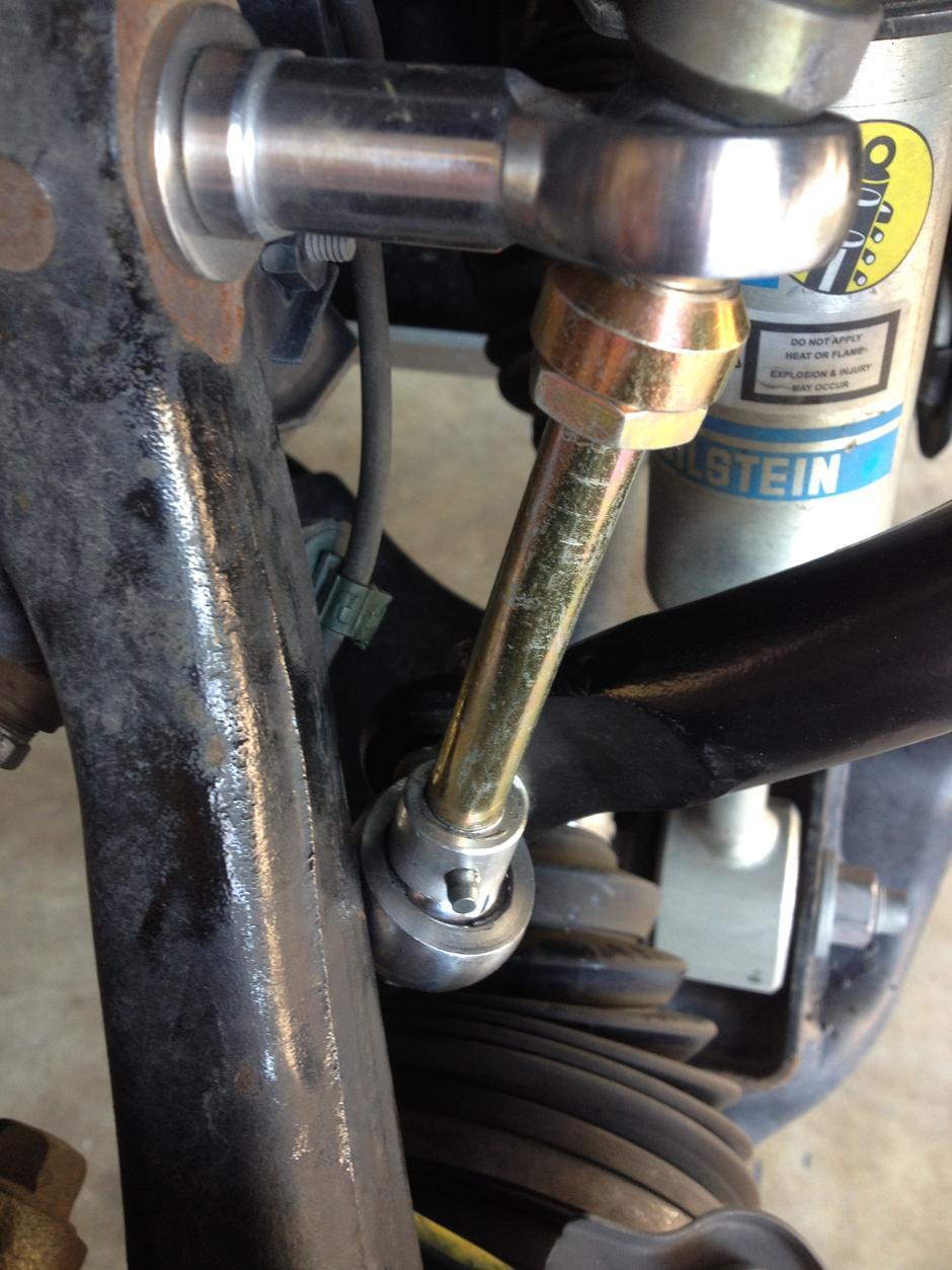

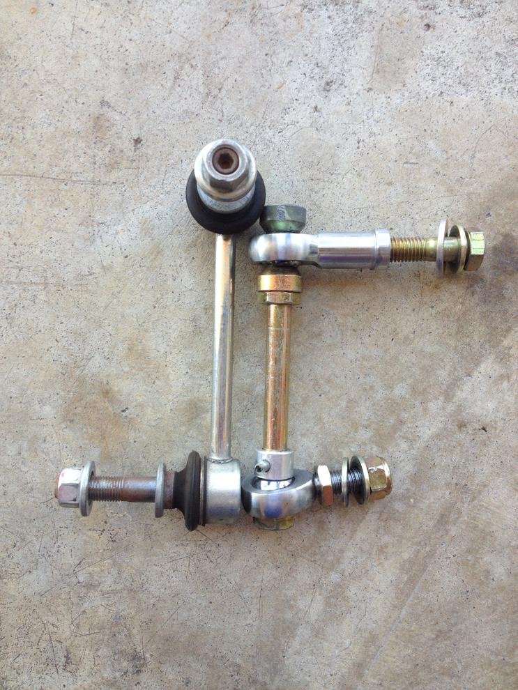

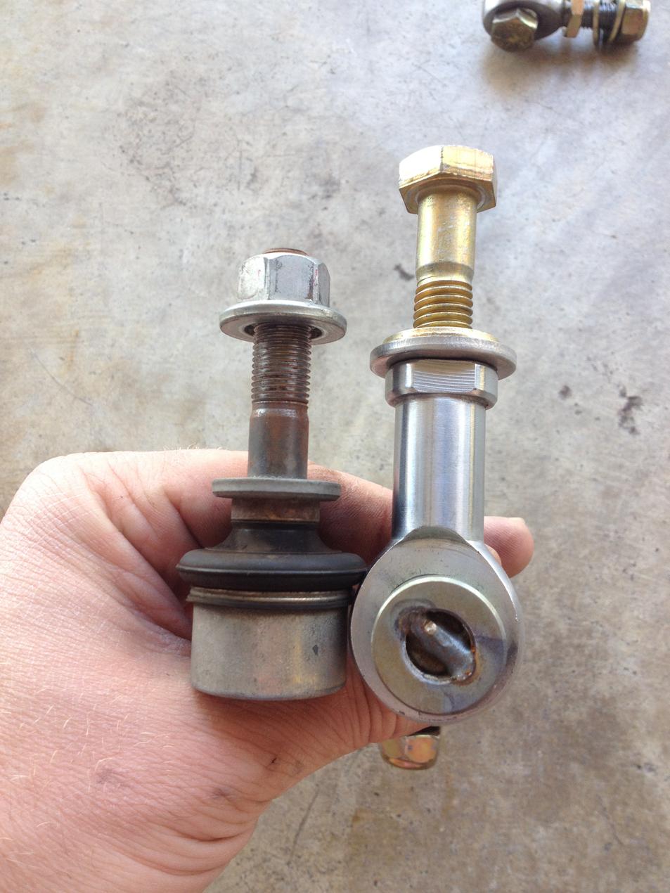

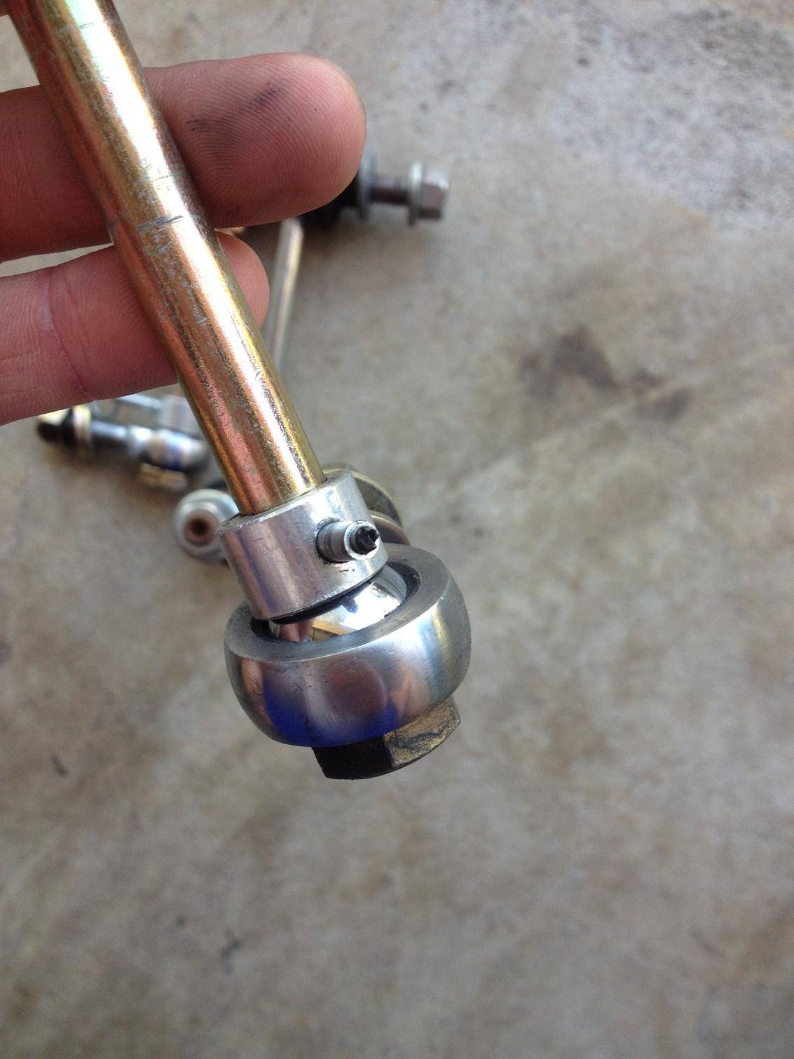

[MENTION=98153]MStudt[/MENTION] i have a couple of design questions and then an issue i encountered after install (i installed the front/rear disconnects last weekend and just finished uninstalling them for the time being):
the 1st and 2nd pics are comparing the stock to the disconnect links. 1st pic: from the center of the joints the stock links are significantly longer than the disconnects. 2nd pic: the upper joint, between the joint and the mounting surface, on the disconnect links is significantly longer than the stock upper joint.
Is there a reason they are not closer in dimension to the stock joints? it seems to put added stress on them, and the install/uninstall process is much tighter tolerance wise due to this compared to the stock joints which are very easy to take off and put on.
the 3rd pic shows were after a few days of connected driving the pin broke at the circlip. the pin broke by rotating into the sway bar while driving with it connected. when stress is taken off one side the shaft itself is free to rotate and the pin is too long to do this without contacting the sway bar (hence the uninstall). pics 4 and five show the direction the pin was facing when installed (forward) and pic 5 shows thee direction it rotated. you can also see in pics 4 and 5 where the upper joint sits much further away from the spindle/knucle than the stock joints.
i uninstalled the rears as well for now, although the only real obstacle with those was a light knocking i was hearing, but did not have time to diagnose today.
i did notice the front disconnect pins are different than the ones pictured on the FJ in the original post, had these particular pins been field tested yet?
i really want to make these work, but need help understanding why they are sized so differently than the easy to fit stock ones and get this disconnect pin situation addressed. thanks
Is your sway bar relocated? I've never seem these sitting so close to the spindle before. These pins have been tested, and hold up better than the old pins do. But you are the first person to break one of these pins which are about 35% stronger than the last ones.
These are the dimensions that were tested, and worked. I can make them longer if people feel the need is there. We tried some that were about 20mm longer, and felt they were getting a bit close to the cv itself. So we decided to drop them back a bit.
Another option to try would be removing the jam nut on the lower heim. The will allow you to pull the heim closer to the sway bar, and that would give you enough clearance between the link and the spindle.

these pictures are with the front on stands, suspension hanging. i totally understand the issue of the link shaft dropping too low and contacting the CV or tearing the boot, that makes sense, thanks for the explanation. the fit was tighter but manageable.
i did actually remove the lower jam nut to gain some extra clearance during the install.
the pin didn't shear just from stress of torsion, but was bent by the sway bar itself while driving. i should have taken a pic of the intact passenger side pin to show how its able to rotate into the sway bar and get guillotined at the circlip/weak spot.
I could tell it didn't shear so that wasn't a concern. By removing the jam nut, and getting it closed to the sway bar you should be fine. That was the one change that I did make was adding the jam nut, and washer. That being said I can see how that would have pushed the heim closer to the spindle.
