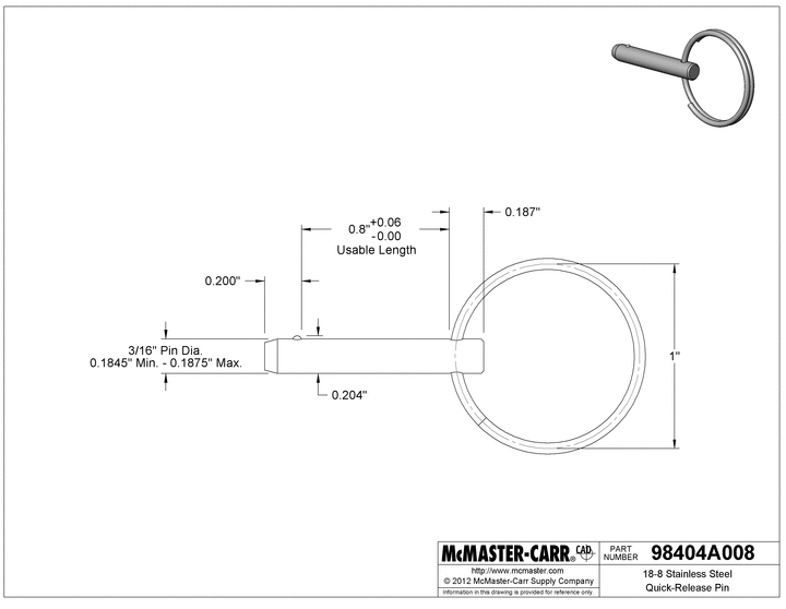

Here's a link to the pins. The pins only need to be a hair over 3/4", and these come in at .8". So those should do the trick.

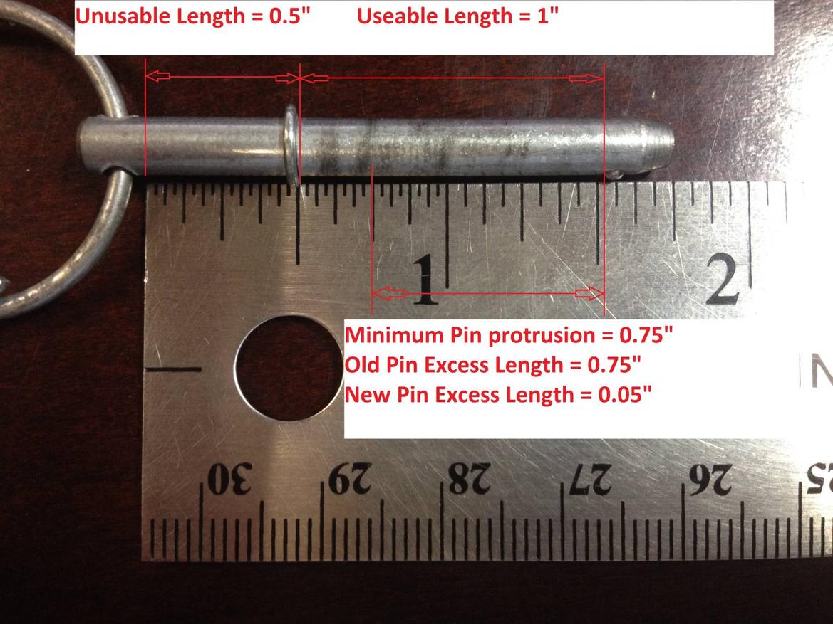

i took measurements of the old pins to compare to the measurements of the new pins. (comparison pics attached)
with a minimum pin protrusion of 0.75" to securely fit thru the link shaft and collar this means the overall reduction in potential excess length is the old pins unusable length + the difference in excess usable length = 0.50" + (0.25"-0.05") = 0.70"
so while the usable length is 1/4" shorter for the new pins the overall reduction to pin length is nearly 3/4". i believe this will be a sufficient enuff reduction to eliminate the sway bar contact.
it's early, someone check my math to make sure i'm seeing this right. (didn't factor in the extra length where the pull-ring passes thru the pin because they cancel each other out.
You're going to reduce the length by almost 3/4" due to not having the collar on the pin. I have some coming in today. Shoot me a PM, and I can get 2 out.
