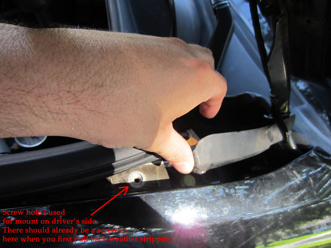

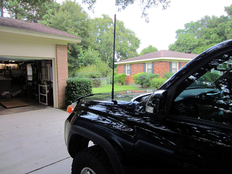

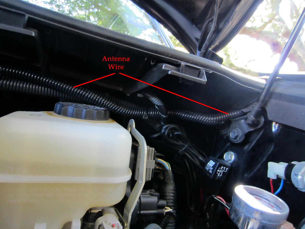

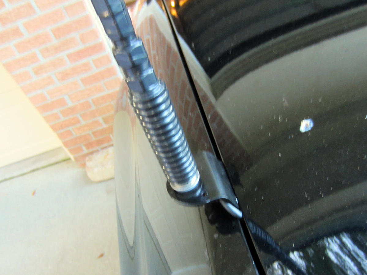

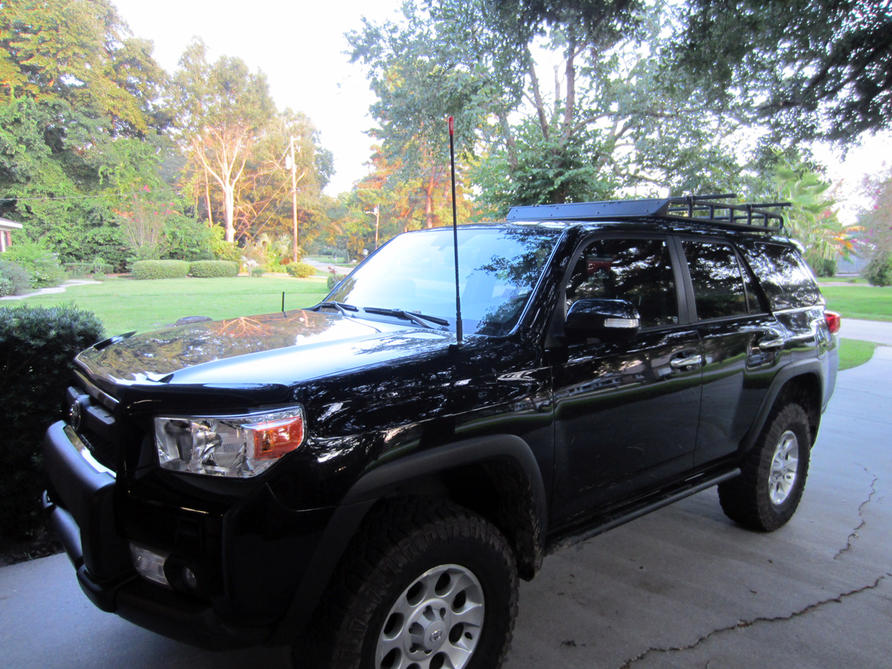

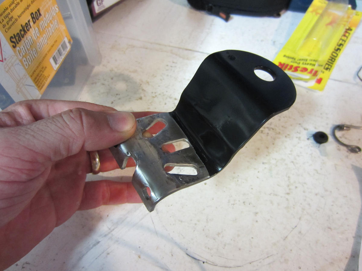

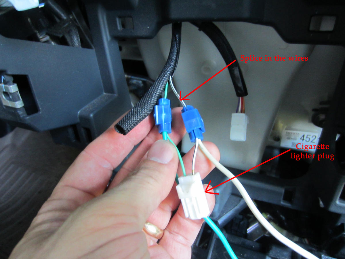

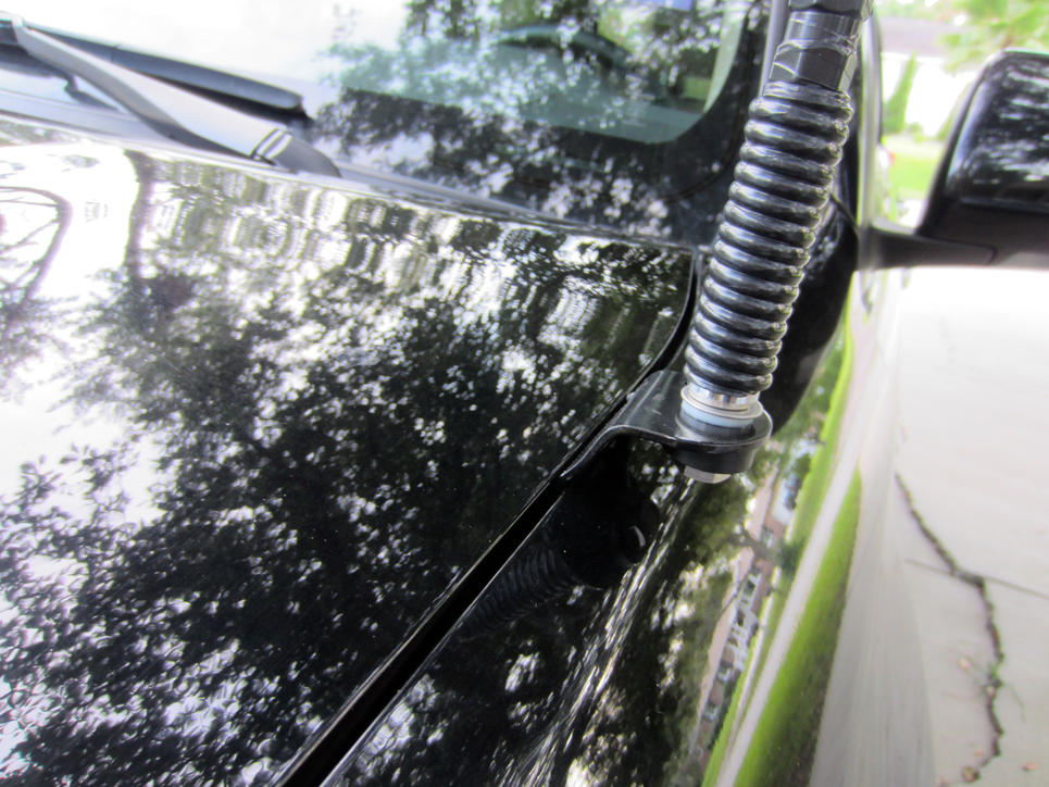

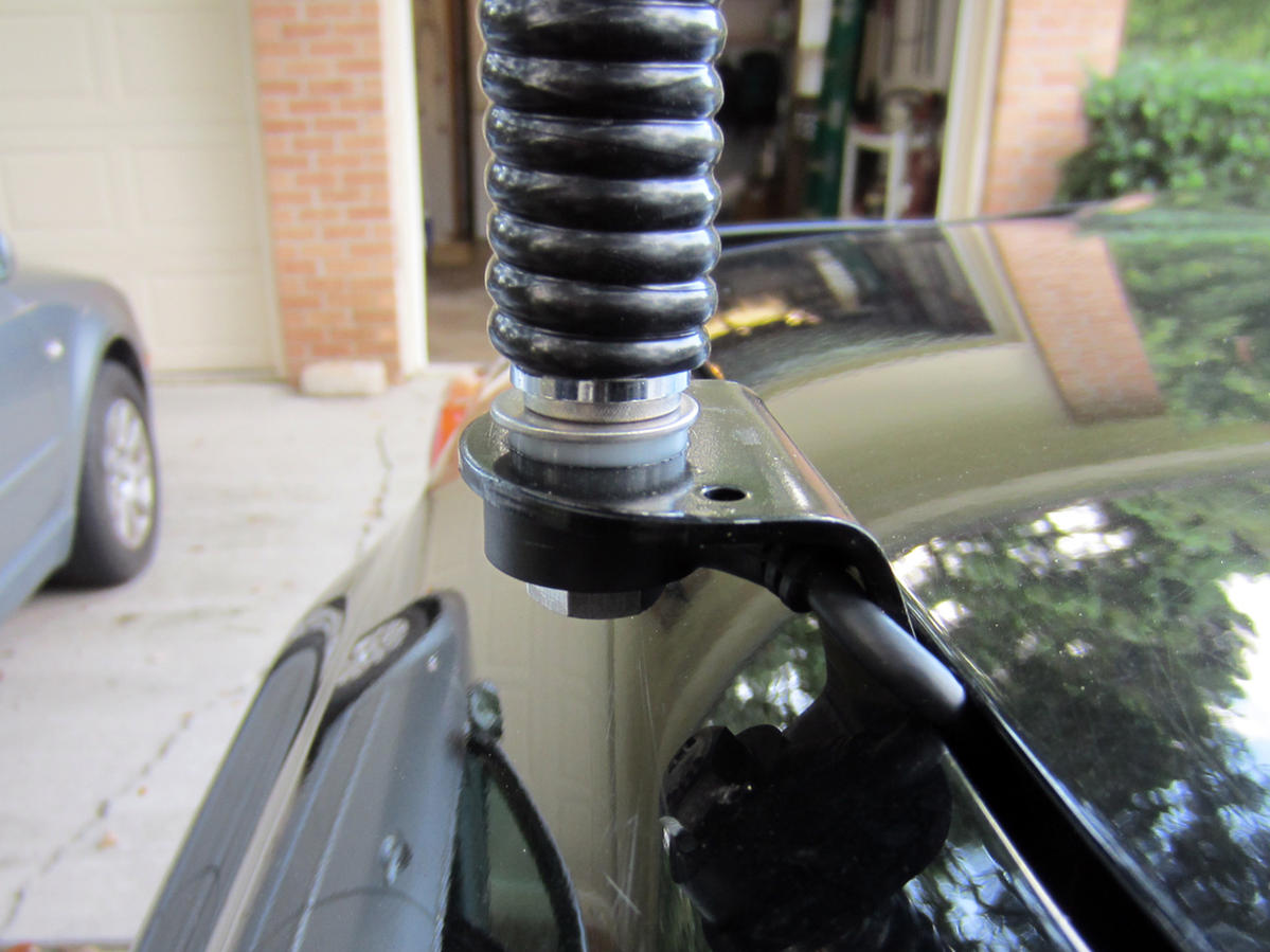

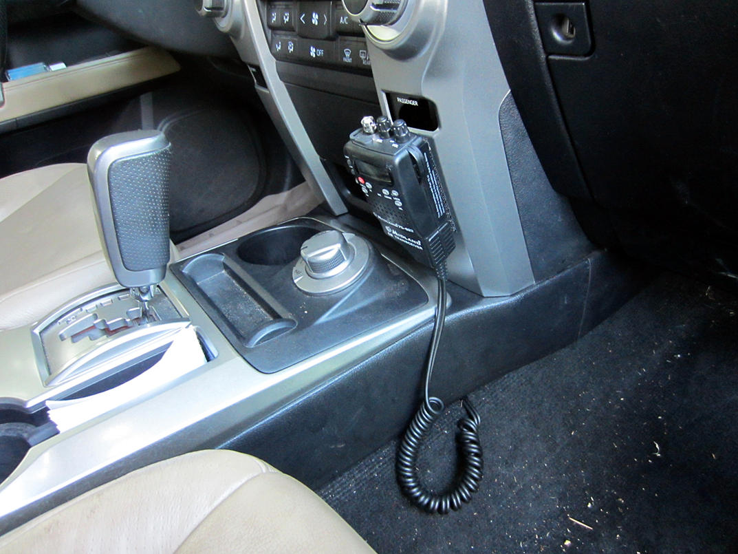

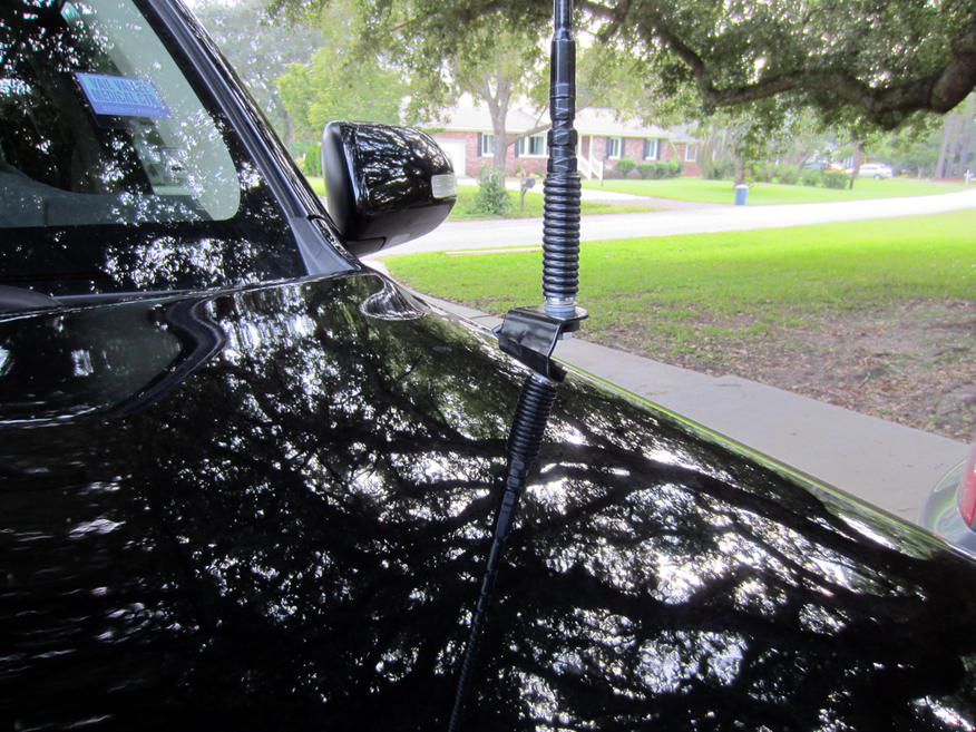

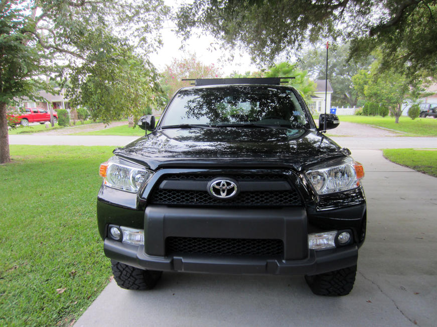

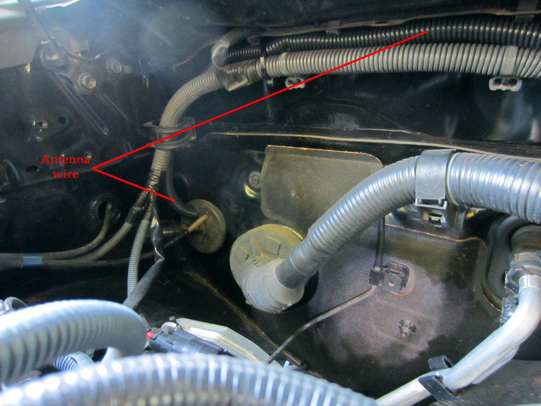

Installed Firestik 2' CB antenna using the Firestik hood-seam-mounted bracket. I had to bend it a lot to get it to be how it is here. It is extremely high quality solid aluminum, and I had a heck of a time bending it how I needed it. This will not work without bending it as far as I can tell. I like this mod because I can easily remove the mount if I want, and also it's easy to replace the 2' antenna with a 4' one in the event that I want to do that. Because I'm lazy, I just jumped the wires off of the back of the cigarette lighter plug, and stuffed the connectors to the Midland up inside the side of the console. On the antenna spring, I just taped it up with electrical tape, because I couldn't' figure out how to paint something like that. I did paint the antenna mount parts that would be visible. I have ordered a black tip to replace the red one, FYI. This setup results in the antenna being about and inch or two higher than the Baja rack and it barely fits in my garage, but does. It would be cool is somebody on here fabbed up a similar mount to this and sold them, but I don't have the skills!
